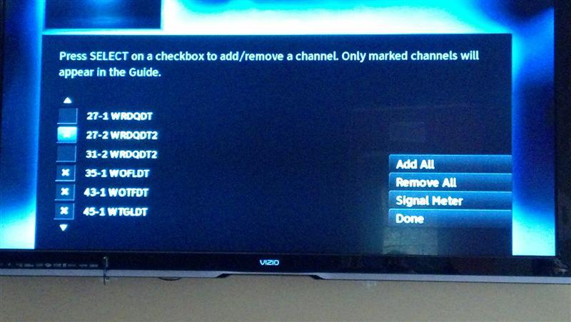

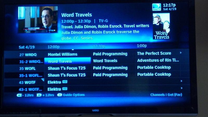

I've been trying to figure this out for a couple of months and have done everything I can think of. I've read a lot here too but I need some help please.
I had a HR34 genie for a couple years but recently got DTV to upgrade it to the HR44 genie. Also have 3 mini receivers. I purchased the AM21n off of Amazon and had it hooked to the HR34 and after some trying, I got all the OTA channels I wanted.
However, ever since I hooked it to the new HR44 I'm having some strange problems, as follows...
Specifically, the only channel I'm having the problem with is 27.2 which is WRDQ-DT2 "Antenna TV" from Orlando. (I'm just outside Orlando and get all Orlando channels)
The strange thing is, it shows in the "edit off air channels" but I can't get it to show in the guide. Also, the signal strength for 27.2 is decent at 50 to 60 and I can get it stronger by raising my outdoor antenna. I can view it perfectly directly through my TV's tuner.
And, for some reason, channel 31.2 shows in the guide as WRDQ-DT2 and has the correct program info displayed but is actually a spanish channel and NOT Antenna TV. And, I can't get 31-2 out of the guide !

what looks weird is this
Directv database shows 27-1 & 27-2 only
Rabbitears shows 27-1 as Independent, 27-2 as Antenna TV and 31-2 (RF27-3) as Telemundo simulcast (there is a low powered 31-1 as the main Telemundo)

The way the AM21 works it will pickup both stations because they are broadcast on the same RF frequency. IF the signal is stronger on 31.2 over 27.2 it will show that station and not the other one even though they both show up in your " edit channels" because they are broadcast on the same RF, but with different channels numbers assigned.
stronger signal doesnt mean anything. Look closely at rabbitears
RF27-2 is what maps as 27-2 AntennaTV
RF27-3 is what maps as 31-2 Telemundo
They are different stations. The AM21 should not even know 27-3 exists as its not in the database
Plus they're on the same RF channel so the signal would be the same ;)
As far as looking how to correct this, I have no idea. It can only show the stronger broadcast channel because of the RF conflict.
there is no RF conflict as I posted above.
I wonder if AntennaTV was just added recently? edit: nope wiki shows AntennaTV has been there for 2+ years

No, that's not how it works. Channel 27 is transmitting three subchannels, they are all on RF27. 27.1 and 27.2, and then in the slot that would normally be occupied by 27.3 they are broadcasting a channel with the "virtual" channel number 31.2.
To be correct, the guide should show all three. It looks like the channel mappings for 31.2 and 27.2 are screwed up. If I look at zap2it, which is the source of the data, that's screwed up as well, because it shows the 31.1 shows as being on a station called "27.3"
Suggest you email Tribune (there's a response form on the zap2it site) and tell them they are supplying the wrong data to DirecTV for this block of channels, see if they can fix it.

the issue is the database for the AM21 does not have RF27-3 in the database. Here is the OTA database for Orlando
31.1 is the actual station (Telemundo). SInce its on a low powered station they are also on a subchannel of 27 (which is full powered). Hence the 31.2 moniker
moot point as Directv doesnt have 31-2 in the database
The AM21 looks at 31-2 RF27 as a -2RF27 station and that's why there is a conflict. I don't know why, but that's the way it is. I can pick up 5.6 RF45 THIS in the Twin Cities because my antenna picks up the translator feed for 5.6 THIS out of St James MN. St James 5.6 broadcasts on RF44. By using Cincinnati OH as a secondary zip I get the channel because Cin. has a 52.6 RF44 channel in the database. By matching the .6 RF44 it gives me 5.6 with the Cin. guide for the channel. I don't know why, but that's the way the AM21 works. It puts it as 5.6 WKON in my guide.
the AM21 is so screwed up...thats why ;)
I remember when I had mine and it was such a PITA with half the channels not being in the database. I dont have Directv anymore but I did notice the Duluth area (where I am now) has guide info right...of course they havent added anything there in a few years ;)
the issue is it SHOULDN'T be....RF27-2 shows as AntennaTV. RF27-3 shows as Telemundo
I agree. But since the database for Orlando doesn't have a 31.2 the AM21 when it scans, will match to a .2 RF27 channel, and hence the conflict. There have been others on different websites with the same problems in Orlando.
