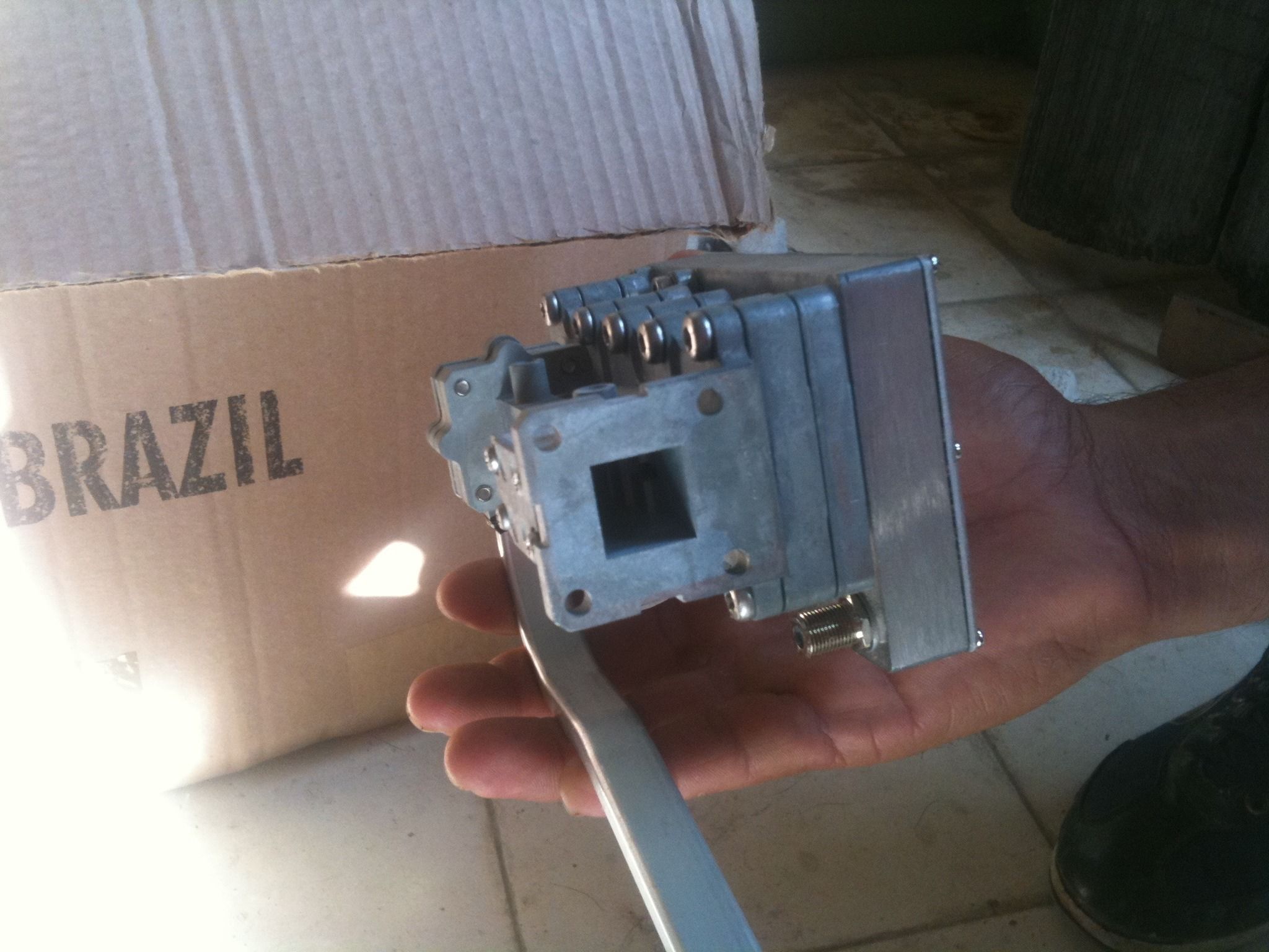

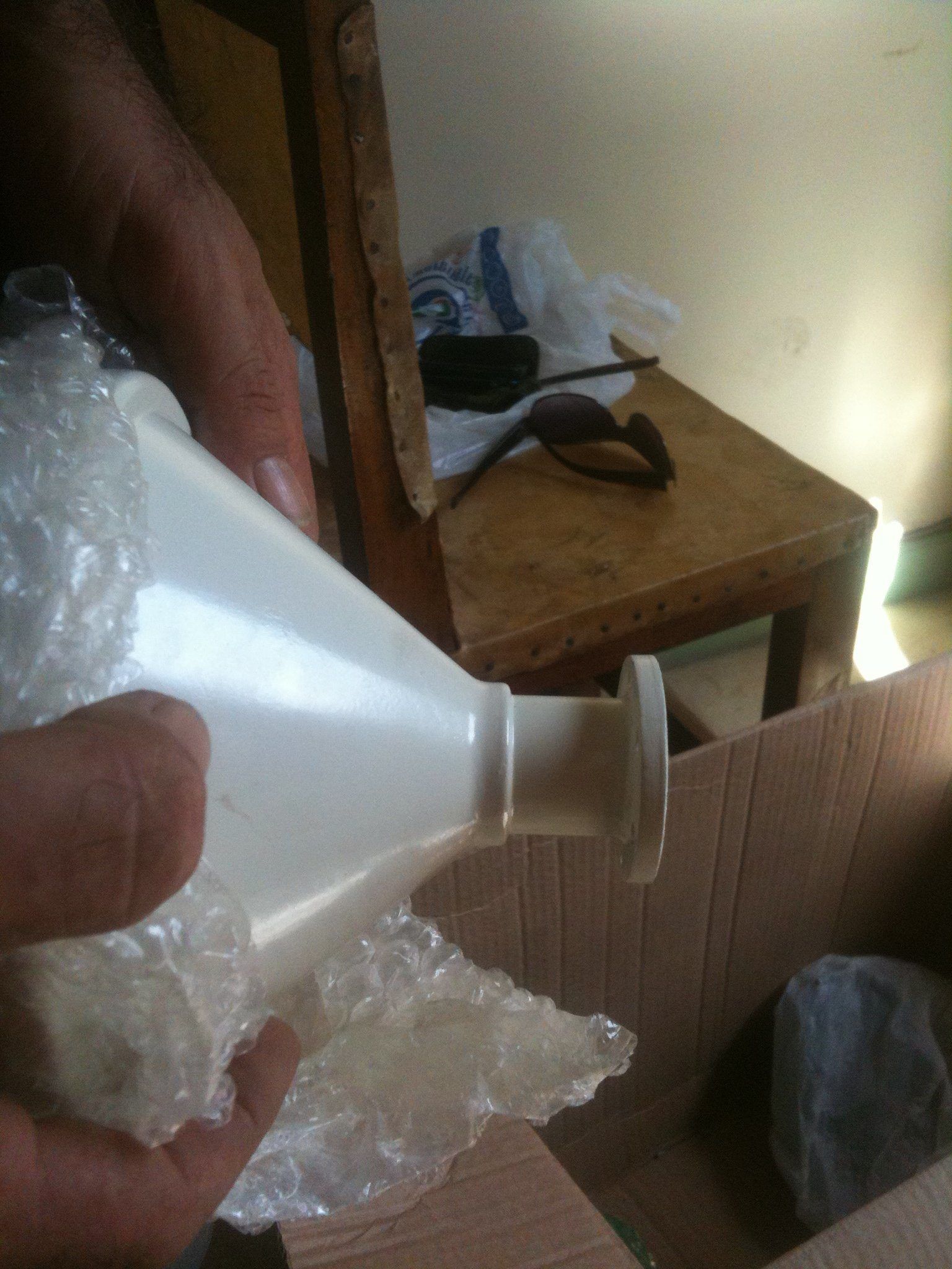

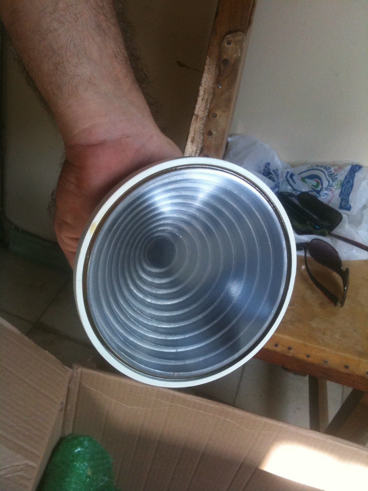

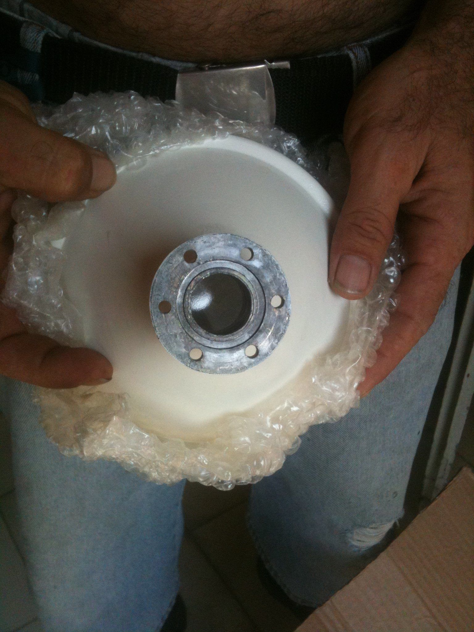

Firt at all hi for all the friends here. And sorry for my bad english. I several months try to emsemble a Hugestnet satellite sistem for get internet acces, I buy from ibay this parts, HN7000S Modem, 2w LNB radio, and a separated feed horn, my dish is a old direct tv 1.20 m offset, there is my problem, the end of the troath of the lnb is quad and the end of the feed horn is circular, what i can do? I need to find a solution because buy another feed horn is very dicult for me, i can use some ring adaptor or somethin else?I can do some home made piece ? Thanks for all guys i hope your can help me in this...

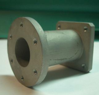

You're missing a part. Depending upon who's selling, it's called (a) feedhorn throat, (b) feedhorn coupler, or (c) feedhorn spacer. They're frequency matched, and cut to a length that exacts the correct feed angle and distance. Unless you can machine an exact duplicate, you're better off buying one. They're neither expensive nor difficult to install, but your system won't work without it.

Thank`s so much friend, i m happy to now that i not have to buy another feed horm, yes buy this part is more easy thing, well i begain to search for buy this in ebay, thank's again.
Try to find one that includes the correct machine screws. Trying to match them after the fact is difficult; you want stainless steel, fine thread, Allen slot cap. Confusing I guess. But take a look at the other machine screws holding the waveguide components together. You want the same kind for the feedhorn coupler. The hex cap permits you to apply sufficient torque to ensure waterproof seal, and stainless is both non-magnetic and rust proof.
