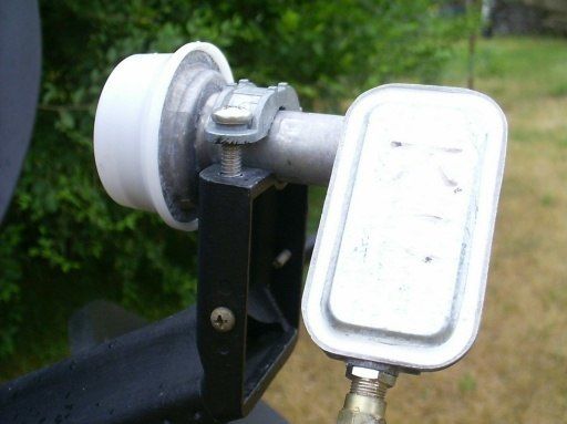

Yes it looks like an LNBF from a DirecDuo (DirecPC) dish. (L.O. 10750)
I have a few of them and the double feedhorn version, they are OK but not as good as the new low noise LNBF these days.

I've got one of those on a DoirecPC dish right now :)
issue with those is you can't skew the LNB. The whole dish has to be skewed

The above LNBF can't be skewed. It came from a DirecDuo system where the dish would have to be skewed.
Yes a DiSEqC switch will work with the old LNB.

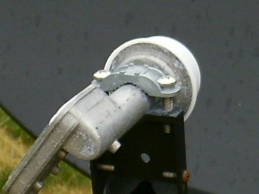

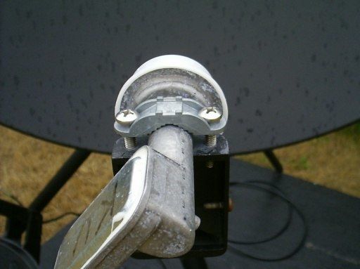

Depends on the LNB holder, I crack open my LNB to expose the 20mm neck then they fit right onto the P* LNB holder.

I've used a couple Sadoun duals on a Primestar dish. The singles don't work well because they don't have the 20mm neck when you crack the case off. The duals do :)

yes enjoy the fine tuning and get used to it , if you have a lnb no need to rush out and get one but the one you listed is a good one , i want one too just to play with. Its a simple swap like my recent one. remove the old primestar lnb and ( of course i had to remove the 40mm plastic cover on the new lnb i used) i bought a clamp and used 1/2 of it to bolt it down just like in the photos from post #9 of this thread. bolts right up to the mount of the current lnb. Can be found at most hardware stores for a buck or two.
