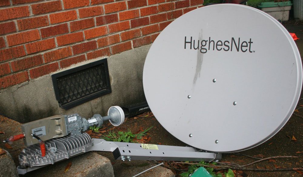

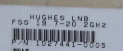

I just picked up a free HughesNet dish (~33" x 28" or so) and the LNB says "FSS 19.7 - 22.2 ghz" Is that thing of any use for me? Regardless of whether that lnb is worth anything for this, I plan on setting this up as a fixed dish. Not sure which bird yet.

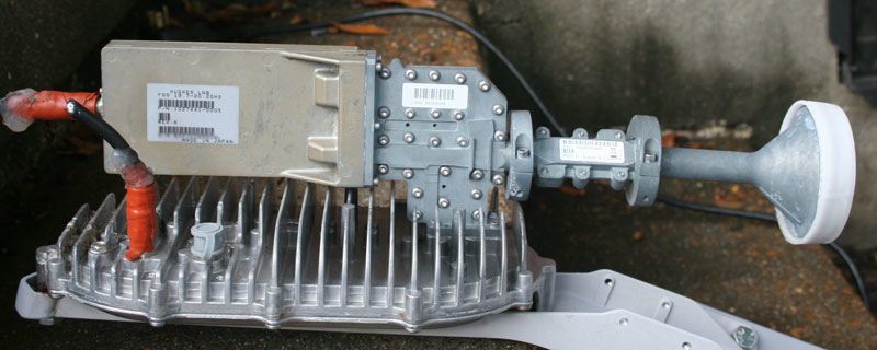

Is the feedhorn in the normal place or is it like a WildBlue dish with a secondary reflector? Pictures MAN!
Am I reading that frequency right? A Ka-band LNB?
Anybody know if Spiff might want to aim that at 99 or 103 and have a peek with some DVB-S2 equipment? :D
Does it output to 950MHz-2250MHz?
Spiff might have some awesomely rare hardware there!

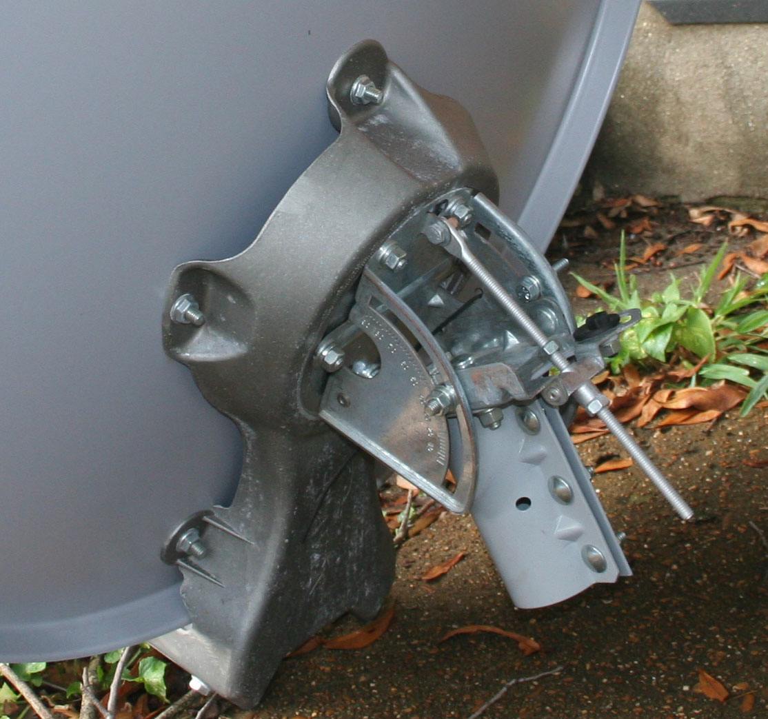

Still don't know what I have, but pics are forthcoming :)
Obligatory pics:

Looks like fairly recent Hughesnet stuff, I think they rolled out some Ka stuff within the last year or so. Might be someone on the broad band forum that could ID/value it. I suspect that if functional the TX brick and LNB could be worth saving and reselling. Use the dish etc for FTA, probably .75m or so?
GL, Eric
Valuable on ebay as its very expensive to purchase one of those new. You may want to try and hook it up to a pci card and see if you can find any KA feeds. Make sure you hook up to the RX side of things.

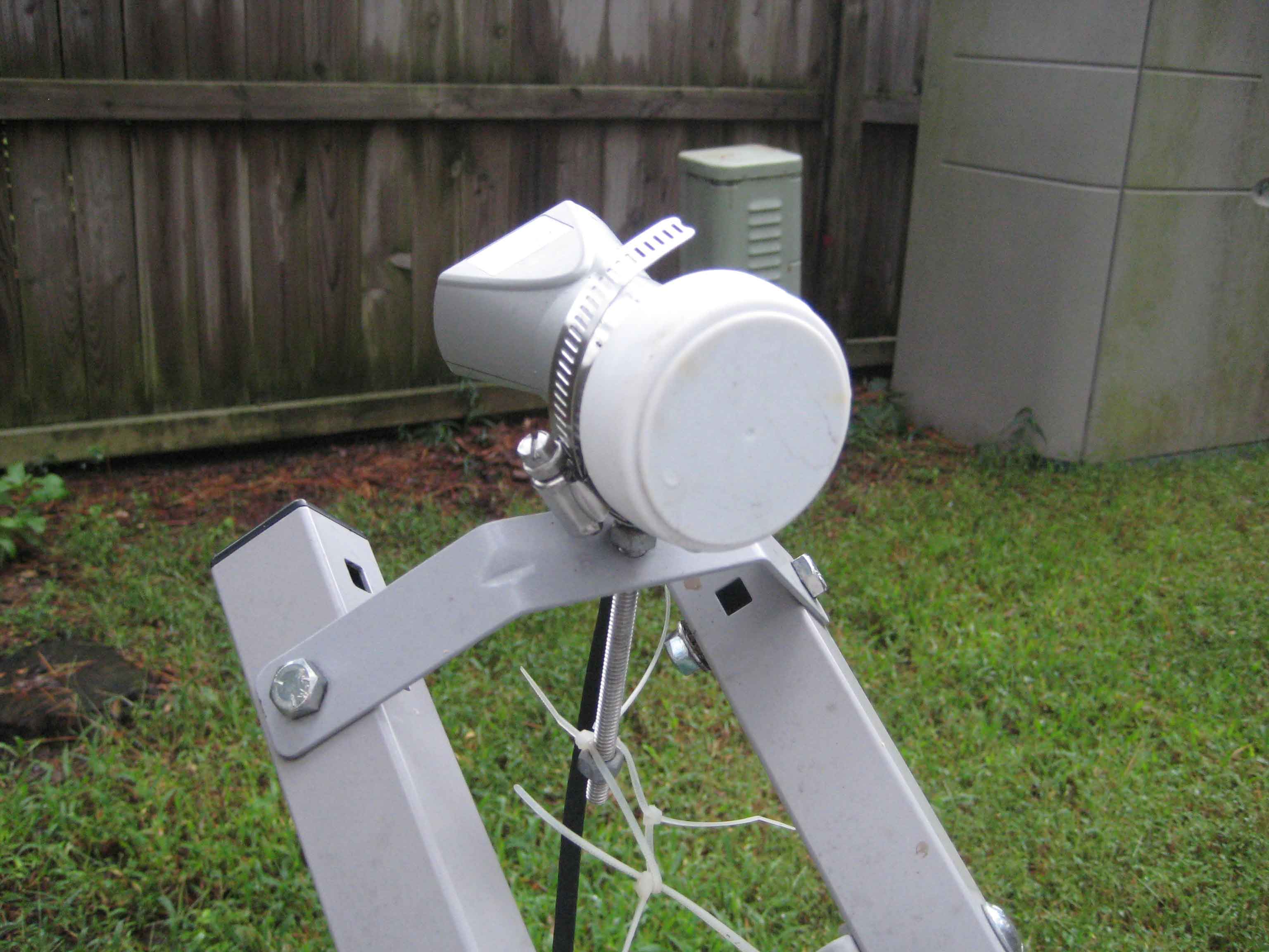

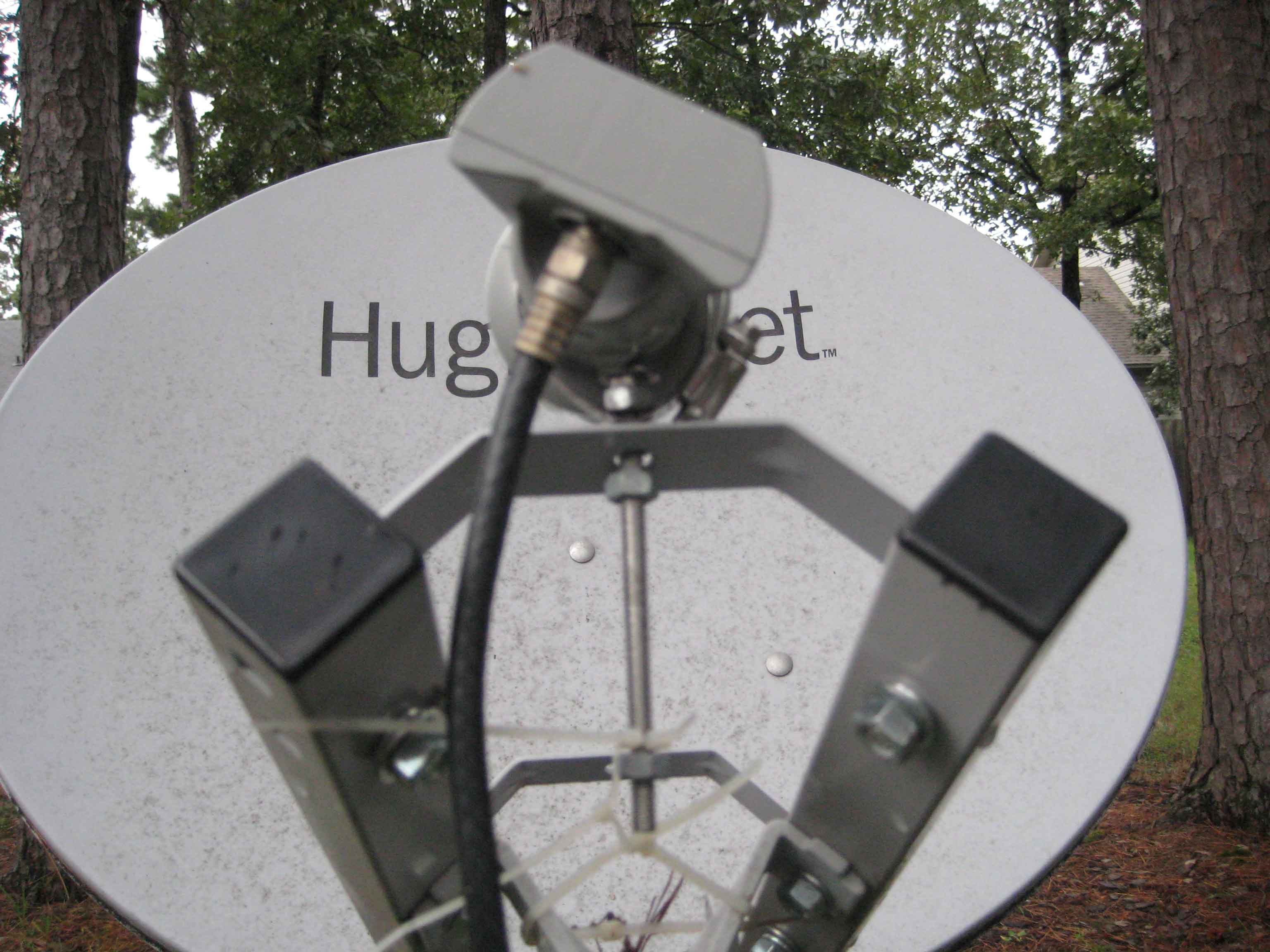

I have that same dish and am using it fixed on Horizons 2. It is a little weak but I can get all of the feeds that I need. I tried it on some other satellites that were too weak before I settled it on H2. See some of my "backyard engineering" in the pics below.
