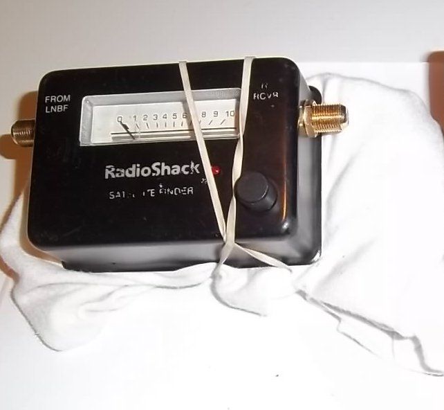

I'd suggest at least getting a meter such as the one below, which will give you some indication that you are pointed in the direction of satellite. It can be installed in line between the receiver and the LNB These meters come in cheap plastic or metal. The pic is Radio Shack's model, not sure if they are still around, but they were going for a buck at the stores closing down. The meter will swing and the tone will change in pitch as the signal changes, giving you an indication of where to move the dish. Radio Shack's meters are made of metal, definitely a plus
