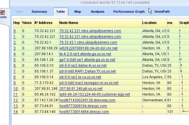

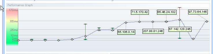

Ok something else that may be throwing glitches in the test.
My current Ip is 97.73.68.124.
but look i can make the test show different. These two test were made just minutes apart. But one has Turbo page enabled and one has it off.
The first one shows my current IP.
The second one shows the proxy server at the NOC. It thinks my IP is 97.73.64.145
And my tps Ip has changed this many times today.
Well the chart won't paste here. But it is ten times already.

Did youchange something on the Route Performance test? Yesterday it was showing the NOC firewall and today it does not but is showing something that i make as the proxy server.
Nope but that's an interesting twist. No changes are being made to the tests currently on the site with the exception I changed the voip codec. By the weekend there will be a new menu option called satellite tools and those tests will be custom just for you guys.

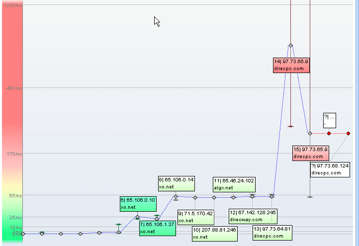

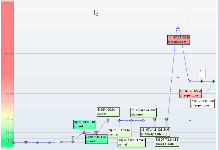

Well I ran all of the new satellite test. Can't tell if they are better or worse than other test. They sure are pretty.
Here is the trace route thingy test. It sure would be confusing to someone not familiar with Hughes and the way they do things.
The chart and map have my path going back and forth cross the US which is not the way it really is. My NOC is in Las Vegas and thats where all of the last four or 5 Ip's are. But it indicates that it goes back to Va and then to German Town.
Now I and most knowable Hughes users know that ain't true.
It happens because Hughes does not hesitate to move server Ip's where ever they need or want them and they don't bother to change the designated location. Don't know if they are just lazy or do it on purpose just to confuse the issue.

The satellite configured route test is now working. I'm curious to see how it handles satellite now. Unsure how many if any have tested it so far so feel free.
Actually routing is many times will change. I'm assuming you are talking about PRIOR to satellite hop. Traffic management will route as needed to keep loads at a respectable level so it's wouldn't surprise me at all that they change. The company I work for may change routing several times per day depending on a number of factors, in our case it's whatever keeps service level at acceptable levels.
I'm assuming you are talking about after the satellite hop.
I wasn't going to waste any more time on this, but I think Tobi deserves a little help in deciphering your spin.
You claim to be a NAT expert, but I'm not seeing it. The ISPGeeks trace never even GETS as far as the satellite hop. Based upon what he posted, it terminates at his NAT. You're simply tracing the route from YOUR (test) server to Tobi's NAT server. All I saw was terrestrial numbers. If his satellite hop was actually tested, the associated lag would add something in excess of an additional 250ms (45,000 mile path plus mechanical delays). But you can't do that, because Tobi himself doesn't actually HAVE an IP address.

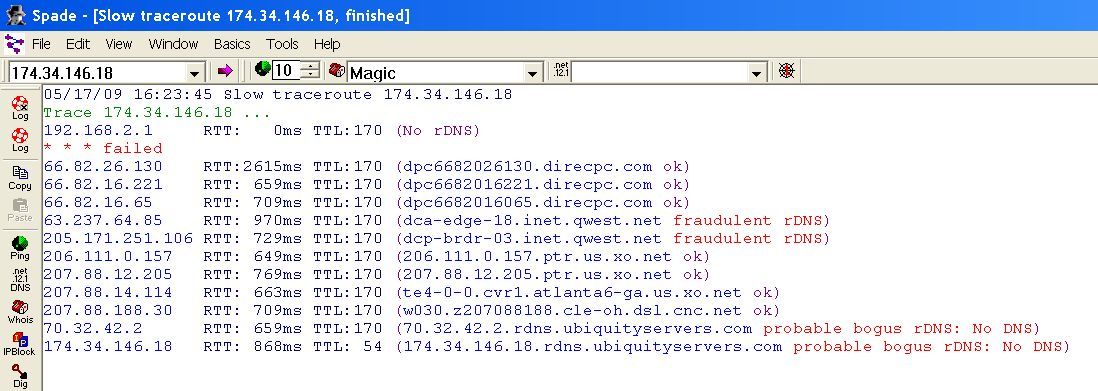

I thought I could extend an olive branch by running a few Sam Spade tests (over my Hughes connection) to your test server, demonstrating with some graphics what the entire path looks like. But you've apparently set 174.34.146.20 not to respond.
FWIW, the inroute speed disparity between the other two (satellite) tests is even worse now. Two out of three attempts at the Speed/Cap test failed, and the three TCP tests seemed to think I was connected via dialup
//greg//
You still don't get it. Your trace never GETS as far as the satellite hop. It terminates at the NAT server. You're tracing the route from YOUR (test) server to Tobi's NAT server - only. Your trace stops there. If his satellite hop was actually tested, the associated lag would add something in excess of an additional 250ms (45,000 mile path plus mechanical delays).
I intended to do you a favor and Spade from me to your test server, demonstrating what the entire path looks like. But you've apparently set 174.34.146.20 not to respond.
FWIW, the inroute speed disparity between the other two tests is even worse now. Two out of three attempts at the Speed/Cap test failed, and the three TCP tests seemed to think I was connected via dialup
//greg//

Feel free to use 174.34.146.18 to run your test, they go to the same box. YOU seem to not get it. The TCP test measures connection quality only and the connections ability to maintain a steady stream of data while engaged in a SINGLE TCP SESSION. It does provide a "basic" measurement of expected bandwidth but can't be relied upon for that ***we clearly state this*** and exactly what test to use for available bandwidth testing which btw is the SPEED/CAP Test. That's all it does. Why not read the instructions below the test that CLEARLY explain this.
On flip side the Speed/Cap Test measures your bandwidth capacity, takes into account acceleration and caching and such and should be used like a conventional speed test (but far more accurate).
Now what part did you not understand Greg?

Interesting claim, considering your membership started a week ago. You may feel that feigned outrage works, but I can't see where it's otherwise supporting any attempts to explain your work.
Nonetheless, I guess since both 174.34.146.18 and 174.34.146.20 are in Atlanta (and you're in Florida?), a trace to any responding server will demonstrate the same thing. In the graphic below, the OSRI is my router. The "no response" is from my modem (set that way on purpose). Note the long first hop is from my modem to my Hughes NOC. THAT sir, is the satellite hop. After returning to earth, the trace returns sorta level out like those displayed by your own test. The one that doesn't include the satellite hop.
But when I attempted to run it in the reverse direction, your site now responds with "Not Licensed for 174.34.146.18". One possible explanation is that you have it down again for some more "tweaking".
Who's playing games now?
//greg//
//greg//
Actually the server detect your activity as a port scan and you were denied access by our firewall...
lfd on server3.ispgeeks.com: 66.82.187.152 (US/United States/dpc6682187152.direcpc.com) blocked for port scanning
