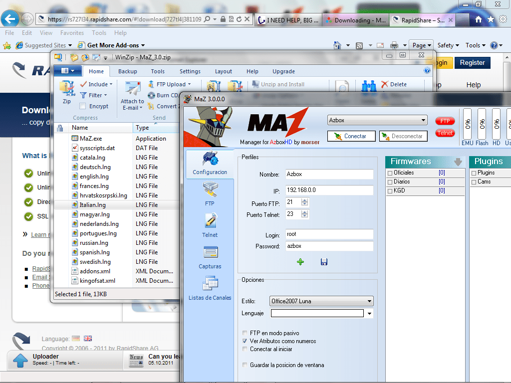

When you run the program, select the top left icon (Configuration) and then the lower window (to the right of the column of icons) is Options, there is no 'Drop-Down' in the normal 'Windows' style.
Here's what it does, perhaps we don't understand
When we click the Lenguaja drop down, there's nothing there

Then you might try this... Put an "English language" movie DVD in your PC's DVD player and then start MazEdit. Please do not "Guffaw" me on this one, as I am totally serious. As bizzarre and looney as it sounds, having an USA (English language) movie DVD inserted in the DVD drive, my Vista OS PC would allow the langauge files or at least English to be revealed when MazEdit was opened. Found this by sheer accident and I have no clue why it worked or what it means. Just give it a try and see if it helps at all. No guarantees here, It's just something peculiar that I observed. It made no sense to me, but it was only that way on my Vista OS PC.
Next... I had other problems with Maz and eventually found a different source to download the app file from. It worked and I no longer needed to do anything special. Go figure. Don't know where I got it. You'll just have to browse around.
