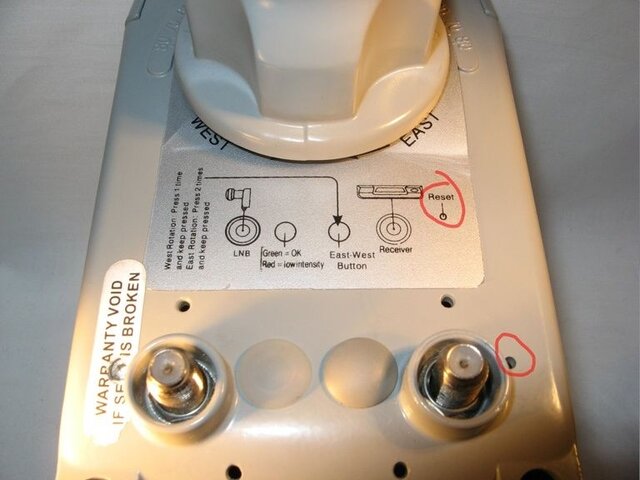

I have an SG6000 motor, is there a way to set it back to zero?
I am thinking that maybe the issue is that it was not at zero when I started and thus it got messed up. I am almost posotive that the elevation difference for the 107.3 versus the 105 is nearly the same so if I can get the motor to factory zero and reset the receiver then I will be able to swing back and forth then find a sat with a quality reading and once I locate the 105 I will be money.
Thanks.

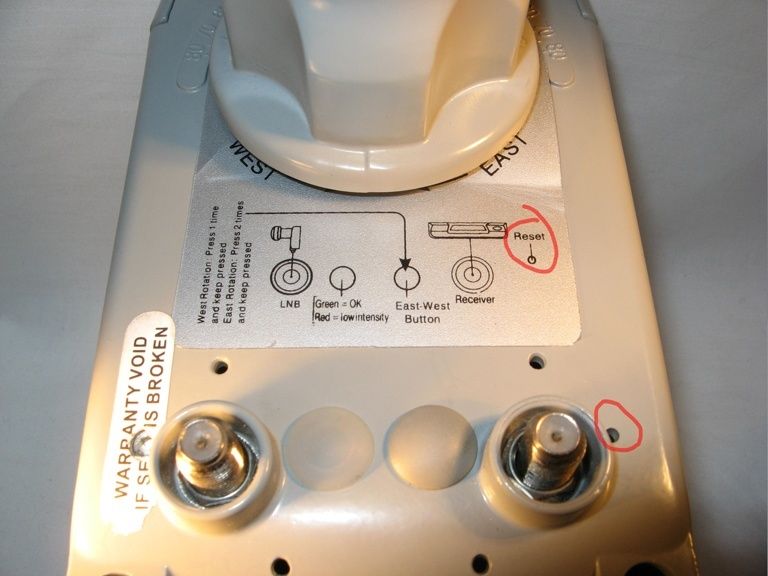

There should be a Hardware reset button on the Motor.
Probably uses a Paperclip to press it.
See attached.....
See attached.....
Lak7,
Do I reset it when it is powered or when it is unpowered and move it back to a locked spot by hand?
Thanks for the info!!!
Power On, hold the reset until you see the Light flash(Orange?)
Edit: If that does not work, at the receiver, look for Goto 0(zero) or Goto X in the Sat setup menu
Ok, I have tried to rest the motor and I used a piece of 12 guage copper wire and nothing happened.
Do I need to use something smaller?
Also I have an IV-200 PRO VisionSat and I cannot find the GOTO X function spoke of in the manual.
If I could get the motor to zero and reset it i think I would be fine.
The problem is that now that I found the 105, everything is off, the reciever thinks that Galaxy 26 at 93W is good to go, but it is receiving all the channels from Galaxy25 at 97W!!! and the 105 and 103 are both showing the same channels and not to mention that the 97 is receiving the Pentagon channel marginally!!! I messed up and hit the recalculate many times between those satellites and jacked up the motor settings.
