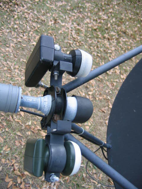

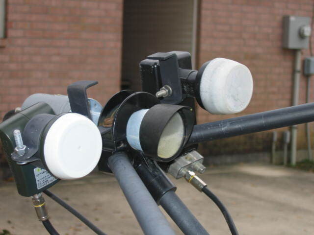

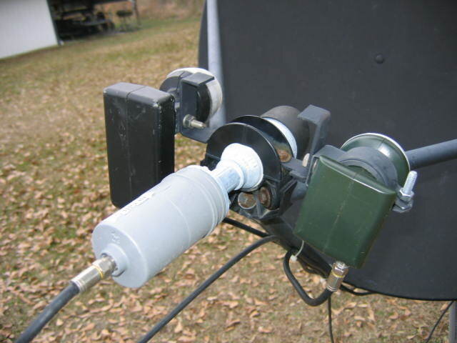

What if I could put three LNB's on a motorized 1m Primestar dish? :)
After about 6 hours, SHAZAM! :)
The universal LNB doesn't work that well, I think I need to do some re-engineering, I don't think its at the focal point of the dish. :D

Nice bracket work Stogie, I'm going to have to bookmark this one.
I have a standard and circular on my motorized dish, and it works pretty good, but want to work on a better bracket system when it gets warm out a few months from now :)

The brackets are 1" wide by .125 thick steel, its surprising what you can do with a bench vise, a ball pein hammer and some time. Used the stainless steel bolts from a wrecked BUD I got awhile back. Only thing I bought was the conduit clamps and paint. Had to cut a piece of 1.250 plastic pipe to use as a spacer on the Universal LNB to get it to clamp right. I am gonna take that off and replace it with a stainless hose clamp so I can have more in and out adjustment to get the focal length right on that Universal.

I did my motorized like Iceberg. Only have one DBS hanging off the side with hose clamp and wire ties. Been on there over a year now and still working fine.
I offset mine 6.2 degrees in USALS from where it is supposed to be, and it work fine.
I thought I saw a Hughes! Pound for pound, an absolutely wonderful LNB! I only wish there was a dual-output version. That's why there's a stacked Dish FSS LNB on my 1M Channel Master instead of a Hughes...
