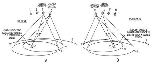

If its interference from an adjacent satellite using the same or a similar transponder that would explain it!
We have come across this before with sports feeds and even on the G10R satellite, its as though the adjcent satellite using the same TP. pulls some power from the signal.
so true :)
The key thing is the adjacent satellite has to use the same polarity and a close frequency. Thats why on G10 11720 gives us fits (because DIsh121 has 11724 next door at 121) but 11800 doesn't (Dish uses 11800 too but H polarity).
The bigger the dish, the less interference
