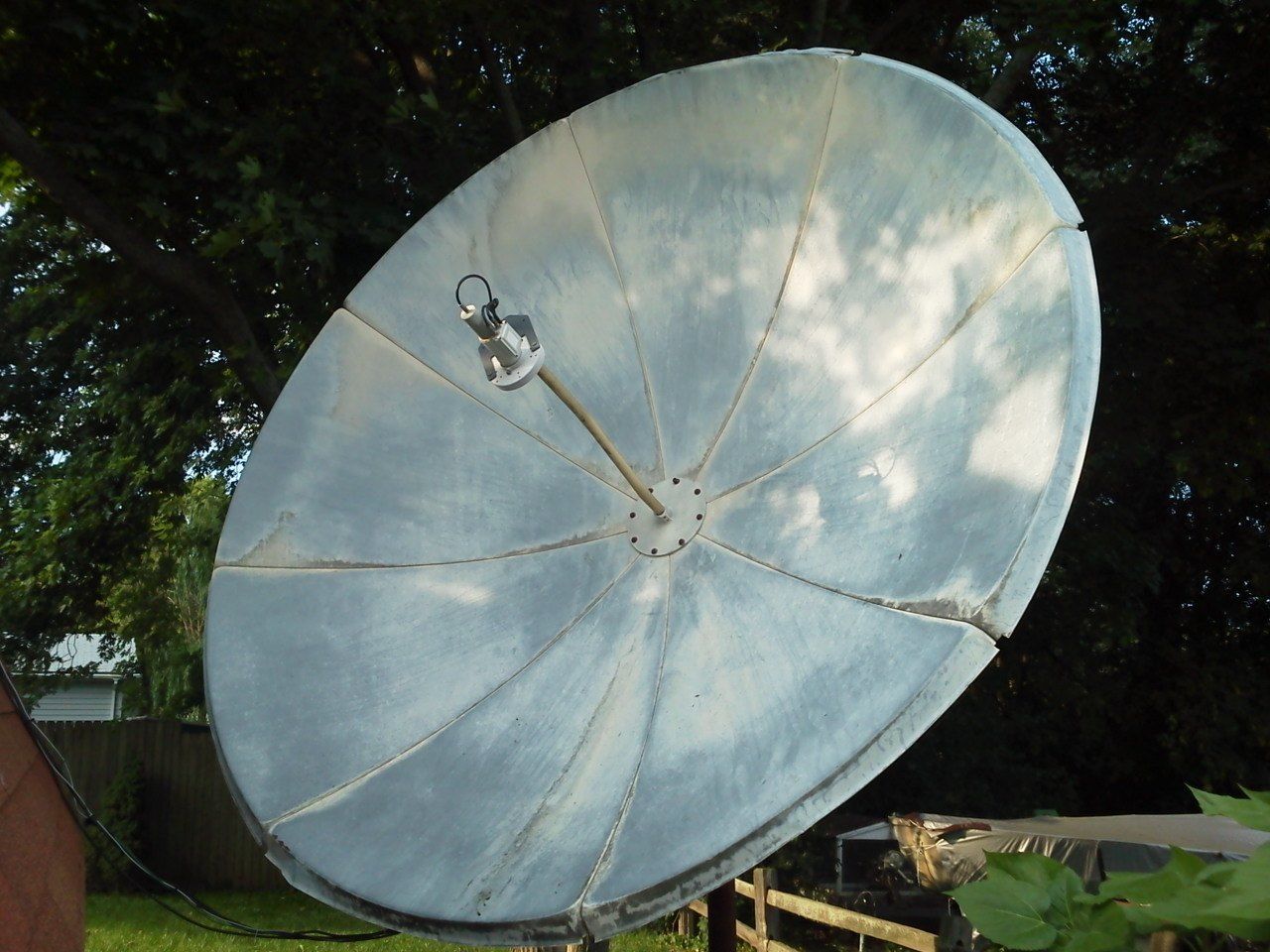

Well, I am in the ARC, I scan from 72.0 W to to 127.0 today. i noticed is no much up there after 121.0W.
here are some pictures.

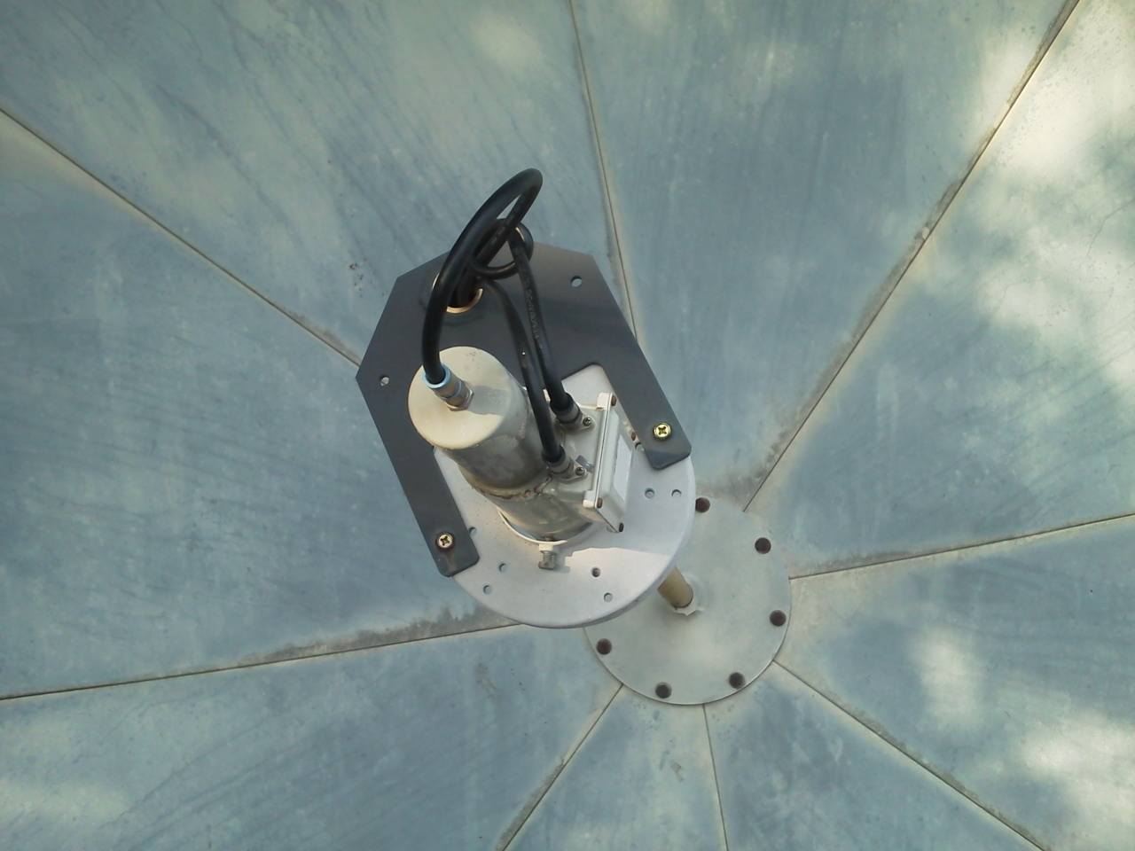

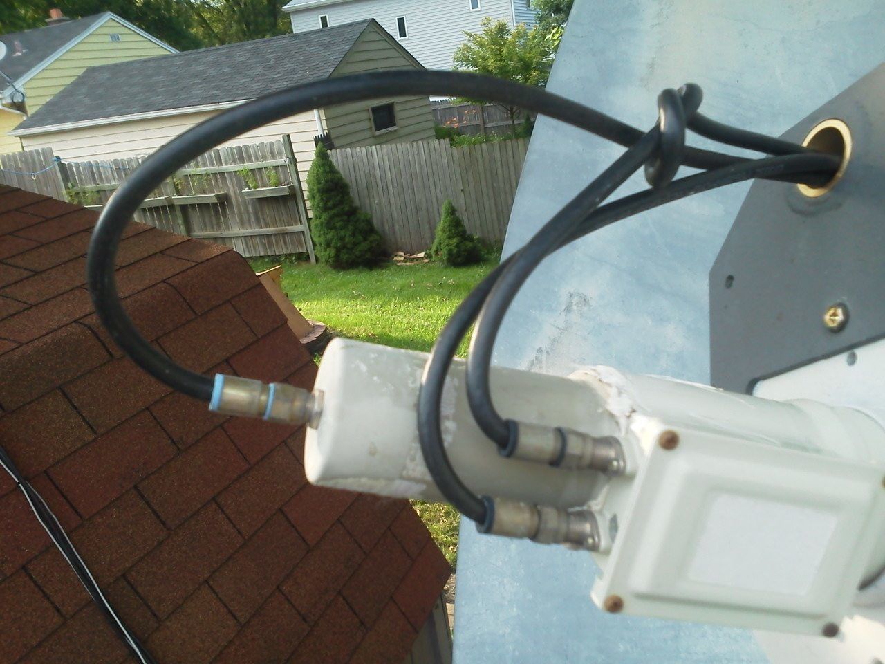

I need to rotate the ortho feed so the vertical LNB is on top.

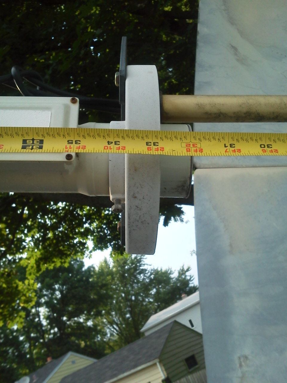

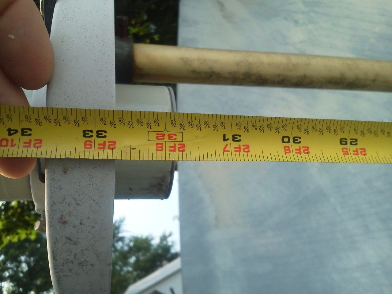

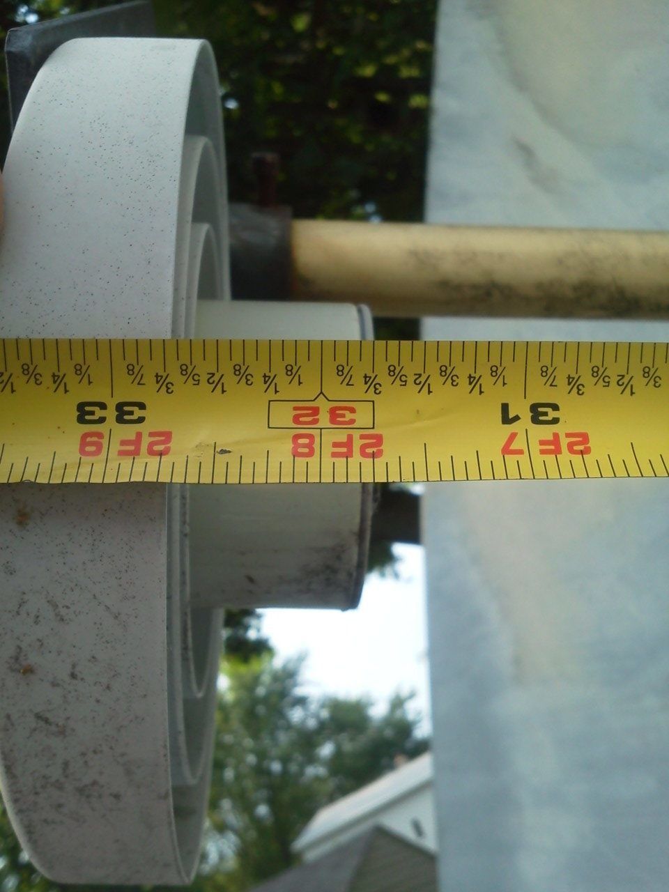

GARDO - Can you tell me the focal distance of your set up?
Best regards.
Chewie
i am also curious of your measurements.

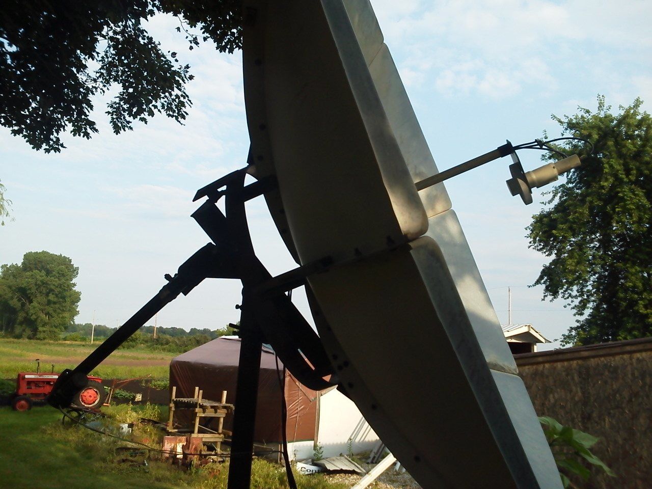

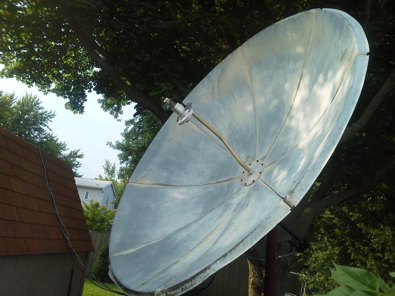

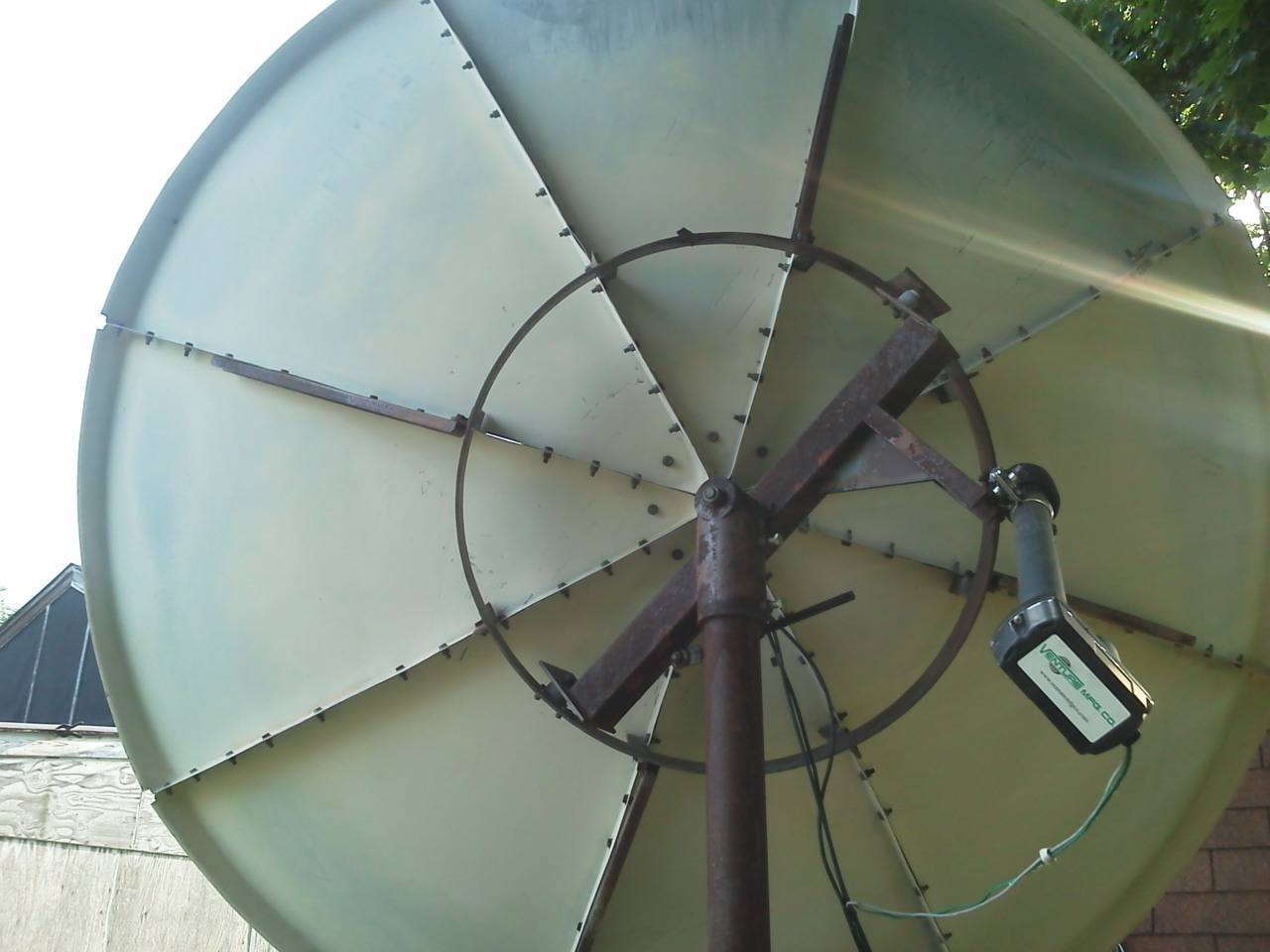

Over all pics of my lnbf and 9ft solid laux beta9

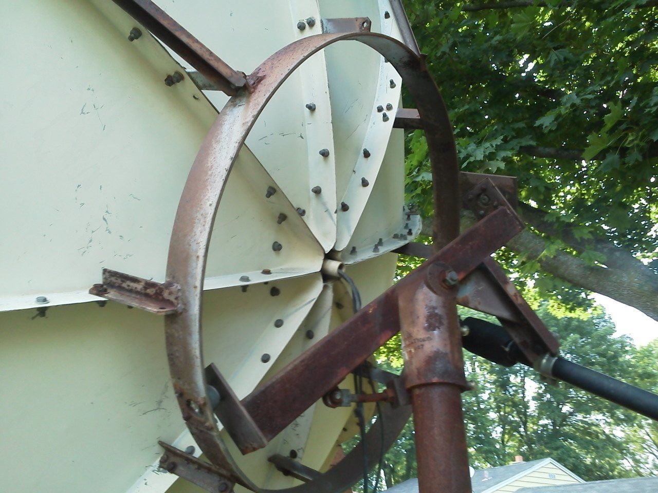

i shoulda painted the panels, b4 i put it up, the original paint is flaking off

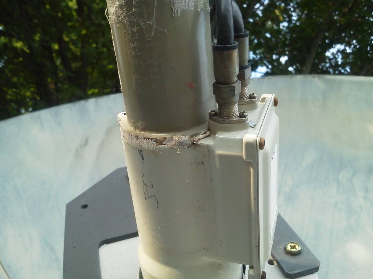

i had no idea the lnb was supposed to stick thru 1 inch, very interesting.
mine came with a 4 ring scalar, is the 3 ring better?
I probably have the original scaler somewhere as i have like 3 of them scattered aroumd here... I never noticed the different number rings...
If i remember right the LNBF holder hole does not line up right so I used this one
The one near my house has quite a bit of rust on it. I think a repaint job is a must for these dishes before reassembly.
I wonder what commercial metal treatments might be considered. ?
Powder coaters could offer some suggestions.
They do all sort of metal prep before coating.
If I get bored... I mean real bored!!! I was thinking pressure wash it, than get ahold of some white enamel and reduce it to spray it through a gun...
