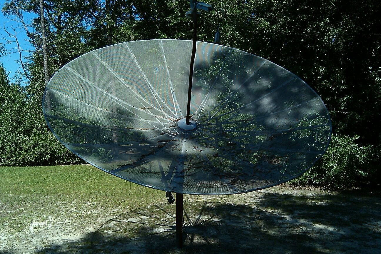

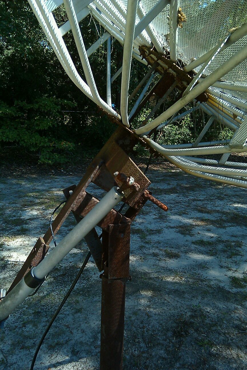

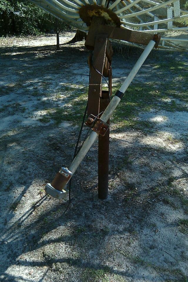

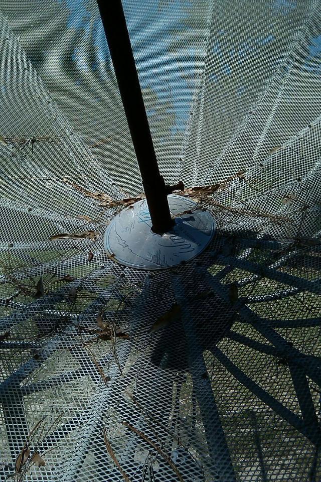

Me and a friend do IT work around pensacola. He goes to a lot of remote places in the country and came upon this the other day and the lady said who ever wants it can come get it. It looks pretty rusted and strange. If you were offered would you take it. I do have a new c-band lnb for it.

Hi, when I look at the 3RD picture the way the light is coming and the shadows from the mesh it looks like the rib supports are made of Re-bar. ;-)
Looks like it is still in serviceable condition, should make a good BUD project.
Later, DC
You didn't say the size, but with the complicated ribs, I'm guessing 12 feet if it's an inch. - :cool:
Is it well painted, powder coated, or all aluminum?
I grew up in Florida, and to see no degradation to the dish, is impressive.
Especially compared to the mount. - :rolleyes:
edit: I'll go out on a limb and say it's for C-band only. Too coarse for Ku would be my guess.
Find that baby a home. Don't let it go to the scrap yard.
