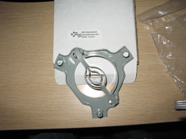

I am looking for ideas on how to get a GEOSATpro SINGLE STANDARD KU PRIME FOCUS LNBF to fit where a normal C Band LNBF would fit on my 6 foot dish.
Any ideas are appreciated.
LNBF mounts
I presume you still have your old scalar on the support arms. Does you scalar have the dual bolt patterns: 3 @ 120* & 4 @ 90*? I haven't set my 6 ft up yet but was just going to use one of the DMS Intl model Ku2C3. If you've 4 support arms just use longer bolts & turn the scalar over & bolt on one of these.
Probably whip up something with conduit hanger brackets.
It'd be quicker and cheaper.
edit: or from the Iceberg school of improvisation, how 'bout a wood block and a zip tie.?.! . - ;)
But the idea Brex posted above is much nicer. - :up
