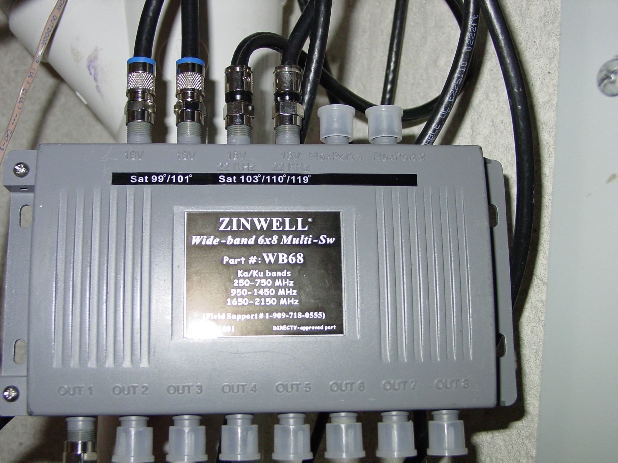

The problem was that the DirecTV installer who installed the new 5LNB dish a couple of months ago left an "OTA diplexer" in the cable down lead from the dish in the attic which did not show up until the new HD channels were added on Sept. 26.
I was having trouble getting the 103b satellite odd transponders yielding only signal strengths of 0. The even transponders were around 85-95%. I was able to get all the new HD channels except five, which I presume are on the odd transponders. The channels I could not receive were 265 A&EHD, 269 History Channel HD, 280 Learning Channel HD, 247 TBS HD, 362 Weather Channel HD.
A call to DirecTV high level tech could not even tell me what satellite the channels I was unable to receive were on. Then I called a local sat dealer and had them come out to take a look. We fooled around quite a bit before we disconnected two lines from the multi-switch and connected them them directly together. After the direct connection everything works perfectly with all transponders on the 103b now achieving signal strengths in the high 90's.
A photo of the multi-switch is attached. The lines that have been disconnected from the switch and connected directly together were in positions "OUT 1" on the switch's bottom and line "13V 22KHz" located on the top of the switch. Funny enough there still remains three lines left on the multi-switch in positions "18V", "13V", and "18V 22KHz".
Does anybody know what the correct setup really is, and why the DirecTV installer would have set it up this way in the first place?
Not real sure what your asking, but your set up in thepicture looks correct, except I don't see the need for the WB6x8 in the first place if your only using one receiver.
The bottom row is for the connections to your different rec's, the top needs to be filled from the dish. 1 coax for the 13v side and 1 for the 18v side and 1 set for the 22 khz side.
Leave the flex port empty.
Everything looks right.

The photo was taken before the changes were made to enable me to receive the new HD channels. In the text I describe that the the "OUT 1" and the "13V 22KHz" lines have been disconnected from the switch in the photo and connected directly together in order to receive the new HD channels.
