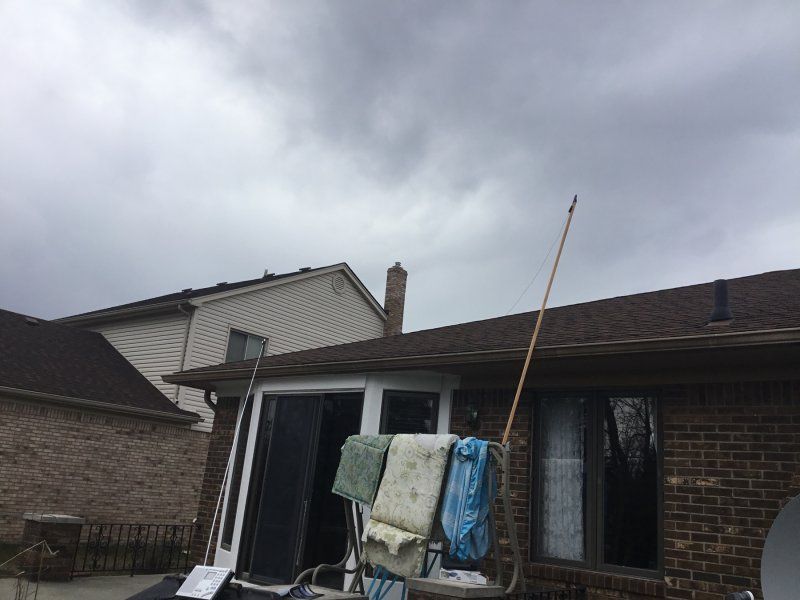

Ok, at my new house I finally put up an old fixed 3ABN 39" KU dish with a Geosatpro SL2pll Standard Ku dual lnb. I haven't done this up to now, because with the tree cover, I never figured I could get anything, so just didn't bother trying till now. So, I installed this dish on a eve mount, and it's 20~ft above ground level. That helps clearing the close 85ft or so trees.
Anyway, on my old MicroHD receiver, I was trying to aim for 97W (figured this would be easy, and I'd go from there), and set the elevation to 38 degrees, 12.9 ~ skew and more or less pointed towards ~205magnetic.
