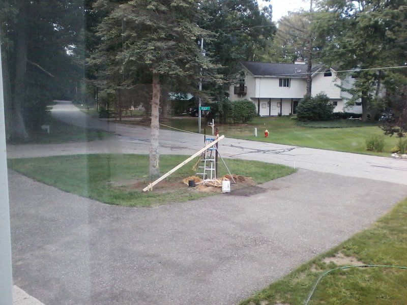

Where are the pictures? Isn't this an illustrated story? ;)
It will be, but now that I've quit for the day, my body has completely CRASHED. It's been a busy day, and mixing (in a 20 gallon plastic tub) and shoveling 80lb bags of cement one at a time takes a lot out of you...
Here's one photo from out my living room window, not sure you can see much with the ladder and braces. YEP, it's only 17' in from the main road! That's the nearly new asphalt driveway I jetted a 30' length of pvc pipe under for the coax and wires going to the dish...:
When I put up that pole last October, a twenty dollar bill mixed the bags and set the pole. ;) But I know what you mean about the effort you have to put out nowadays to get stuff done. We will wait for pics :)
