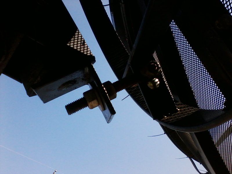

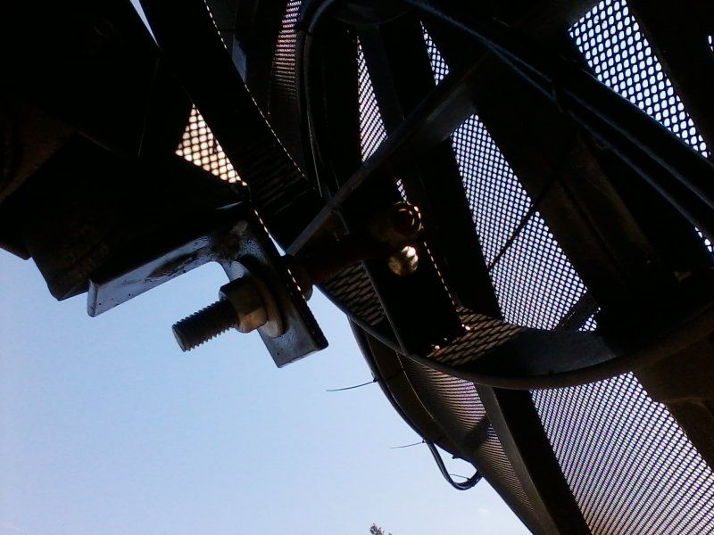

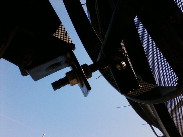

Well, this dish had ONE birth defect on the polar mount I just corrected. The Declination bolt on the bottom, they drilled the hole dead-center of the welded in metal piece. However, that meant the bolt was canted when adjusted, so you never could tighten the nuts on each side and still have that bolt straight. So the bolt was just held tight by two nuts that were slanted, and never could be tightened properly. I just couldn't quite get the mount peaked as well as it could be, so I decided to hold off on that for a bit, and drill a NEW bolt-hole slightly higher on that metal, so I could get that Declination bolt straightened. I did so, and it worked perfectly! I then double-checked and tweaked the elevation and Declination to make sure they were dead-on. I came back inside the house, drove the dish over to 113w (which was the furthest West I've been able to get so far with this dish), and now ALL the channels on this scan in, (only 4 did before) and come in at high quality 75% compared to before!
I haven't had time to see if the other sats are peaked better as well after this fix, but I'd bet they are. So far I can get sats from 55.5w Intelsat 34, all the way to 113w Satmex 6. My ku dish that was right here could get up to 121w, so I'll be checking those ones further West of 113 soon.
At my old house, I could never get anything further East than 72w, due to all the trees. This dish at the new house can get far MORE sats, and all these last two years I didn't figure I would be able to get hardly anything because of the West tree line!
Not sure how well you can see these pics, but here it is after being re-drilled. The silver colored blind bolthead, is in the original hole and tightened up since the new drilled hole is above, and close enough to the original hole I was concerned it might possibly eventually break through. This way it can't:
