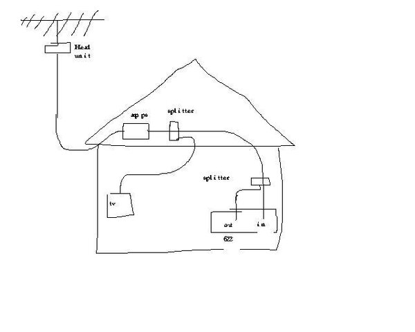

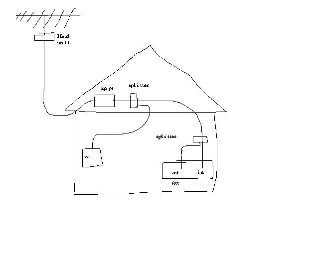

What is the correct way to combine a modulator and an antenna feed and prevent a signal from going out the antenna?
I was wondering this myself. I have a OTA with a RS signal booster that has a head unit up on the antenna and a power supply base in my attic, then it goes straight to a splitter and heads to my 622 and other TV's in the house. If I took the modulator output from the 622 and looped it back into the OTA cable coming in, would the amp/head_unit combo keep it from broadcasting back out into the nieghborhood?
Please forgive my primitive diagram.
