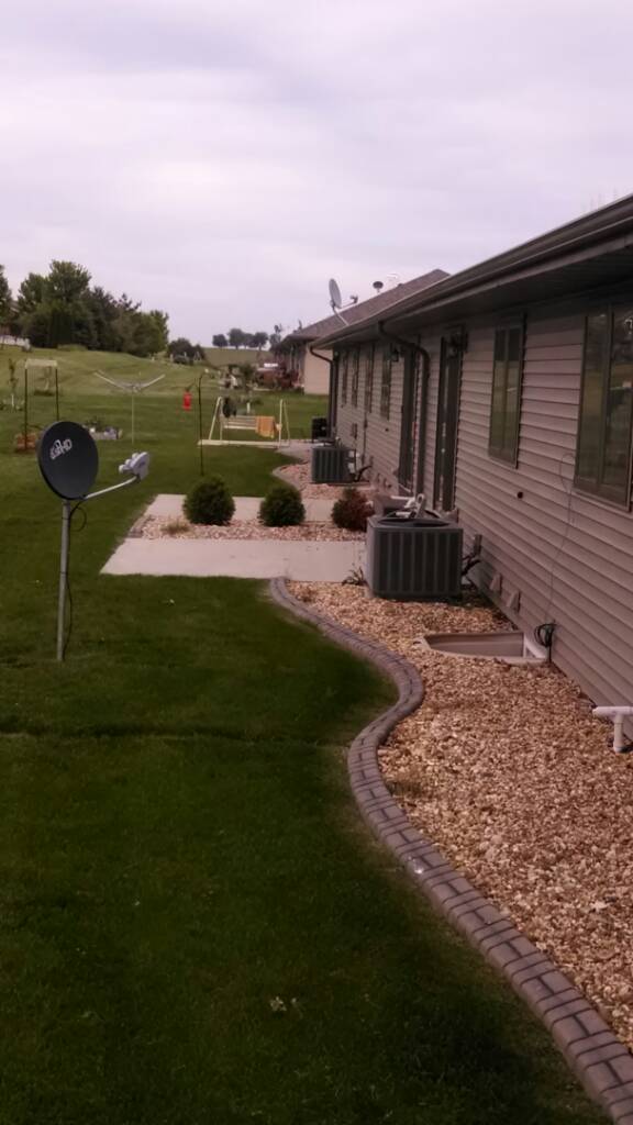

This dish seems like it's not pointed at the southern sky.... It's pointed south but the sky? Doesn't look like it. Anyone have any info on this? From what I understand, the house is using this dish.
An offset dish like that one receives the signal at an angle down into the dish, not straight into it like a prime focus dish does, [a dish with the LNB mounted in the center of the dish rather than on a arm at the bottom like that one] so even though it looks like it's pointed straight at the house, it's actually aimed above the roofline of the house.
