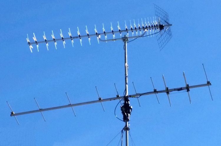

The attached photo shows my UHF/VHF combination. I've got the 91XG for UHF at the top and a 10 element high VHF yagi below it for VHF. They are connected to a combiner and there's one coax coming down into the house. You need an antenna with some gain for VHF if you want solid reception all the time. I don't think you need the 10 elements (in fact, I don't think they make it any more) but a 5 element version should work great for you. These antennas get stations that are 65 miles away as well as a VHF station that's 83 miles away occasionally.

That looks a lot like my setup! :) VHF high-band is an Antenna Craft Y10713 (as you said no longer made). UHF is an Antennas Direct 91XG. All of our channels are 2 Edge either 42 or 57 miles away. The 91XG gets one of the channels that is 57 miles away but I need to try another spot as we are still missing the other one at 57 miles. Did get a glimpse of it though!

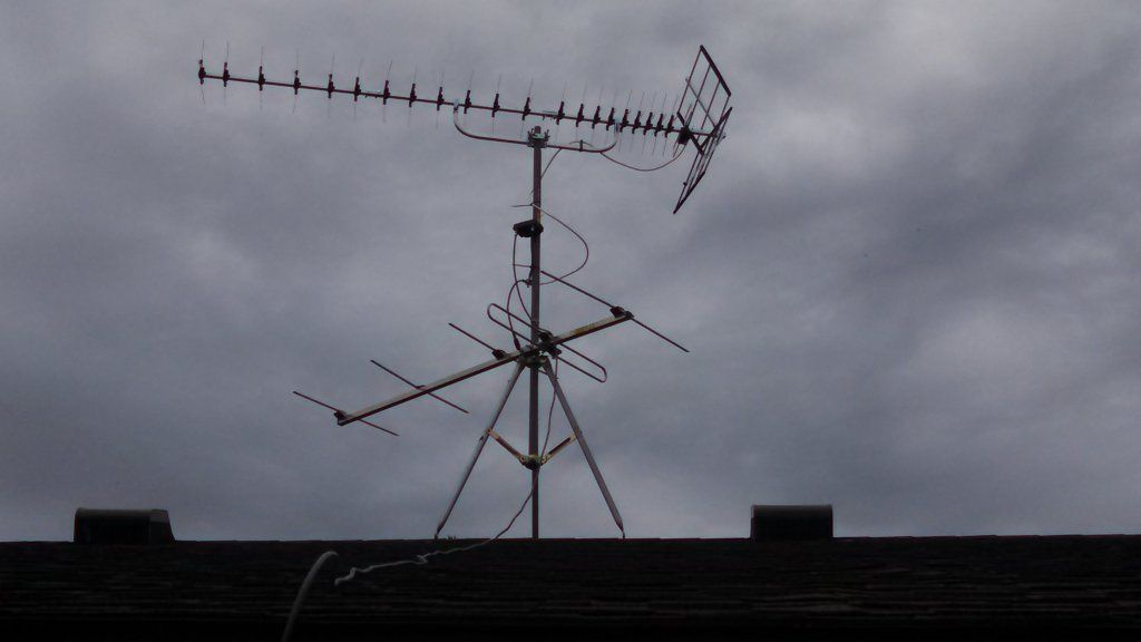

Have the Y5 version which works great for my one VHF station

On my setup the vhf is resting on the top of the tripod. if I move it up 6 inches on the pole the signal goes down
