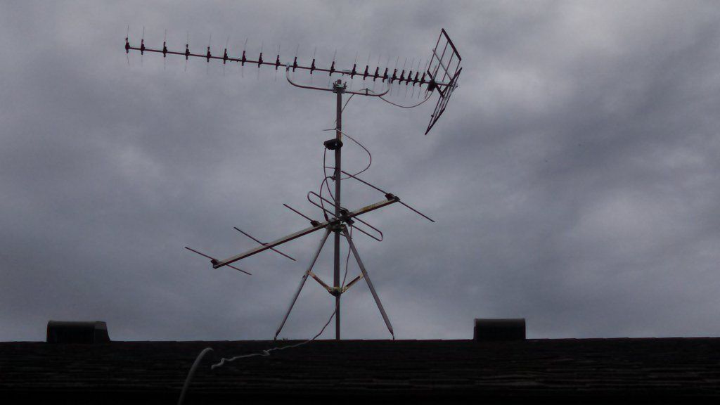

My CBS is 56 miles away (KCCW Walker, MN...owned and operated by CBS just like WBBM) and I use a VHF only antenna like the one you have and it works great. (top one is UHF)

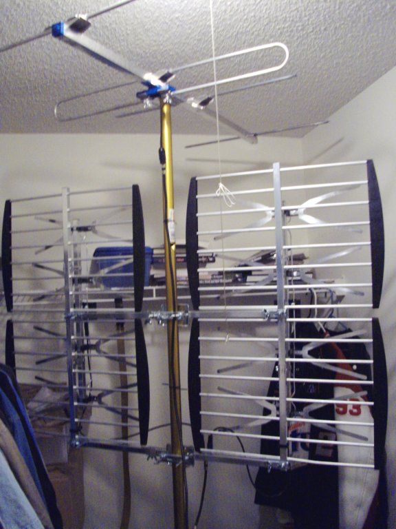

I received the UVSJ combiner today and connected everything. All channels are working on my Dish Hopper with signal strengths anywhere between 75-100. The only thing I did notice was that I think I have some multi-path interference, possibly due to the 2 antennas being close together? I see the signal readings on some channels constantly bouncing back and forth between 80 and 100. It doesn't appear to be causing any problems with the Hopper reception, but I decided to go one step further and connect a cable directly to the antenna input of my 10 year old Hitachi rear projection TV. The tuner on that TV appears to be more sensitive, as there are a few channels that are getting very low signal readings and have reception issues even though they look just fine on the Hopper. Any ideas for what I should try?
How close are they to each other? As long as its 2 or 3 feet away you should be fine.
Closer than that. I was working in somewhat tight quarters in my attic. There is probably only a foot between some of the elements on the two antennas.
because they are of different bands you should be OK. I know of folks who have the antennas right on top of each other.
When I lived in my apartment the antennas were about a foot away and it worked fine
