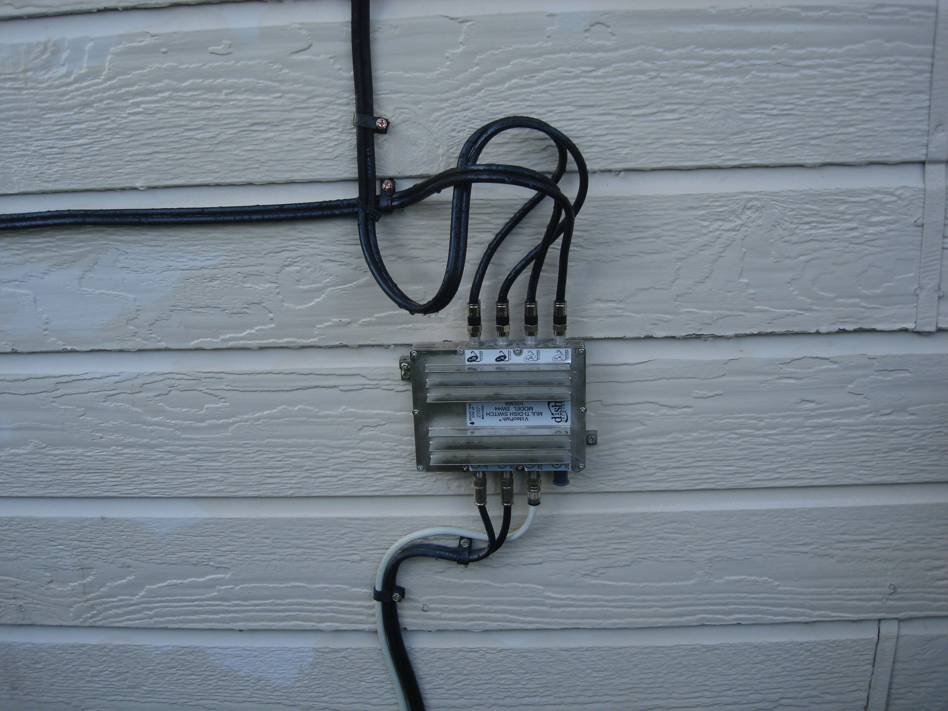

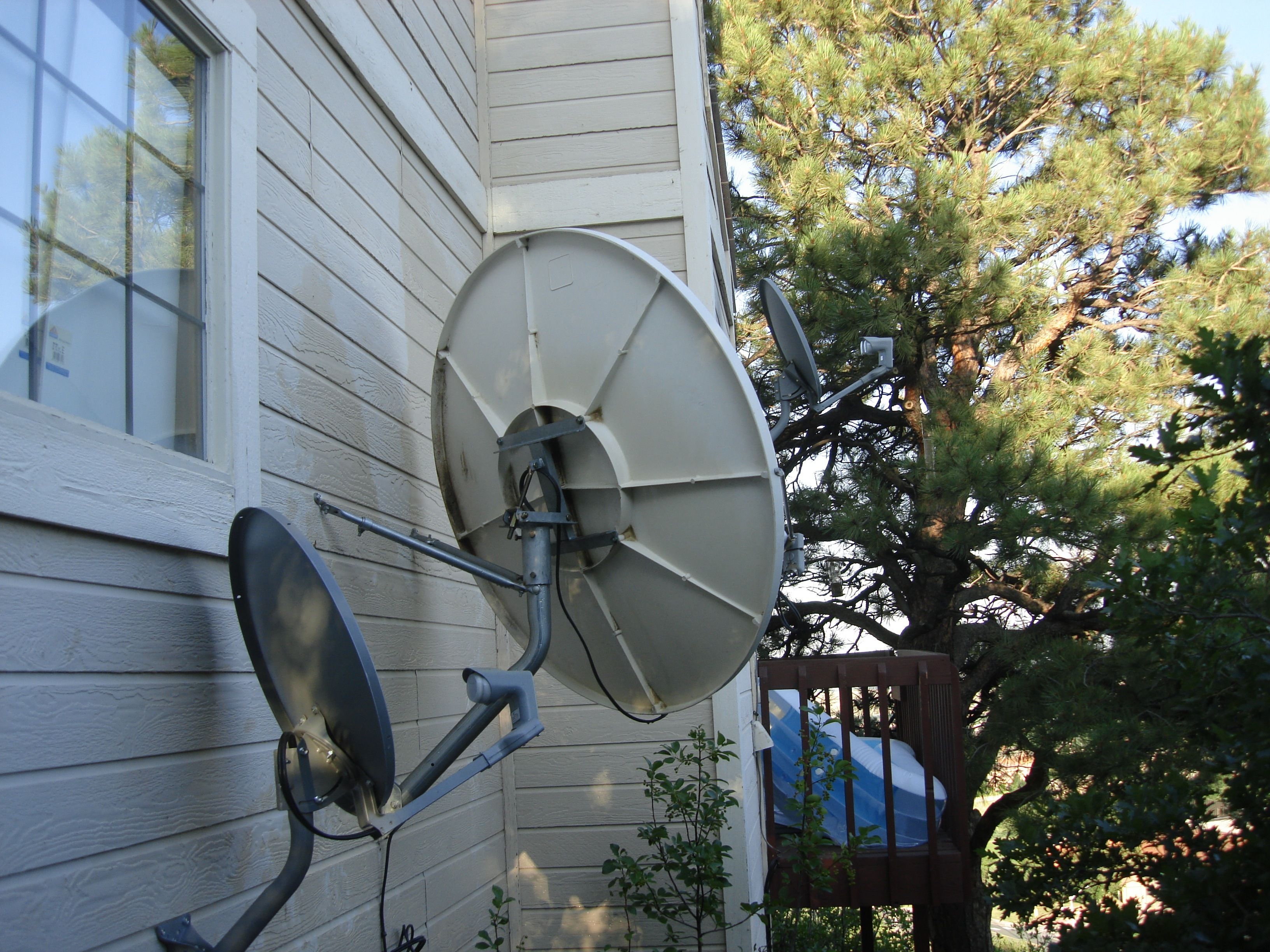

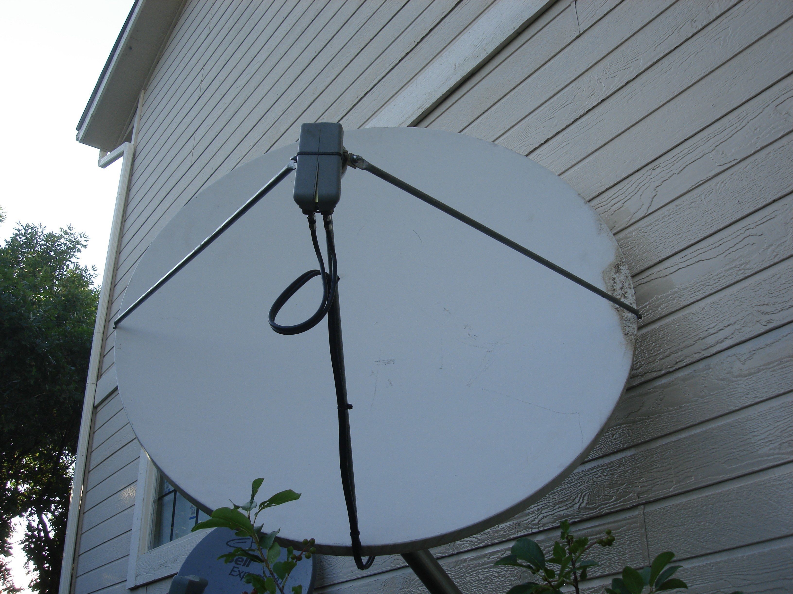

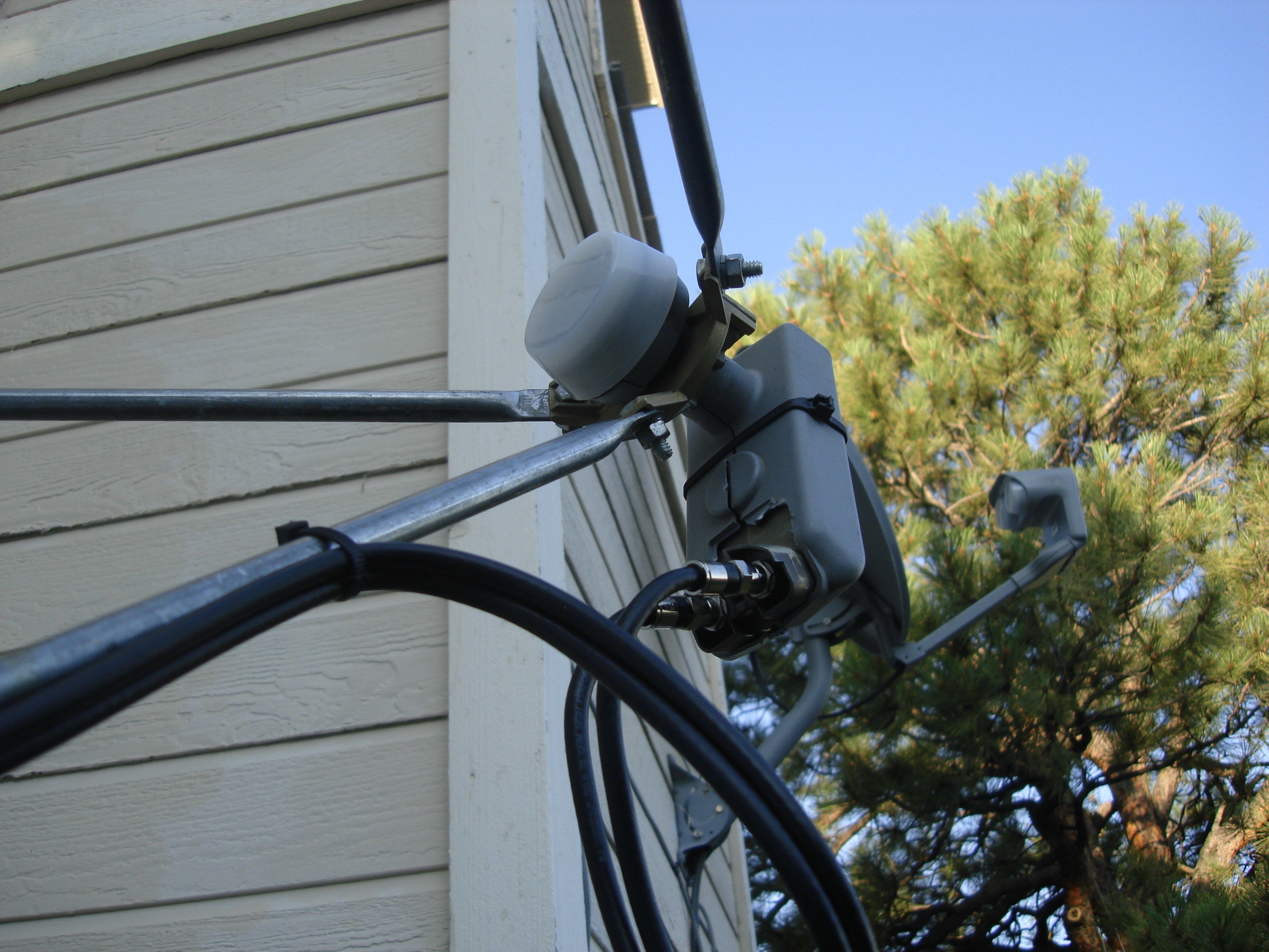

Ok here are a few pics, The sun was getting close to the mountain, so it was shady, but I got some. I can get better ones if needed.
The first image is of all 3 satellites. The closest is the Bell original, it is now 91, the big one is obviously the 82, and the farthest away is the Dish Network original (installed way before by a different installer, but these guys remounted it when they came in 2007 since it was hanging off the siding almost from the original Dish installer...)

He came over with the dish, and I asked for you and he said he had 2 more of them that he knows of. They were pulled off of a hotel I think. I will take pictures and post more details later. He said he would give it to you for $125 including mount. And he does do work in Denver and would go to install it. Took both of us together about 4.5hours to mount and aim both the old dish (moved it) at 91, the new uber dish at 82, and readjust our real DishNetwork dish because it "drooped". This was partly due to the fact that all data for Nimiq4 was completely off on the Briddog website. We were locking on various Echostar and also BEV91. So after reaiming for a few hours we got it to lock on Echostar 4 @ 77W. The 82 signals blipped on the 9242, going from 0 to 30 to 0 to 30 and so on while we were locked on it. So then we moved it 1 sharpie marker line clockwise and his meter's spectrum analyzer lit up like a christmas tree and was blipping like crazy. Did a rescan and voila. 82.
So apparently it is nothing like what any of the aiming guides said. It is pointed waaaay east compared to the 91 dish. I am surprised we even picked up 82 to begin with a year and a half ago.

But if you just want the dish, I am sure he would sell it to you. It is all 1 piece fiberglass with metal mesh inside it. Looks snazzy. It's got some dirt on it, but nothing a few Lysol wipes wont take care of :)
