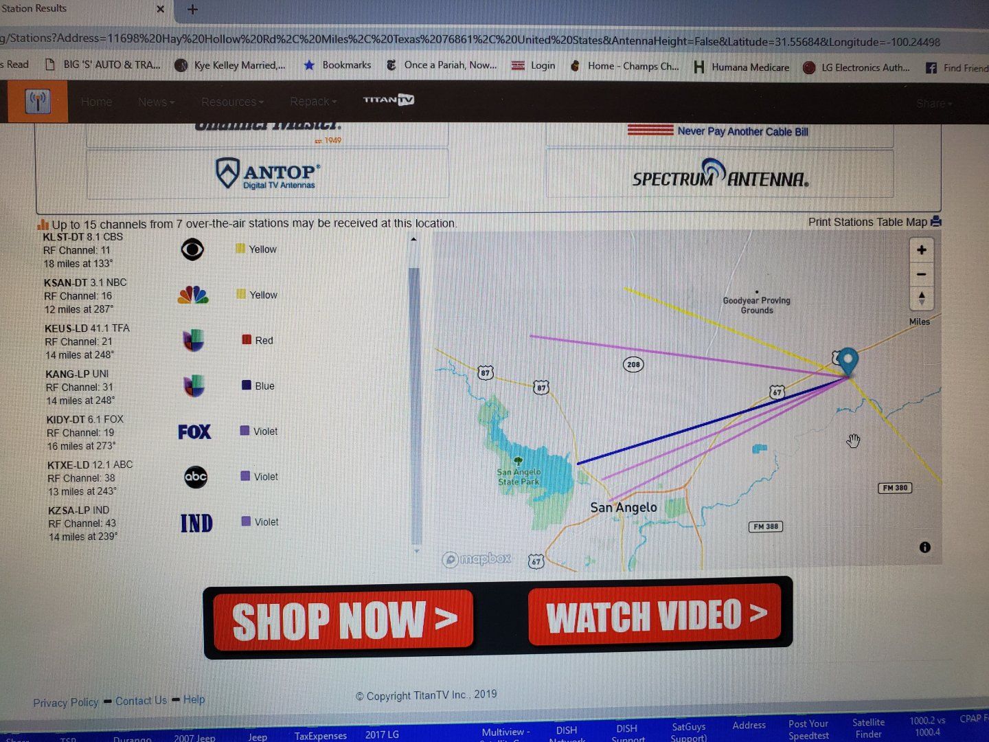

My daughter lives outside east of San Angelo Texas and has a Hopper 3 system. I thought I would install for her an indoor OTA antenna for just back up when they have satellite signal lose. The TV stations are westerly from her home. CBS is 133 degrees at 18 miles away. FOX is 273 degrees at 16 miles away. All the other channels fall in between them. The Hopper is located in the great room on the west side of her home. There are no mountains issue that I know of. What do you think?
All the channels are line of sight but with the wide spread of stations (almost 180 degrees between the west and southeast).

Thanks Jim5506. I think I will get it at Best Buy. They are easy to return things. I think I will also get a little in-line amp too. Attached is the info from Antenna Web.
