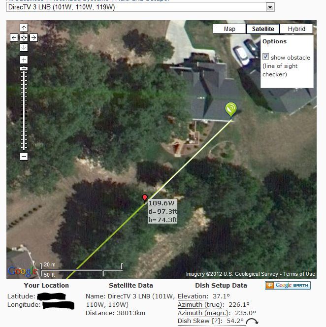

Thanks for all the replies, definitely helpful info. To anwer the questions, trees are the LOS issue and the 45' roof is the only spot that they or I can identify as having clear LOS. Pole mount isn't an option because I'd lose so much elevation that my deck and the trees will be right back in the way. Any idea if it's possible to mount half way up just on the side of the house? If so, I think 25 - 30' up should be high enough. The roof is aesthetically preferable, but in the end I don't really care as long as I get signal. Alternatively, yes the roof can be accessed from about 20', but would require walking on a pretty steep pitch to get to the optimal corner. I have no issues with heights whatsoever, but even I probably wouldn't take the risk, so I'm sure an installer wouldn't either. For reference, here is my house and potential location, anyone notice something I may be missing? Capture.JPG
One thing may be of some help. Your local sd channels are on 101, so you don't need to see the 119 satellite. They would install an dish that would get 99, 101, and 103. Check the los for 101. The hd sats flank 101 pretty closely, so you don't need a big area for the dish to view.
that might be the trick, the installer did mention that I could get most everything except 119 with an easier install, would this just mean no HD locals? That might be a deal breaker for my wife, but worth thinking about. I take it 99 and 103 are the non-local HDs?
All of the hd channels are on either 99 or 103. Locals are on either 99s or 103s. Nationals are on either 99c, 103ca, or 103cb. Your local hd channels are on 103, transponders 21 and 22. Apparently you also get WDBJ, WRIC, and WSET, all from Richmond. Those are on the 119 in sd, but they aren't listed on the Directv website as part of your locals. They may be what is call significantly viewed channels that in some areas are offered to neighboring cities. Funny though, they don't show on the Directv website either as sv channels. They are on the chart that is kept on dbstalk, which is a very detailed listing of who gets what channels. The bottom line is you should call Directv and see if those three are offered in your area or not. The reason for asking is if they are, Directv MAY require a 5 lnb install in order to get the 119. That would mean you would have to go to a local independent installer to get a 3 lnb install. Either way, let us know what Directv tells you about your locals.

Thanks for all the replies, definitely helpful info. To anwer the questions, trees are the LOS issue and the 45' roof is the only spot that they or I can identify as having clear LOS. Pole mount isn't an option because I'd lose so much elevation that my deck and the trees will be right back in the way. Any idea if it's possible to mount half way up just on the side of the house? If so, I think 25 - 30' up should be high enough. The roof is aesthetically preferable, but in the end I don't really care as long as I get signal. Alternatively, yes the roof can be accessed from about 20', but would require walking on a pretty steep pitch to get to the optimal corner. I have no issues with heights whatsoever, but even I probably wouldn't take the risk, so I'm sure an installer wouldn't either. For reference, here is my house and potential location, anyone notice something I may be missing?View attachment 79710
IF you can get on a "walkable" roof many things are possible. Even on a steep roof it is possible to use rappelling gear ( read rope through mail slot of front door and run to belt of installer). One of the things that could work is called an NonPenetrating Roof Mount (NPR). Think of a small sled with weight and a place to mount a mast and dish. It could sit on the ridge of the roof. And yes, a dish can be set on the edge of a roof...gotta find a stud, bro! The concept that guides all this is the need for the tech to be able to work from aloft without going over the edge. The forty foot ladder or a forty ft elevation off the roof produces the same effect if the tech goes down too fast, FOR (Fell Offa Roof)
