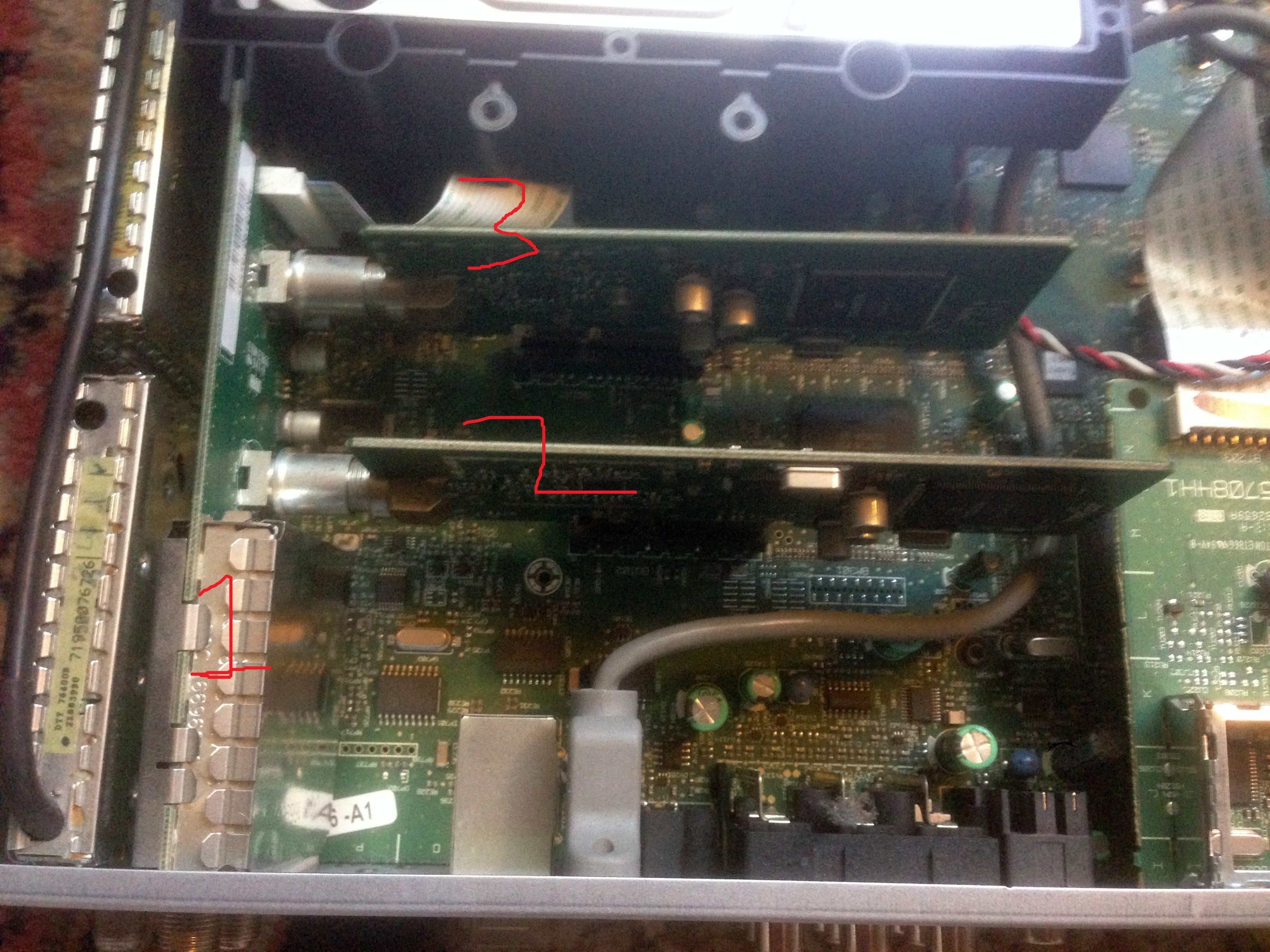

Since they've already told me they dont want it back if I replace it with another HD DVR ~ I ended up popping the hood and cleaned out all the dust inside the box. Re-seating the Tuner boards & noting the part #'s for replacement. (it's been working well for days now) There seems to be 3 boards for the Sat inputs. A main & 2 daughter boards. Hard to tell if it's the main failing or one of the other 2. The secondary boards look like they plug into the main like a coaxial connection. I've looked at cheap HR20-700s for parts but they have a different input orientation. So I assume the boards are different. (I have a -100) Picture attached..
Is one of the boards for the OTA ?
The - number designates who built it ... back then they were Pace, Thompson (rca) and one I can't remember .... they were like -100, -500 and -700 from what I remember.
I wanna say -100 was RCA originally.
The 2 silver boxes on the left line up with the OTA tuner input..
The tuner boards I re-seated into the main board had Thompson chips. Since I cleaned everything & re-installed the boards - Everything has been working great.
The tuner would fail every couple of days ~ Now it's been good since Saturday..
