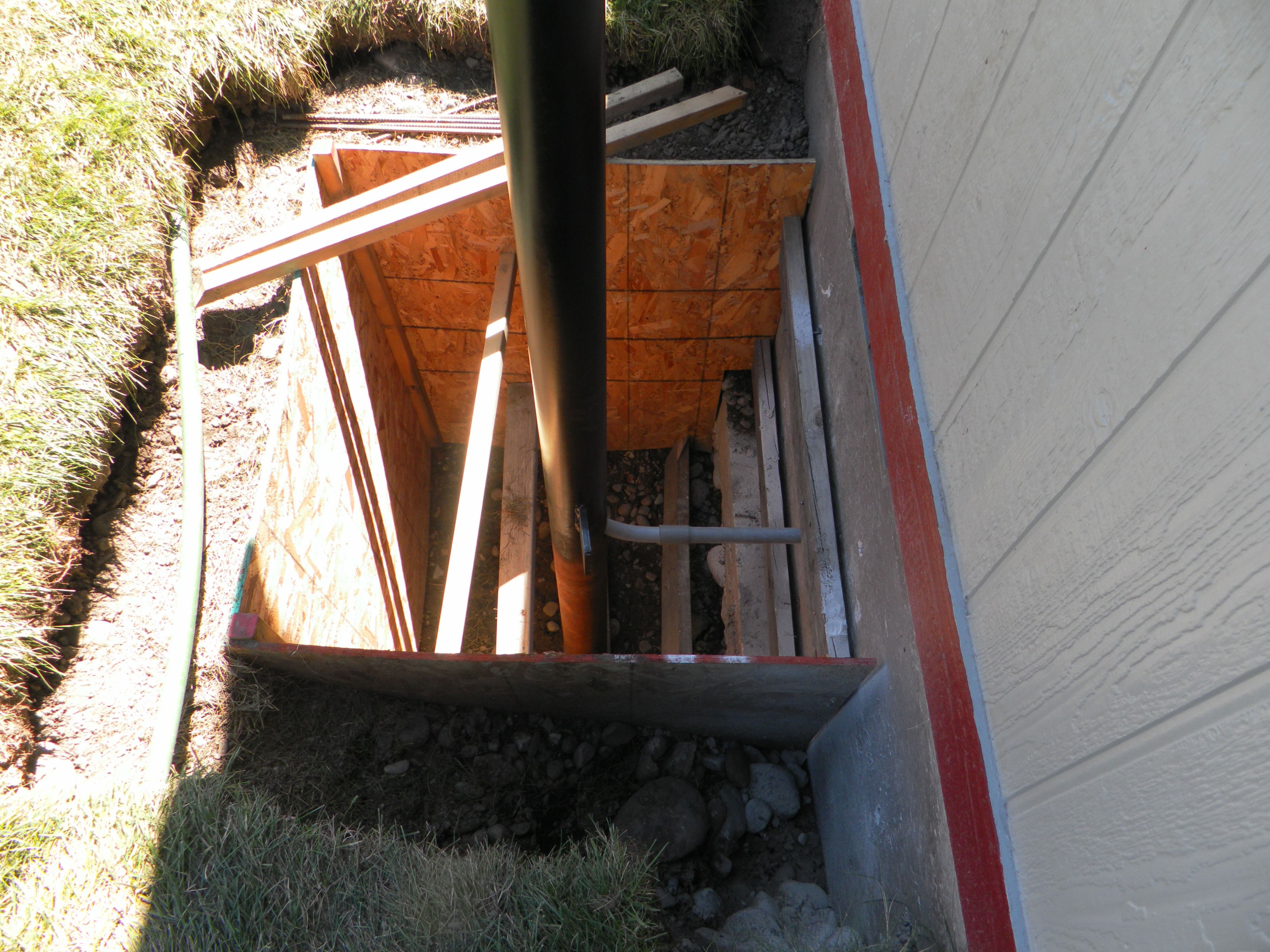

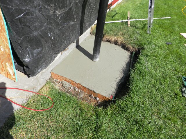

Installation is different according to to region of the country you are installing in. Out here in Western Oregon we don't have to worry about the ground freezing or high wind loads. So while it may not be copacetic, I have seen 1 5/8" poles (with the lower end flattened) driven with a fence post driver that have worked for many years. You can drill a hole through the post and put a tight fitting 3/8" or 1/2" bolt through it, as opposed to welding a rebar onto the mast, just needs to be set at the correct height so that is immersed in the concrete.

magic, I put that kind of a foundation in for my 62ft ham radio tower! You must have had the neighbors all watching you dig the grave...
