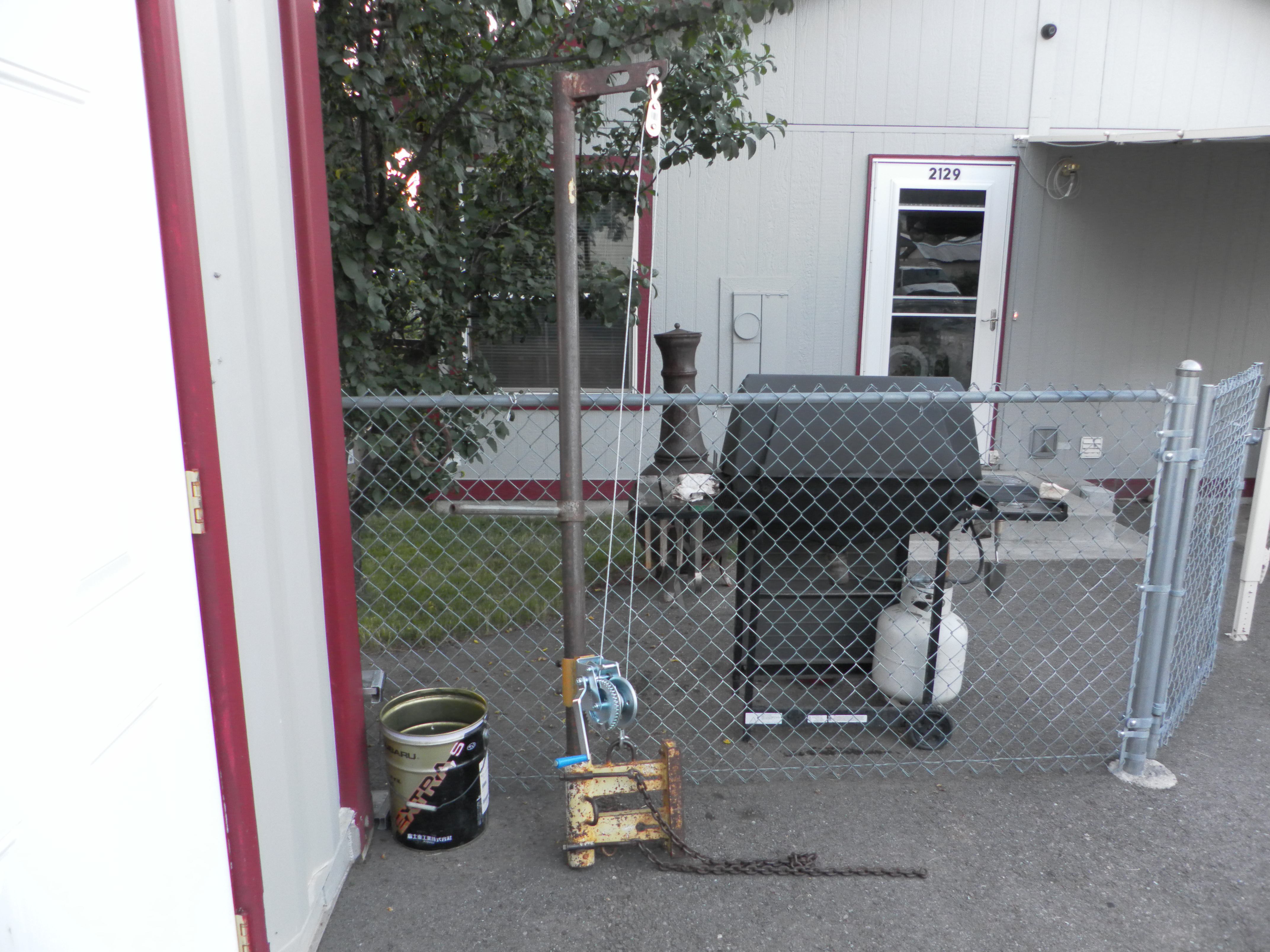

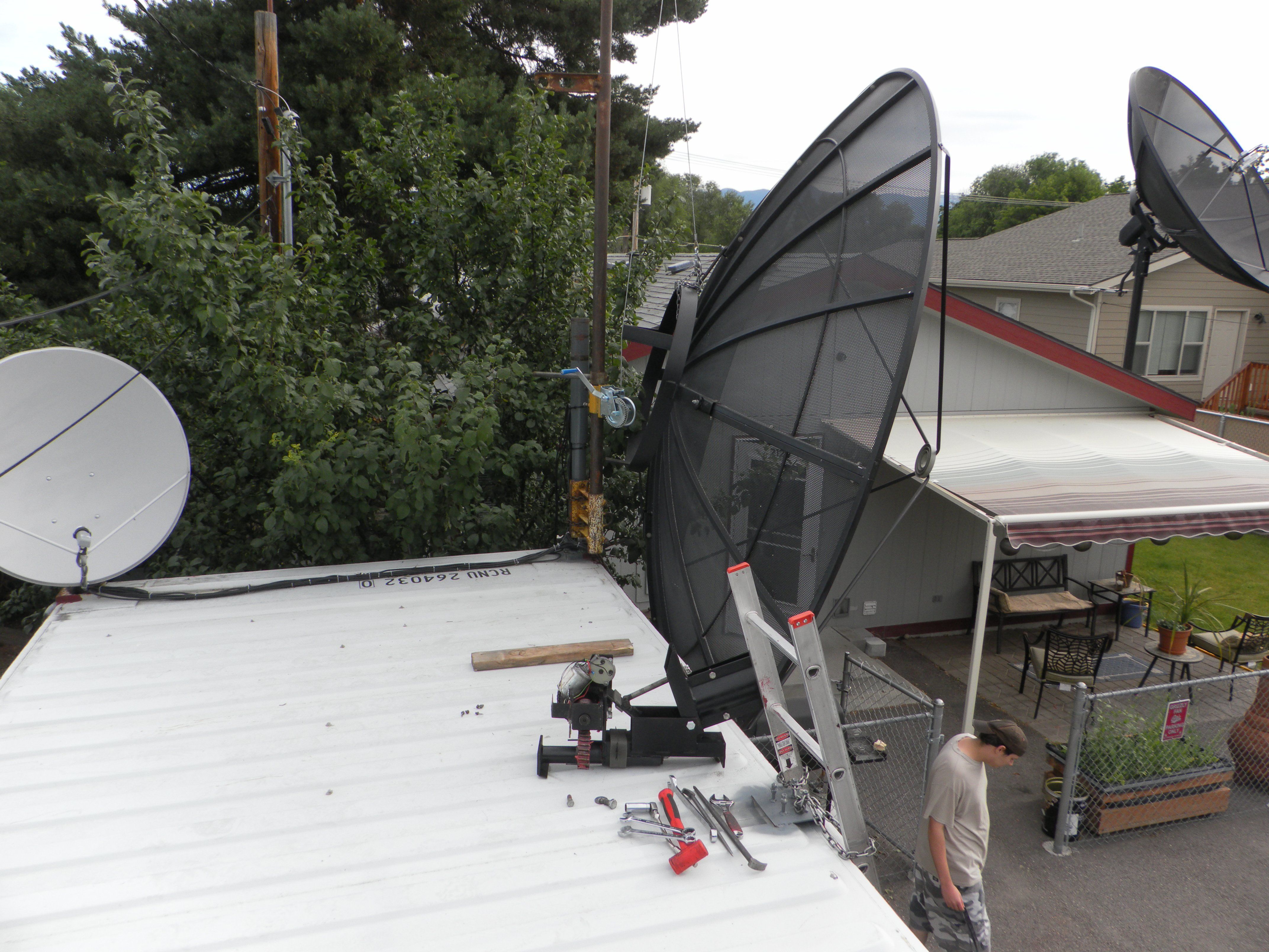

What in your estimation would be the smallest functional C band dish and what approximately do you think the weight of that animal might be? Just thinking ahead...... If I did find one that someone might want to let go for a reasonable price, I'd probably need to man handle it myself. So, I don't think I'd be able to do a 10 footer...
A guy can do these BUDs by himself if needed. I have a "Dish Lifter" :) Ten footer no problem
