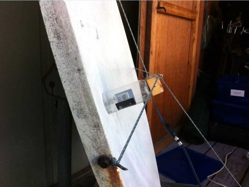

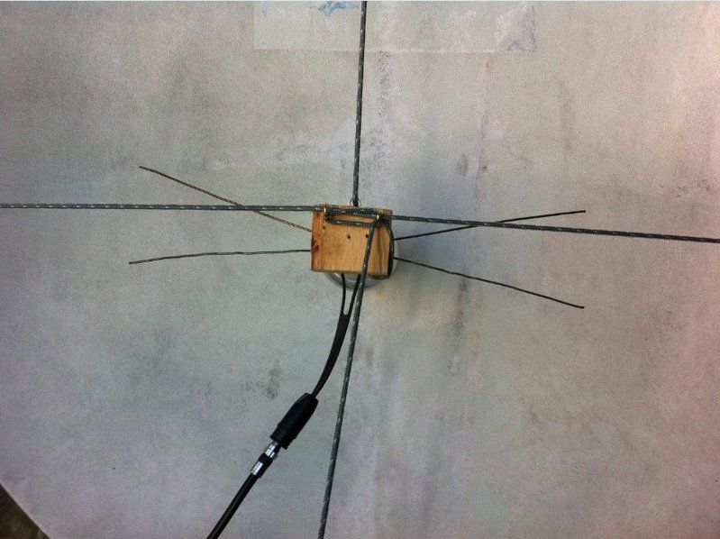

It may be ugly, but here's my fix:
1: Set up the 1M dish on its NPRM and aim it north.
2: I took our last wire coat hanger and turned it into a bow-tie antenna.
3: Tried putting the bow-tie at the dish's focal point, watching SDRSharp to see how it improved (if at all)
4: Eventually, putting it nowhere near the focal point for the LNB worked.
5: Use a couple hooks and some skinny rope to hold it in the right spot, plus half a water bottle to push it out a bit. Getting a constant 35-40 on the TV (Heck yeah, Curious George!)
Of course, pictures!
First, the antenna:

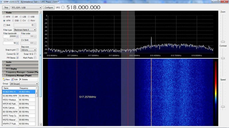

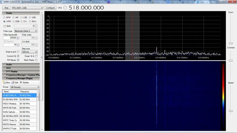

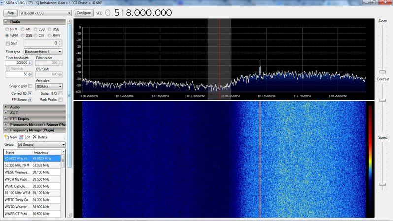

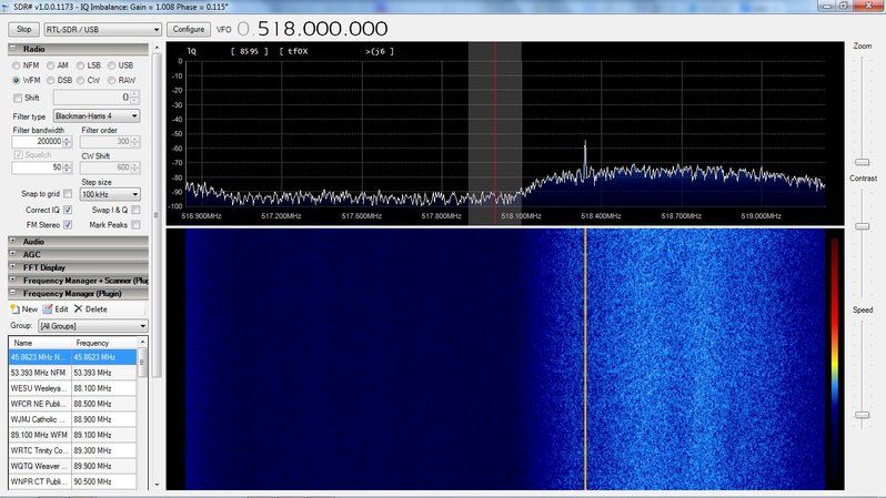

Next, a few screenshots from SDRSharp. (1) is at the focal point (no amplifier), (2) is at the focal point with amp, (3) is the final position. (4) is the DB8 that I've been using for a while. Apparently the little bit of noise is enough to kill the signal.

Dish is operating as a reflector approx 1/4 wave behind the active element. Should have great F/B ratio. Think the frequency is too low to use the actual focal point.
