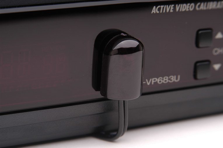

someone can correct me if i'm wrong, but i thin any IR extender will work. check the usual sites for A/V gear and you will see a IR extenders. Just look for one with a good review and it shoudl work fine with you HR34.

Was looking for one that plugged into the box though. Like how the TiVo unit is.

They won't plug in, but you can attach them right to the HR34 box. You could make it look very clean if you do something like this-
I recently had to install an IR Repeater at my Mom's house since she had to replace an old Legacy RF receiver with a D12 IR box. Since there are no RF SD boxes available from D*, I needed to use an IR Repeater since the D12 signal is routed to multiple rooms.
I bought a couple of these from Monoprice.com . So far, they're working good.
http://www.monoprice.com/Product?c_id=109&cp_id=10110&cs_id=1011009&p_id=9194&seq=1&format=2
Mom's house is a one-story home but these should work ok in most home setup distances.
