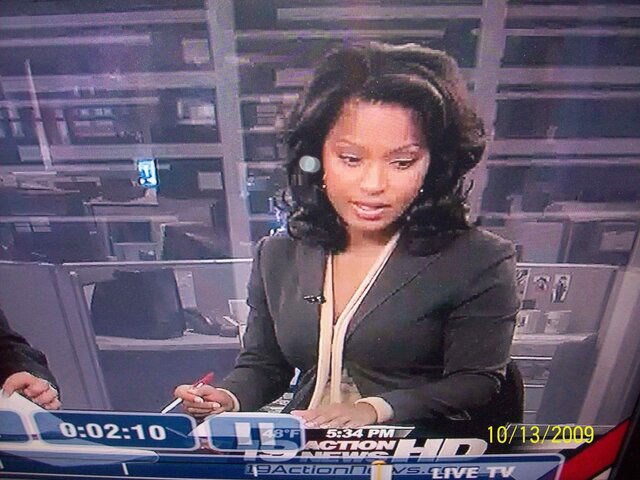

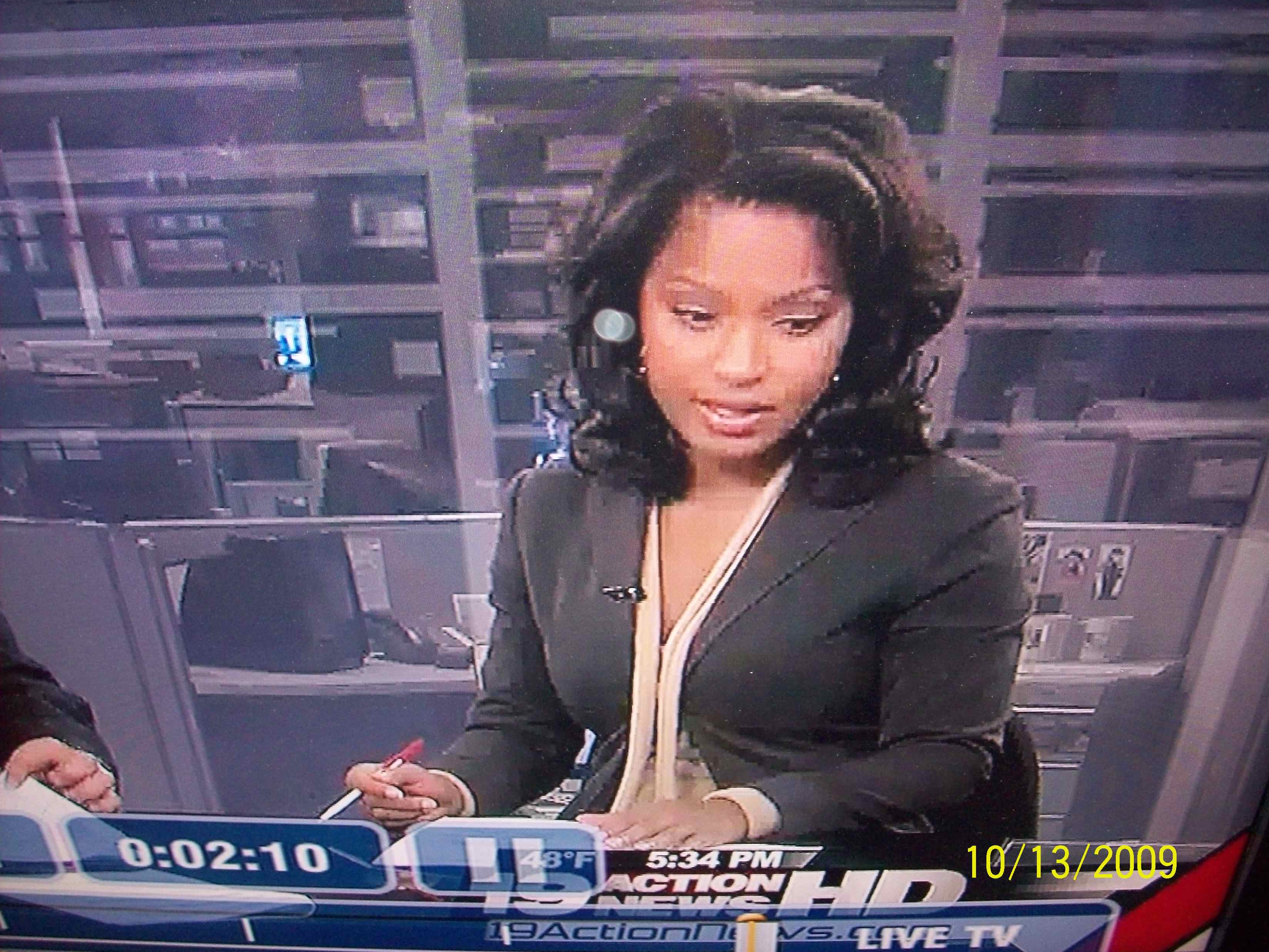

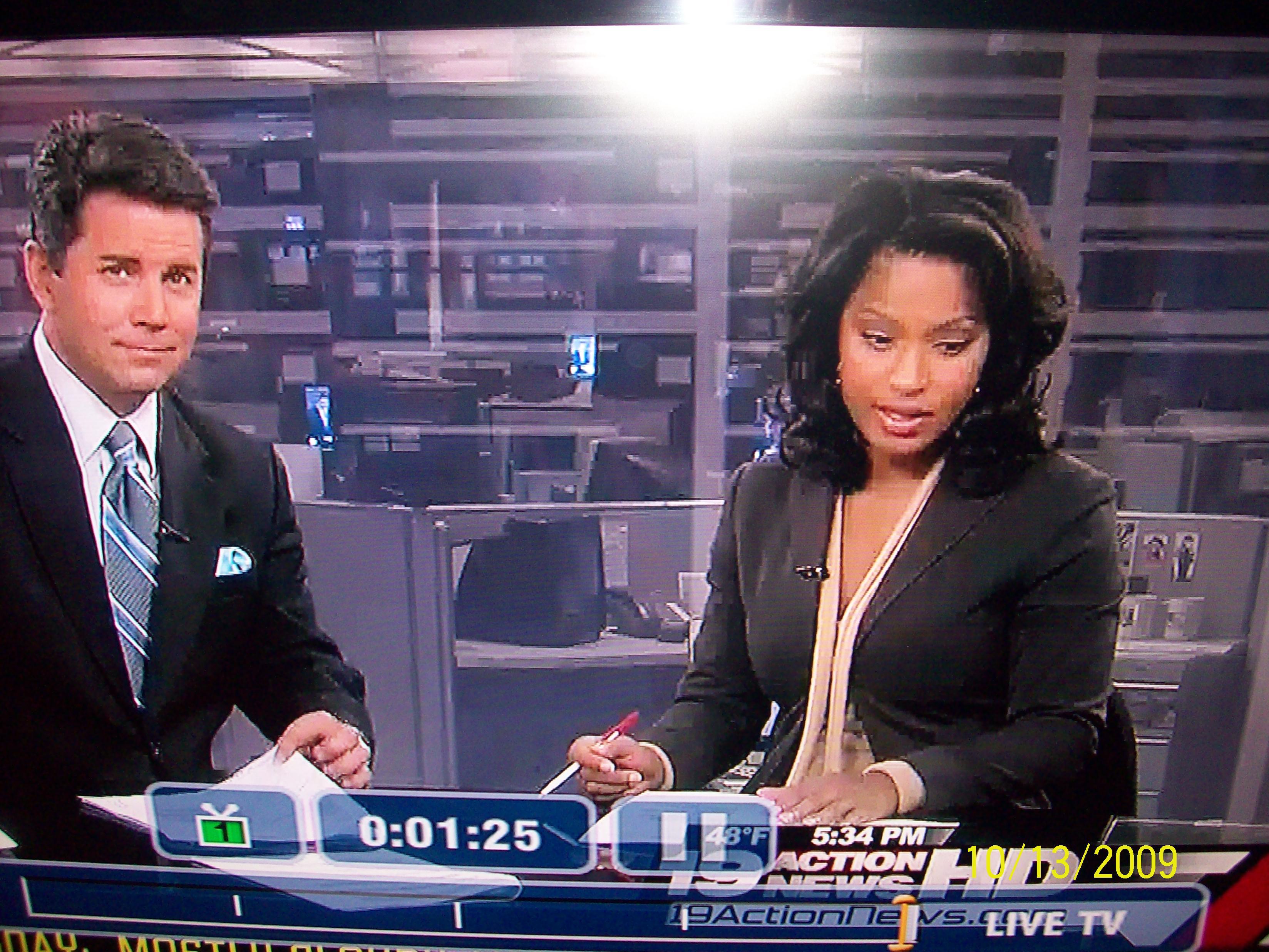

When I had red zone free preview, The hd feed was amazing. My cbs feed (same game) was crap
here is a pic, look at her face

Yes, it sound like they have a poor encoder or allocating too much bandwidth to their subchannels or both.
Yes, this is often the case: a local problem with how the local broadcaster is doing what you said. For a while KABC primary HD channel looked awful when they put an additional HD channel at .2. The sad thing is that everything with OTA is now legacy, meaning that they are stuck with MPEG 2, current modulation scheme, and, AFAIK, can't use some of the latest (and soon to come?) turbo-coding. And I won't get into the ATSC vs. DVB-T matter. Anyways, the sub-channels can look pretty bad no matter what and the primary HD can look a bit sad, as well. Although the bad sub-channels look better than the internationals at 118. We can't go out and replace all the OTA technology in all those HDTV's. We're gonna be kind of stuck quite a while.
