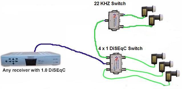

Gary Z SatelliteGuys Pro Original poster Jun 27, 2005 942 0 Seguin, Texas Mar 11, 2009 #1 Does this switch setup look like it would work? Attachments 5LNBA.JPG 19.8 KB · Views: 216
USDownlink SatelliteGuys Pro Mar 19, 2008 352 16 Oregon Mar 11, 2009 #2 It sure does, presuming the LNBs on the 22kHz switch are standard and not universal.
turbosat SatelliteGuys Master Dec 26, 2006 9,003 82 Oneonta,AL Mar 11, 2009 #3 Thanks Garyz that is almost the same as I just asked in another post. Guess I'll wire it up Wed and see what happens!
