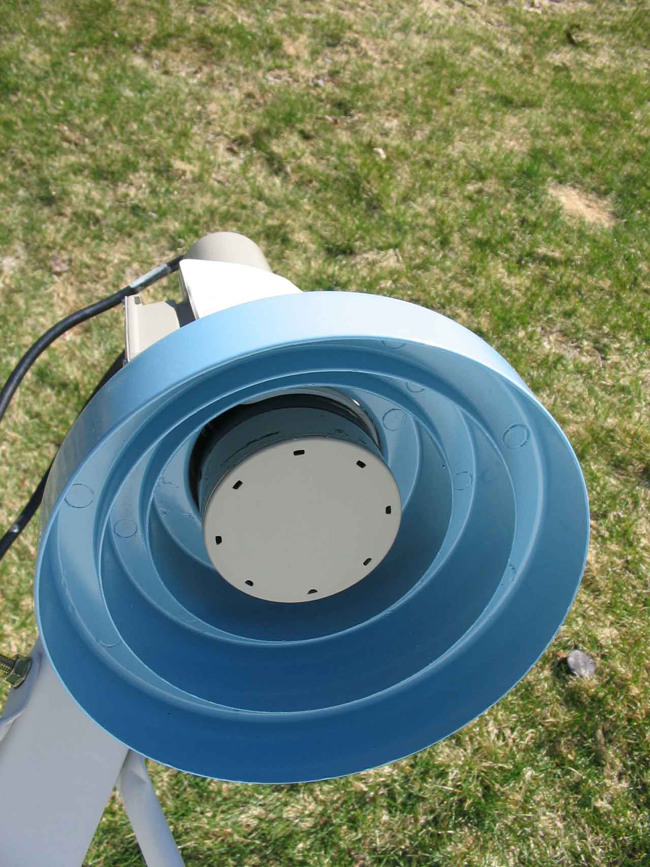

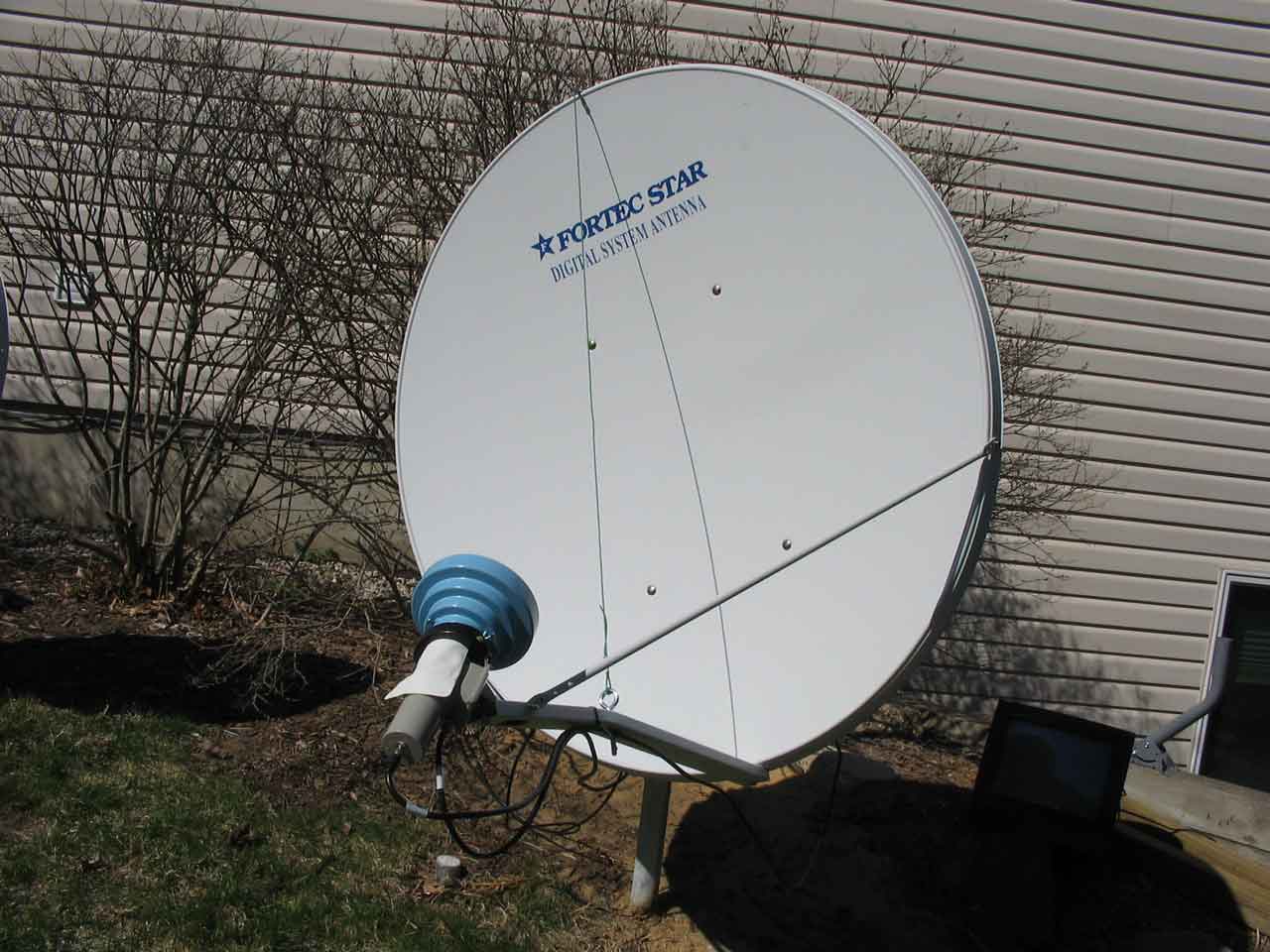

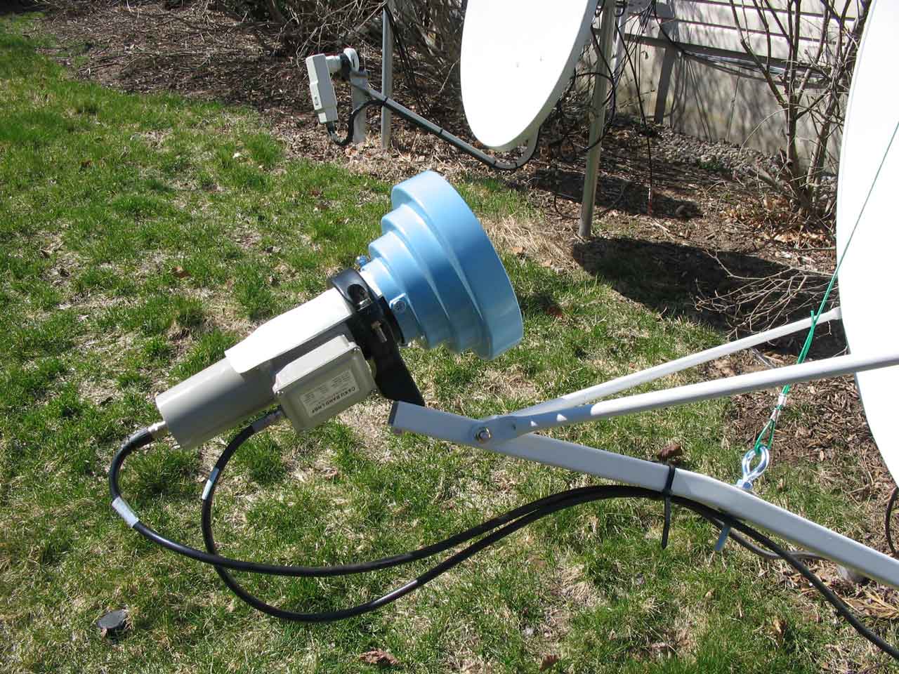

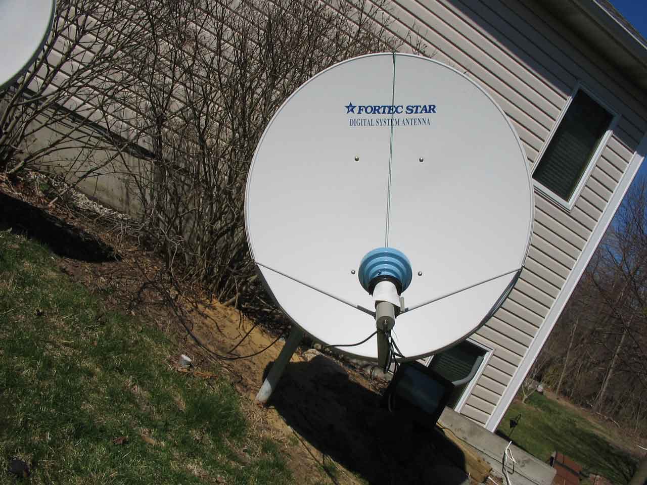

I just touched up my setup with the conical scalar, and added about 16Q points on a Merc II) to my previous numbers.
I started out watching Sportstime Ohio with a Q of 27-32 . Adding the conical scalar, and adjusting the lnbf position more forward ( to give a lot of scalar adjustment room), then adding the conical scalar ring brought my top Q range up to 43-48 ( fluctuating, of course) . My pic was solid even at the lower range.
Attached pic show the distance from the end of the lnbf that seems optimum right now for the scalar, and also shows some electrical tape and a pocket protector to shim the tapered feedhorn so I could clamp it. :)
