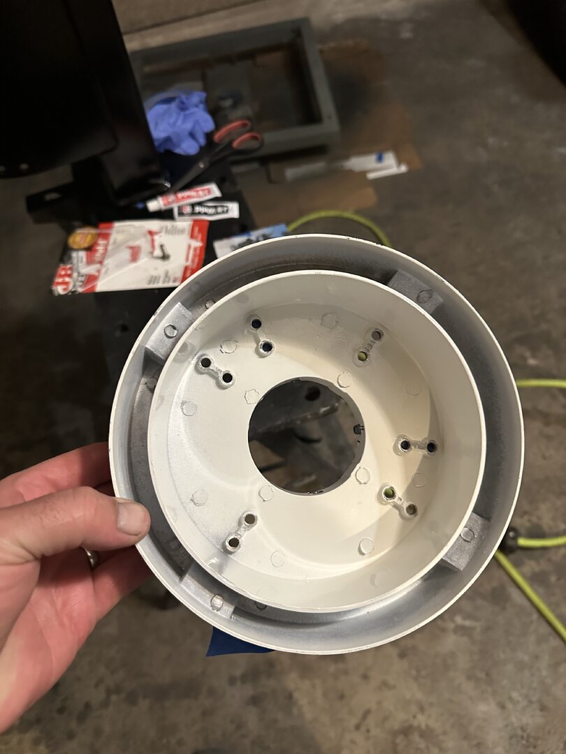

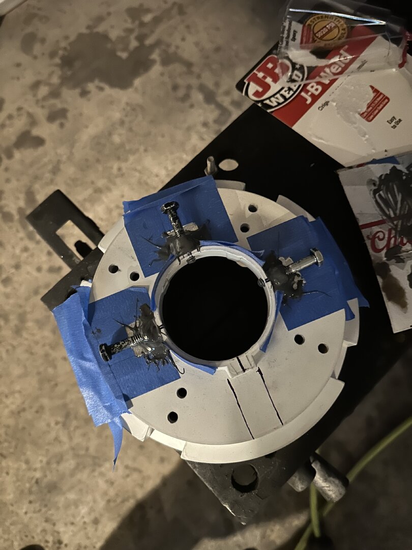

Here is the scaler ring I am using.
I've found it to be helpful on my Oribitron 8'.
I found the apparatus to be "loose" to the point of having to use 3M Super 88 to "build up the surface" of an LNBF to mount and have any sort of precision.
Hopefully this helps.
