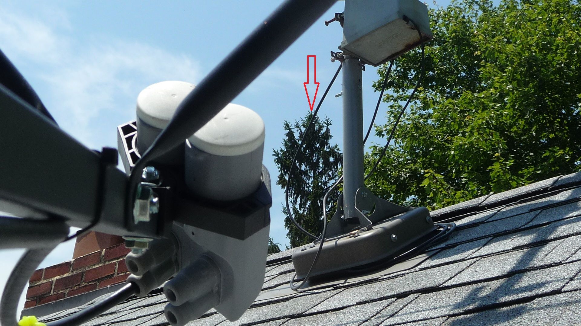

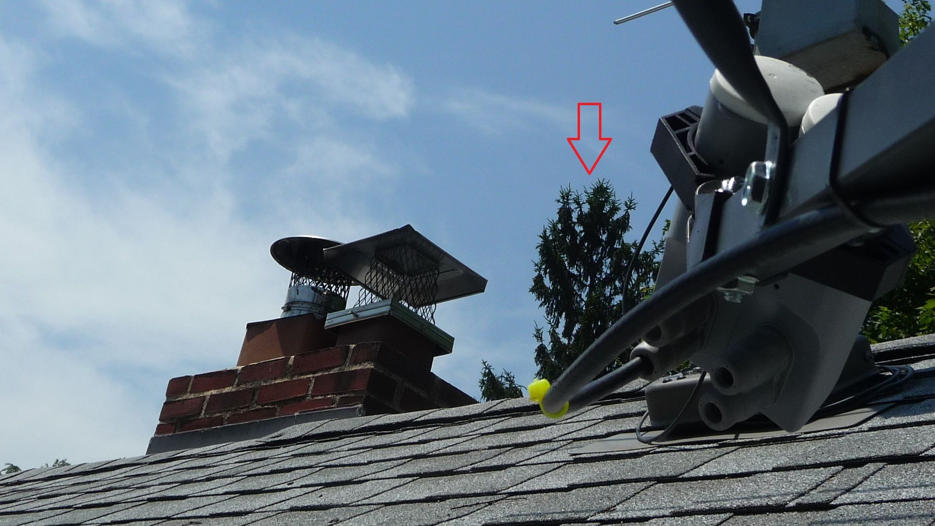

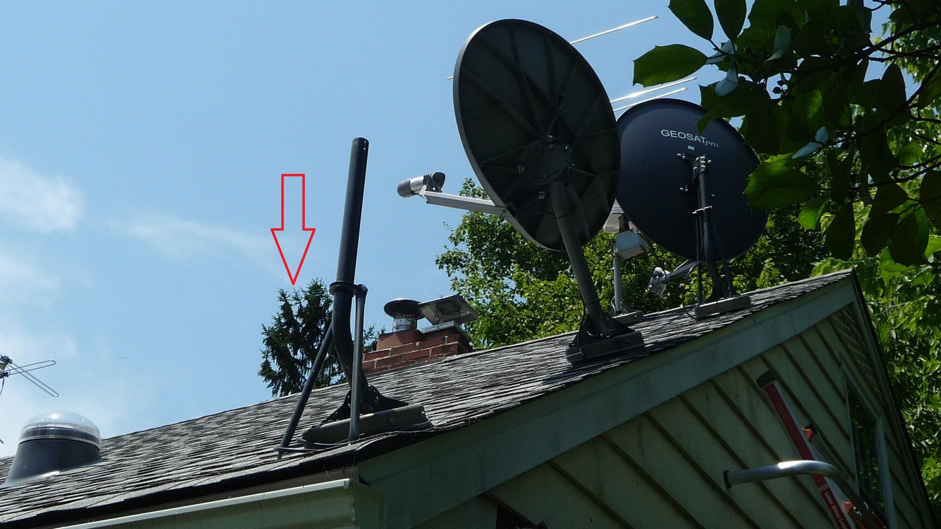

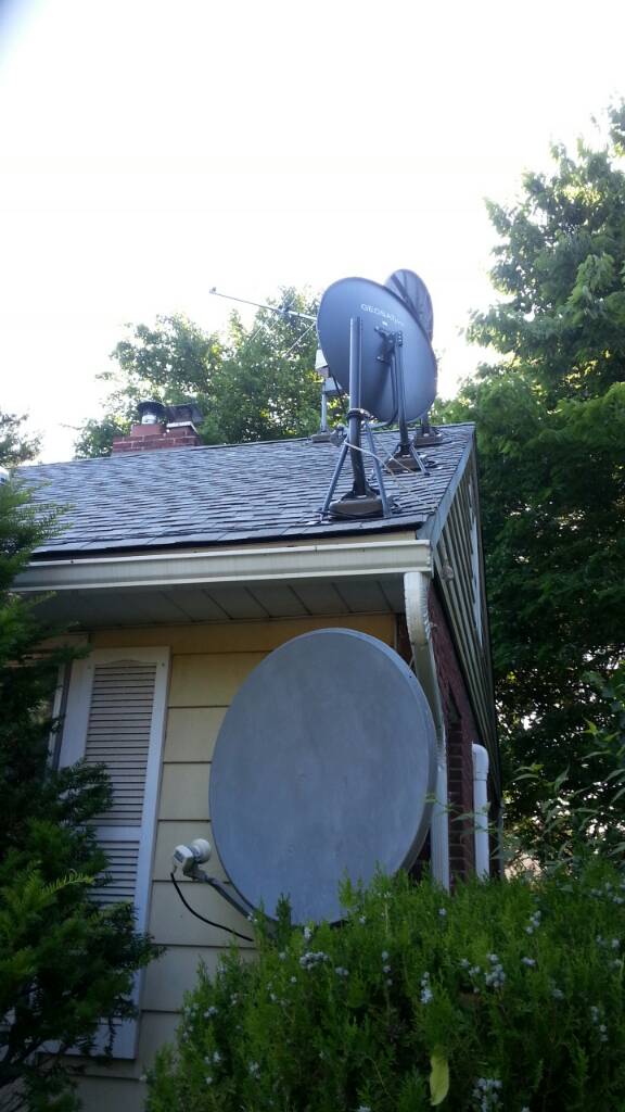

So, when I had my roof done last year, I had a few CommDecks installed. This week, I decided to brave the heights and do some fixed dish installation.
Top one is a 75e aimed at 97 w. No problems there.
Second one is a Geosatpro 90 with two lnb kit for 121 & 125. I had the pole plumb and found 121 without too much trouble. I moved the dish down and rotated, and got a transponder on 123. But I could not get a lock on 125. I know there's a signal of sorts, as my micro hd hovered at 0 - 10% on 125.
Is it at all possible that my 97 dish is in the way of 125? I can swap locations if needed.
But I strongly suspect my trees are prohibiting reception at 125. Pictures attached, and input is much appreciated. Thanks!

I should add that the pole isn't plumb in photos. I couldn't drop elevation sufficiently to the 23 degrees area necessary for 125. So, I tried to compensate. Still no dice.
Hard to tell for sure, but it sure looks like a tree problem.
I'd be willing to say it was the trees if not the chimney.
It looks from the picture that it is pointing more than 2 degrees down.
From what I can gather, the factory dish offset is 24.62 and the elevation of 125W is 22.3 (arbitrarily using Level Corner, PA as a reference).
Since the difference is 1.4 degrees and you can get 123W, I would hope that moving to the upper deck would buy you the elevation you need to clear the trees this year.

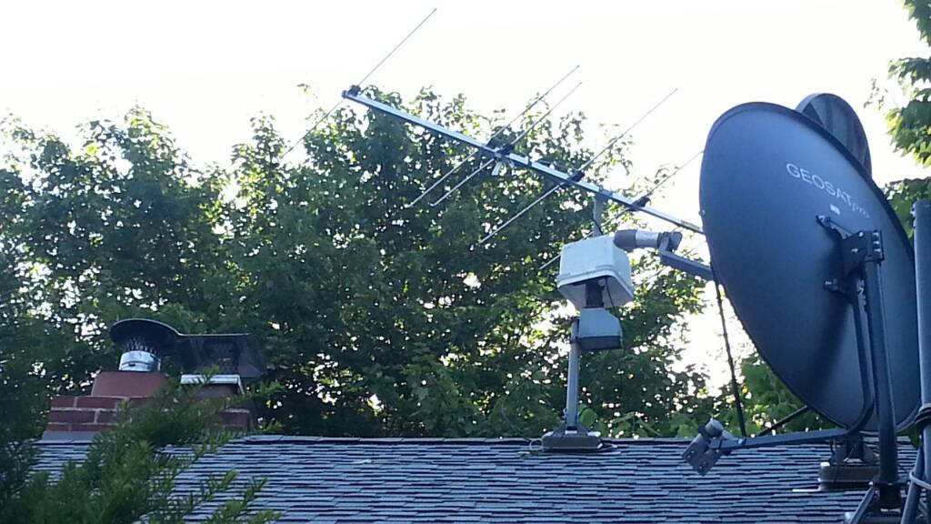

Kinda looks like a tree problem but I would also swap those 2 dishes. I would also mention you could be having a reflection issue with the OTA antenna. Reflected/deflected OTA signals can cause all sorts of issues. My 7.5 C-band dish sits approx 100' in front of, and approx 20' below my antenna but if I'm watching OTA and move the dish at the same time you can see it affecting the OTA signal and there is one position of the dish that really whacks the OTA signal. Not saying it is your problem, or part of it, but it's possible. Try tuning in an FTA channel as best you can then rotate the antenna while you're watching the TV. See if anything changes.

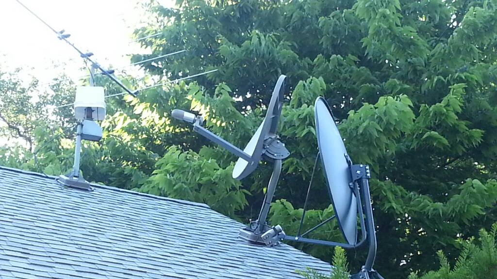

Okay, I moved the 97 75e down one position. (By the way, CommDecks make things so easy and neat.)
I can get 121 on the main position, but not on the sidecar. The 123 bird is no longer coming in...only a hint of signal up to 10 percent.
I'm a bit reluctant to move my am and fm antenna stack visible in the photos, as it's the best height I have for fm, which is a priority for me.
In the photos, my tree is the maple. The pine or something evergreen belongs to my neighbor. I'm thinking that there is no chance of 125 with the trees.

I have a 76 cm dish that I think I'm going to use up top for 121. Save the 90 for something weaker.

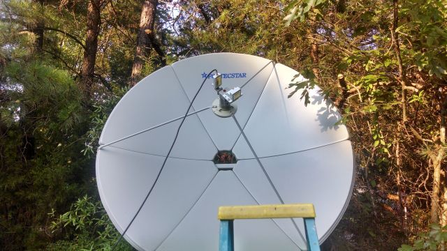

Well, that didn't work. Weird. 76 cm dish had no hint of signal at 121. So I'm back with the 90 up on top. Plan b for pbs might be a mini bud with the Andrews 1.2 I have in the backyard. I know 103 is visible from there.
Well, I can only conclude now that the growth of that evergreen tree, which unfortunately isn't mine, has cut off 125 quite effectively. That rather stinks. Once upon a time, I was able to get 125 with just a 75E down closer to the gutter, but things have changed.

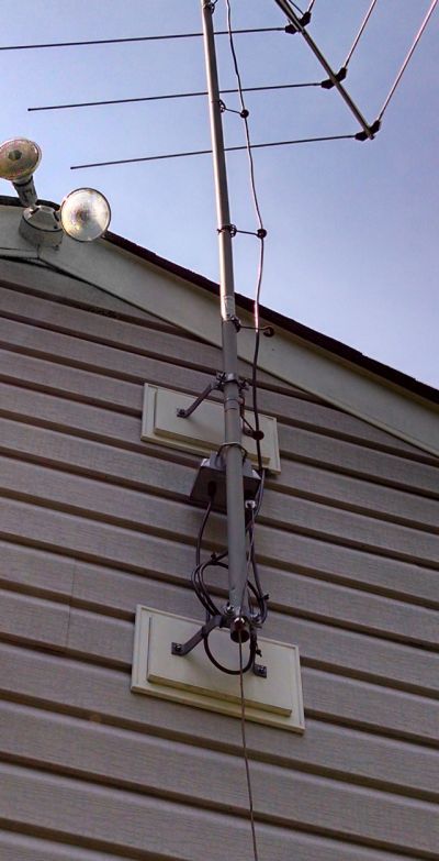

Here is the mounting I used for my OTA antenna.
Same principle could be used for a dish.
The antenna is about 6 feet above the peak of the roof.
There is a fixed 1.2m dish on 125W here and except for brief times during heavy thunderstorms with heavy rain, reception is fulltime (i.e, good reception in clouds or moderate rain).
