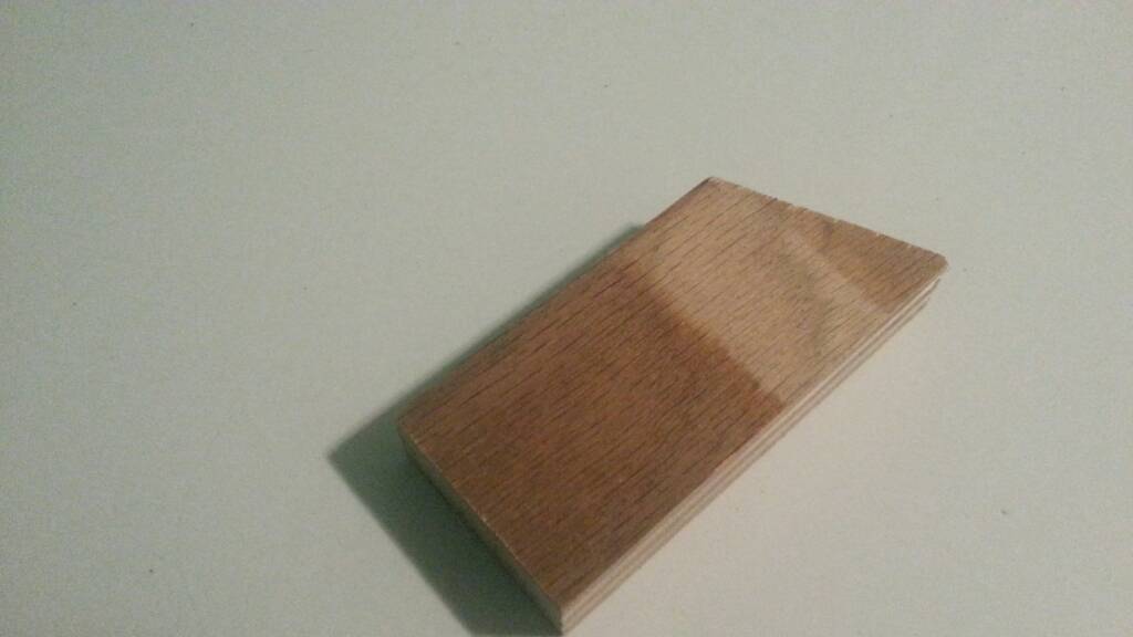

Okay, here's a piece of wood cut to 22.5 degrees. My dish angle per the guide here for 125 is 22.6. And this is a fine example of how ill-prepared I am in geometry and such. I'm unsure how to hold and sight it.

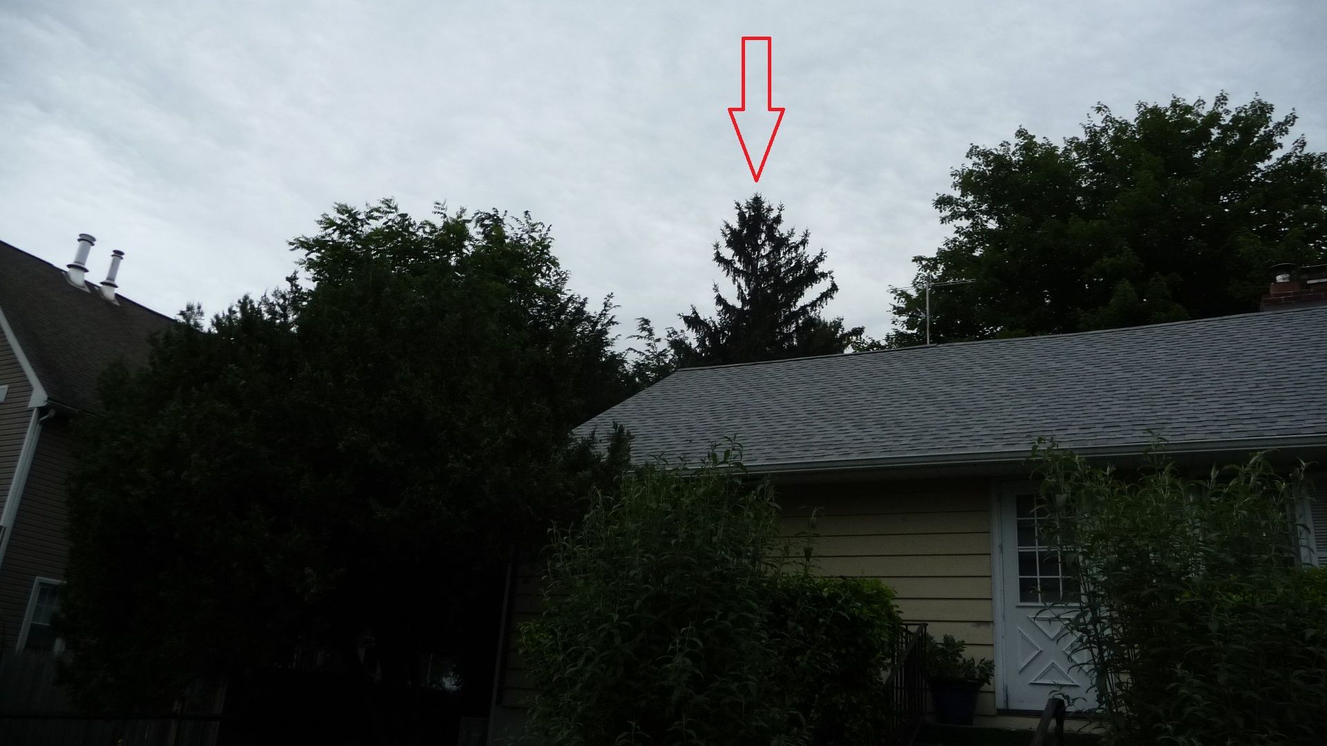

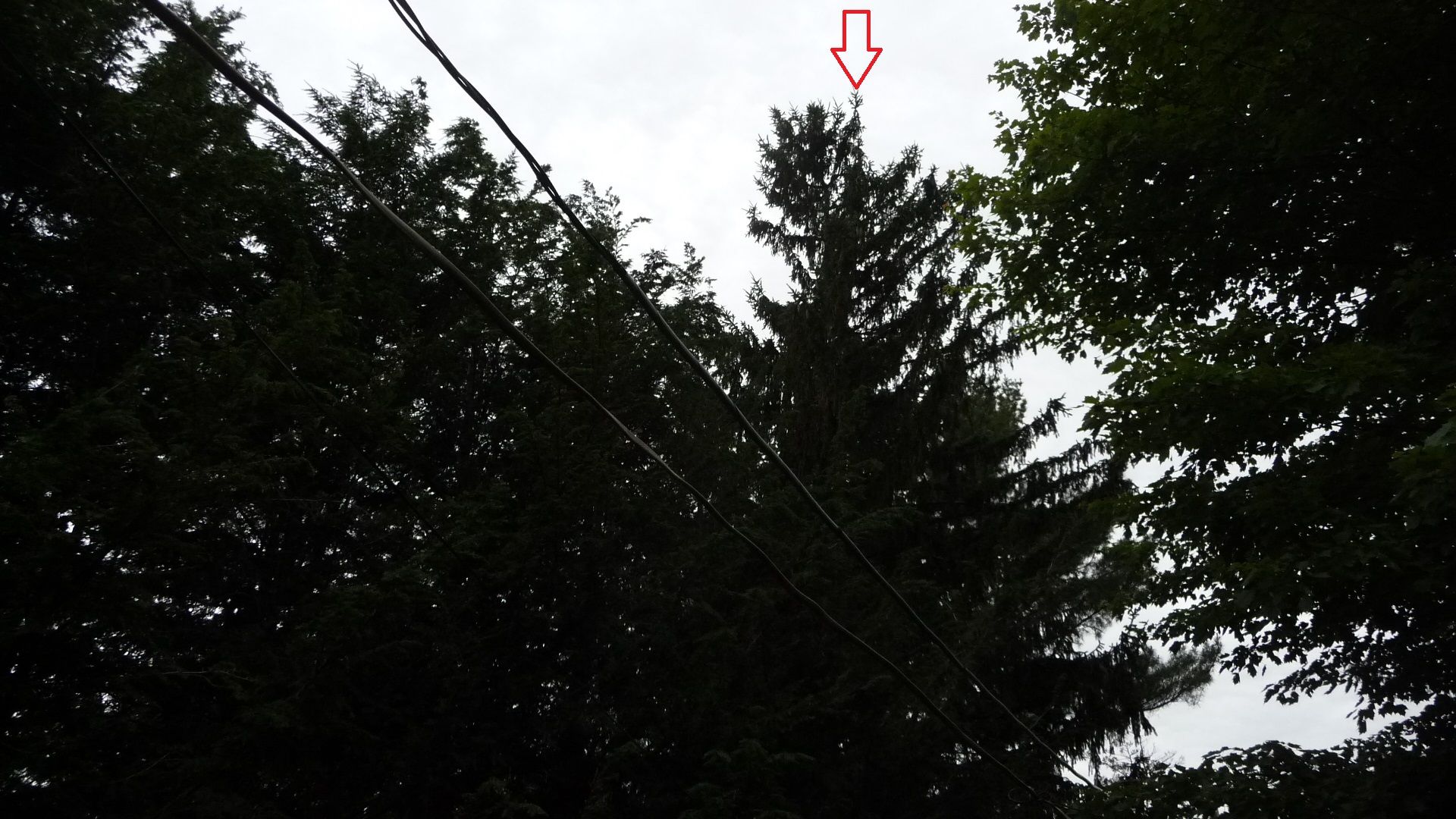

It's not looking promising to go south and look around that big tree. A disadvantage of living in town, I suppose.

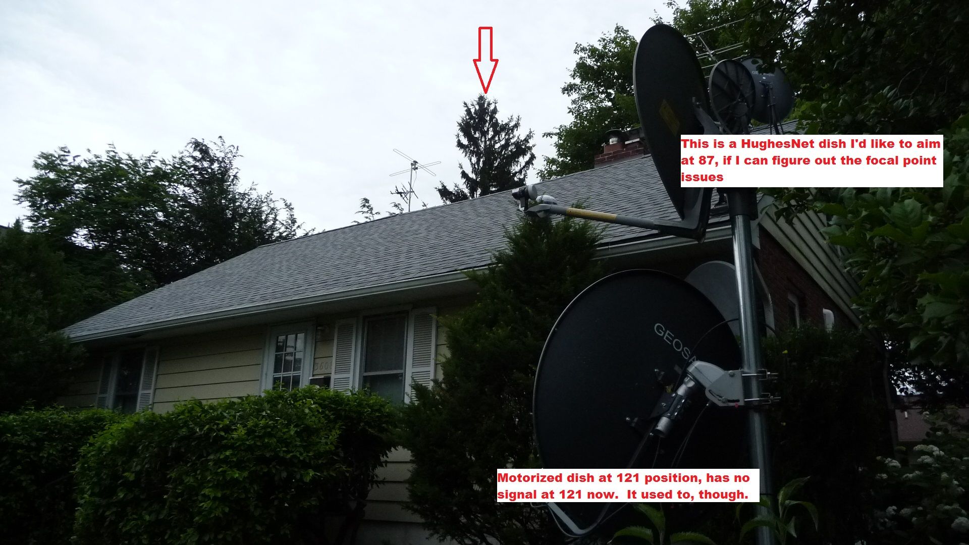

Motorized dish in front yard that isn't seeing 121 at this point. It used to, though.:
This is the view from the sidewalk in the front of the house. South end of the roof doesn't have a Commdeck as I hadn't planned to need any sighting from here. Obstruction tree is again marked.

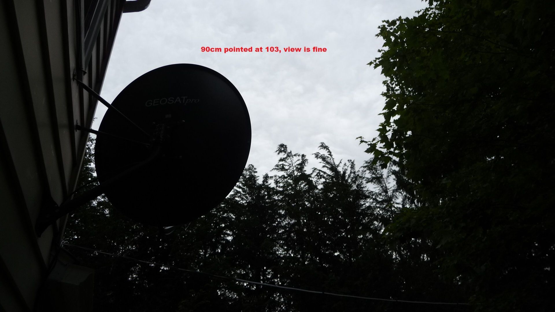

And here is my fixed 90cm on 103 in the back yard, with a fine view. I haven't done exhaustive testing, but I know that 97 is visible from ground level in the back yard too. I'm potentially looking to do 103 C on a mini BUD if 125 proves to be elusive.
I really appreciate all the thoughts and suggestions.
Hold the long edge away from you in a vertical orientation in the direction of 125w. Site along the angled cut, which will be ~22.5 degrees elevation. Do this from the dish mount location. You should see any obstruction pretty easily.
Thanks for the picture. ..that's very clear and helpful.
If you are young in dushe.Zalezat on top of the tree and cut down dereva.I not any problems there.
How about I send you some pine bark beetles?
If it is a cypress, I can send you some caterpillars that will destroy it also.

I apparently could have been clearer. No, I'm not crazy enough to try to use the dual bracket on a motorized. (Talk about complicated!) The motorized dish in the front yard at chest level has a single LNBF on it. From there, when I set it up last year, I had good view from 72 degrees to 121 degrees. 123 and 125 were occasionally viewable from the motorized, but I never could get a decent lock. Now, because of that one tree on my neighbor's lot, I believe I'm out of luck for anything on the extreme western side.
Which is why I'm using the dual kit on another GSP 90cm, fixed, on the roof, just for 121 and 125. Hopefully. This weekend I'm hoping to get up there again and give it some more effort. I do have an extra-tall J pole that I'd used for an OTA antenna, which appears to be the same diameter as the GSP mount. Another several inches might help.
