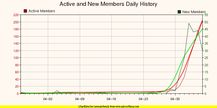

Boy, if you want to see something scary, check out "Team PSM": They have been around since the first of April, but nothing much to talk about. In the last week, they went from 10 members to 206! I have no idea what they did to bump their ranks like that :confused: and why can't we get more SatelliteGuys Folding.
The reason I mention them is they are on target to pass us up in a matter of days. They are generating over 70,000 points per day now. Amazing what 306 CPUs will do for a team...
