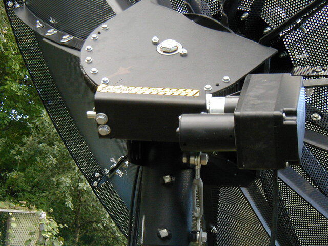

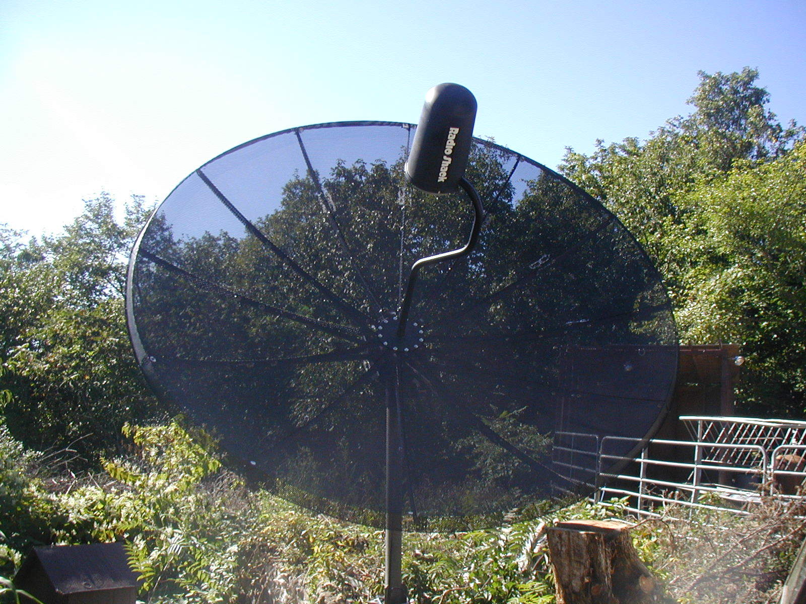

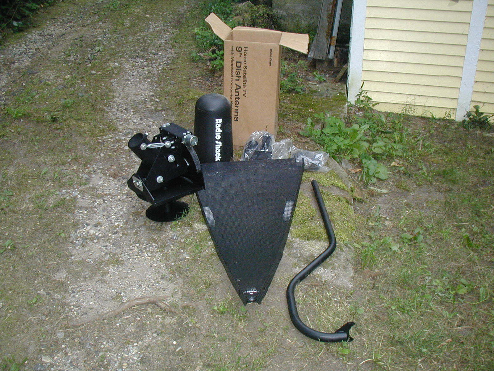

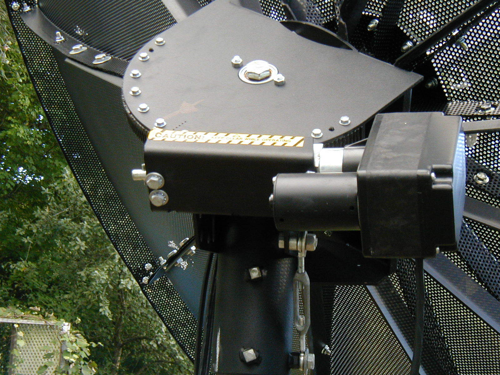

That sounds the same as my dish. Great find, great dish, I love mine! Mine too was brand new in boxes, never used, here's a few pictures.

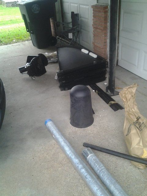

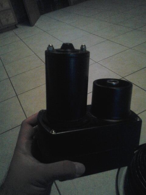

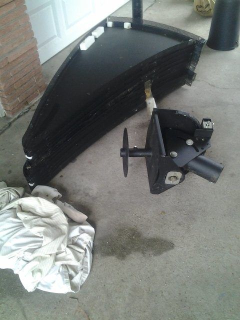

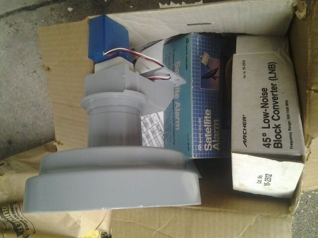

well I picked her up today from the previous owner. The guy was all class and he kept this stuff in awesome condition! I plugged in the lnb first thing to my metet and it worked flawlessly and had never even had the little cap protector taken off til now! Amazing for something 16 or so years old, still shiny like it just came off the shelf.
Anyhow I got home, emptied of the vehicle and here is what I have
20131121_154219.jpg20131121_155043.jpg20131121_155346.jpg.20131121_153938.jpg20131121_153954.jpg
Check out that H-H mount!! That makes me wanna go whack down every tree in my back yard cause I heard that thing can swing 140 degrees!! Also for laughs a satellite alarm, never seen or heard of that before.

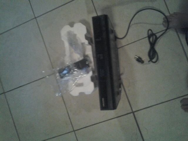

On other notes I opened up the memorex sr-2014 and cant believe it, the dad gum thing wont power up!!! It had never been taken out of the plastic and I tried and tried and even checked for an on/off switch like some recievers have and it doesnt have one. I opened her up and their was power going through the boards but it just would power up, tried remote and it wouldnt power up so maybe I will try to find me another analog reciever to run the motor and slave it to my Microhd.

Yup, that's the same as my dish. Your receiver is different though, think yours is newer, mine is a SR2012. Funny, my receiver didn't work either, it would power up but was very inconsistent in how it moved the dish. I got a V-Box 7 and it's working great with my dish.
If you didn't get the manuals with yours I've got them and can scan pages for you, if you need it. Mine was a breeze to put together, there's a manual crank that you can turn the mount with before you install the motor so you can turn the dish whichever way you want to when you're assembling it.
On mine, the worm gear block was way off from where it should've been, in my manual on page 17 it says to check this and how to adjust it. I'd check yours if it's like mine, on mine the rack gear is plastic and the worm gear is metal, if I hadn't of checked it, it probably would've wiped out the rack gear real quick. I really like my dish, think you'll be real happy with yours!
