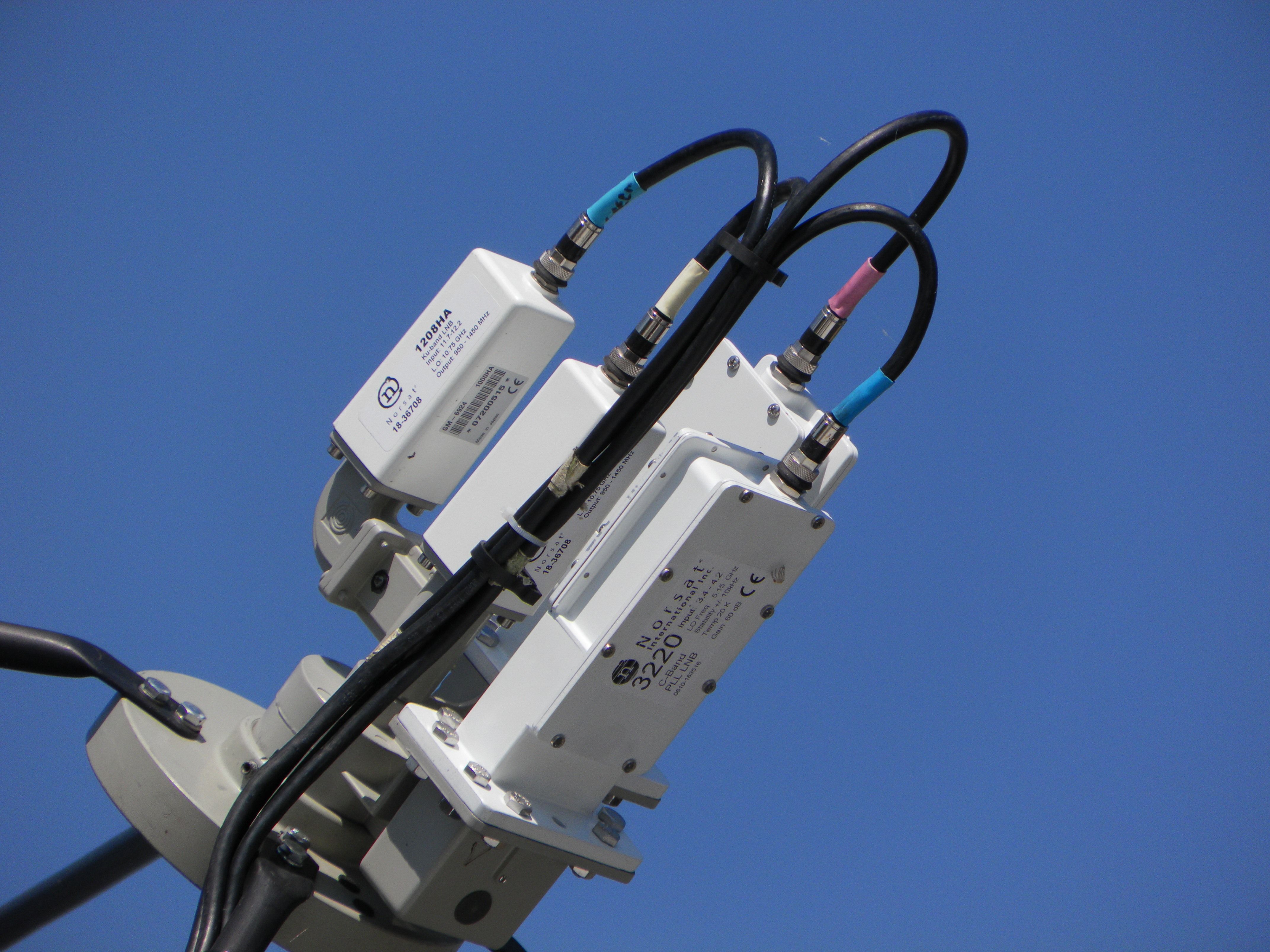

I know performance-wise it's priceless but what does a rig like this cost ?
Way too much! MSRP on that rig is $1200. It took some wheelin and dealin but I cut the price almost in half watching and waiting on EBAY and others.
But those are expensive PLL LNBs, my other dish has DROs that work very well and they have an MSRP of $330 for all 4LNBs The BullseyeII feed can be found for $300 nowadays.
I use a NS741 with good results. I have it optimized for c-band reception and it performs as good as any affordable lnb/lnbf out there on c-band on my 6ft Sadoun. Ku reception is usually not as good as my 1 meter channel master but still very useful and will occasionally pull in something the 1 meter can't.. One click on the vbox can sometimes be the difference in no reception and 90Q for KU.
Magic, do those lnbs come with that rubber ring on the connector, or is that something you added? Never saw them before. How bout those compression connectors too? I like the looks of those, easier to tighten I would think. What brand are they?
