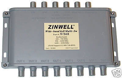

assume you currently have this switch right now?

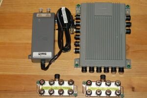

If so they will change it out for this switch

4 lines in
they will hook up one splitter probably for the 2 other DVR's and the HR34 gets its own output on the switch.
The cabling should be fine

Yep the WB68 is what I currently have. And I do currently have 4 lines coming from dish the WB68. This is much better than I thought. I thought they may have to replace my dish and run new lines in from outside, very relieved that all that is not going to be necessary. I was also worried about running new cables to my receivers since some go through some walls so it's great that they can just use my existing lines.

-swap the 6x8 for the SWM16
-hook up the splitter for the 2 DVR's
-hook DVR's to splitter with one cable
-hook up HR34 to other output on SWM16
the good thing is if you dont have power nearby for the switch they can use one of the extra cables for the power inserter
