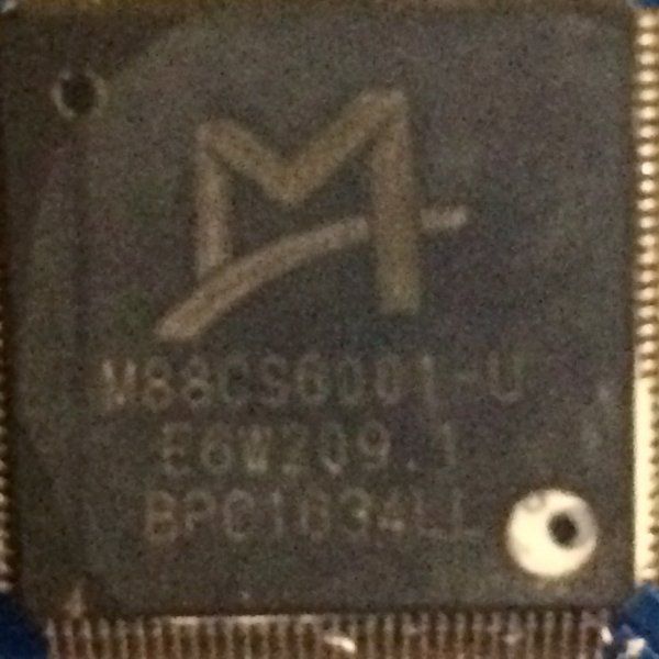

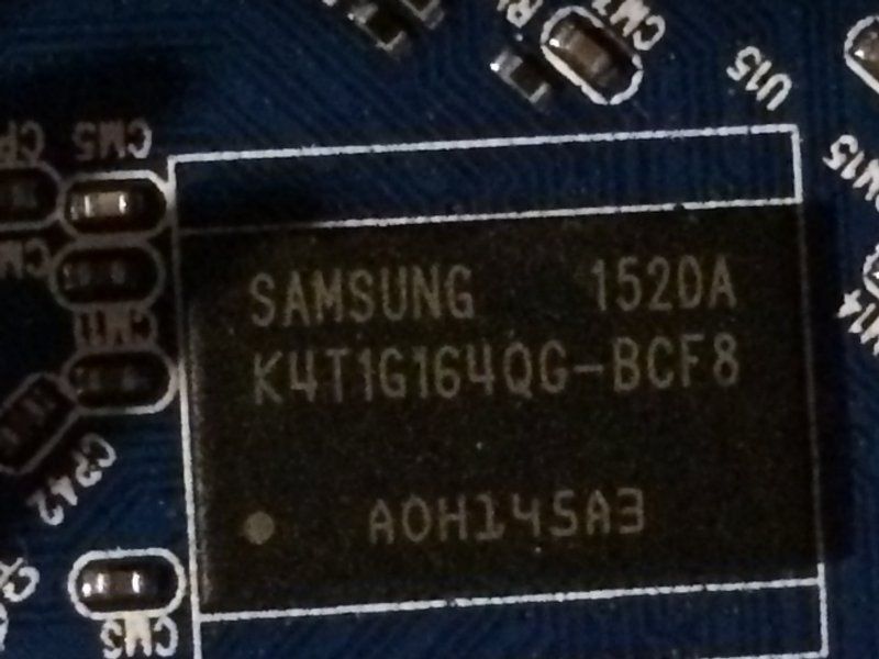

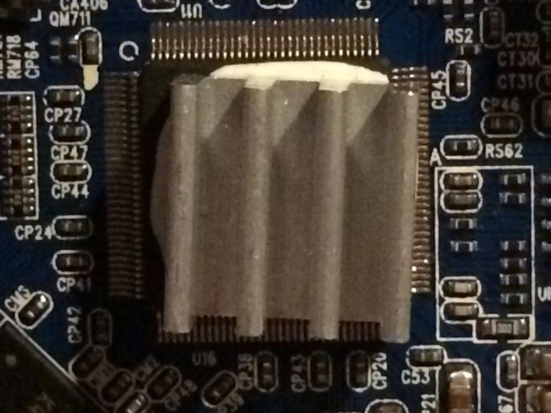

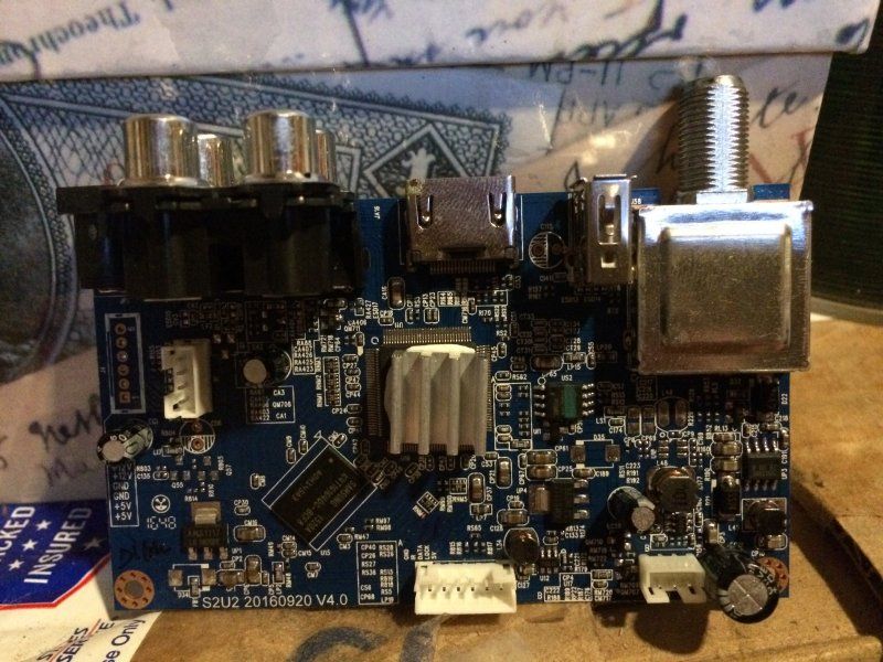

Let the dissecting begin! I removed the board, but can't seem to get the heatsink off. Appears to be bonded on with something... hmmm... maybe a little more brute force? I'm assuming the exposed chip is the memory?

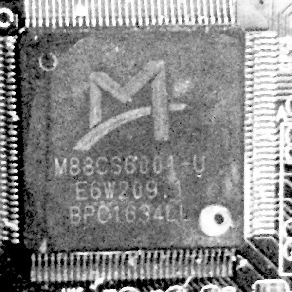

Wow there must be hundreds of different receivers using this chip, and PC cards as well, lots of hits on google, The DZ100 receiver shows up a lot...
I have observed the market is full of hacker boxes. Unfortunately there is no money in writing firmware for these boxes. If they did write some new firmware it would be an excuse to make a new box and sell it as the latest and greatest. But you will never find good working legit firmware for these things.
Most developers use unique hardware ID for SOC firmware. This prevents firmware from being shared between different hardware builds and protects their investment. Lazy, inexperienced or clone builders often use a generic ID or unencrypted files.
You might find an unencrypted firmware that could be modified to load on other platforms, but that would be quite unlikely.
Firmware often can be loaded bypassing hardware handshake via ttl or LAN. Might try sniffing and prompting the com ports using Putty.
Otherwise, try loading files from STBs using the same chipset, tuner and I/O (v7, etc.). You may brick it, but hey, it is cheap to replace if unrecoverable...
