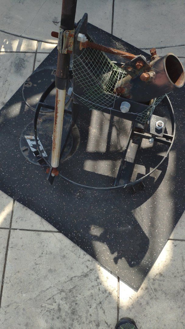

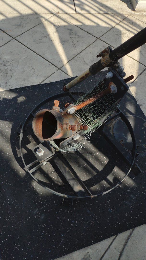

After years of procastination, finally started process of refurbishing my 10ft KTI dish today :) New pole mounted so it's on to the polar mount. I can probably soak the rust off and re-use but does anyone know where are I can source polar mount hardware, mainly bolts? Please see attached pictures.

You should be able to find what you need at Home Depot, Lowes or Fastenal. That's where I got any that I needed to replace. PB Blaster is what I use to get the old ones out. Soak for several days if necessary and re-spray them daily.

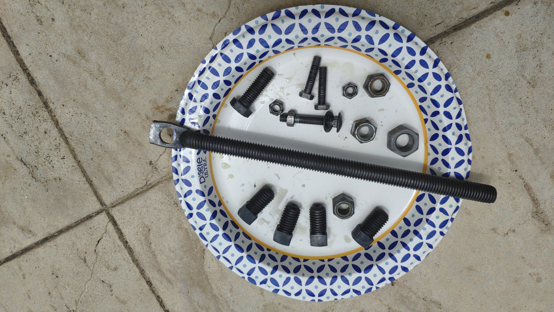

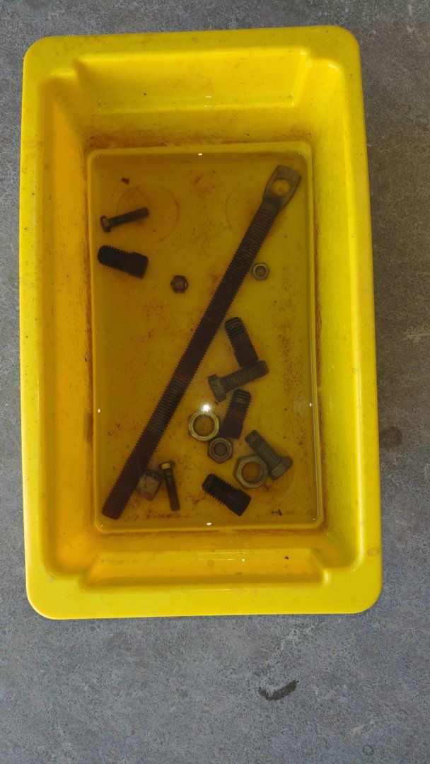

With some PB blaster and brute force, I was able to get everything disassembled. Some of the bolts I can certainly source at Home Depot although some of the others may take creative searching. Fastenal is a good thought. I'm about to drop the rusty nuts and bolts in a bucket of vinegar, hopefully that will at least get me back to clean parts. I'll probably lightly sand down some of the mild surface rust on the mount and then probably spray with Rustoleum black.
Don't worry about exactly matching all of the ones you want to replace, as long as the diameter and/or thread are the same they should work, you can usually vary the length some.
And the head type can change also...for instance those square-headed bolts that tighten the mount to the pole can be hex-heads.
Besides the good sources FTA4PA mentioned I have a non-chain hardware place locally that has a huge inventory, also most of the farm supply-type stores (like a Tractor Supply or Rural King) have a lot of common plated Grade 5 hardware.

Thanks everyone. I've sourced stainless steel or zinc replacments for everything except the long flat head fish eye bolt. Not really sure of the correct name. Overnight in vinegar did make a little progress but not enough so I switched to an Evapo-rust bath. Other than rust, long bolt is in good shape so if no replacement found I'll take your advice and just coat in lubricant gel.

If it doesn't clean up good enough to use and you know someone with a welder you could buy threaded rod and a small square of flat iron, drill the right size hole and have them weld the two together. Not elegant looking but it would work. :)
Reactions: mr3p
Those bolts in the picture look ok, just run the nuts up and down the whole length a few times especially on that long "eye bolt" so they turn freely. Some thick grease (gel?) should minimize rust once re-assembling; all good advice above. Spray some lube on the bolts yearly when assembled to minimize moisture getting into the threads causing siezing. Painting everything flat black seems to help hide dust etc where bolts are greasy etc. :) The steps you have already taken indicates you have a good handle on the situation. Just don't over-torque the bolts/nuts when re-assembling.

Regarding seizing, is this an issue if the bolt is stainless and the nut regular steel? the mount has 4 square head set screws which locks it in place on the pole, see first picture in thread. I'm guessing the bolts welded on mount are non-stainless so just wondering if a stainless square head bolt replacement could be used as thus far I haven't found a galvanized version.
Nuts welded to the mount are regular steel. You can use hex-head galvanized bolts there or ss bolts, does nor really matter.
there are no issues in such a combination.

Thank you RimaNTSS. Thanks to Evapo-rust, everything cleaned up pretty well but I'm going to make one more trip to the hardware store to see if I can find galvanized replacements. If not I'll use what I have and coat with some grease
After pictures of nuts bolts:

The original spade bolt cleaned up pretty well but a friend of a friend agreed to fabricate a ~12inch spade bolt. I was thinking of using galvanized rod or would you choose stainless? You can see for yourself in the picture in the first post but the original bolt was diffusely rusted with the spade spared so wondering if that was galvanized welded on steel bolt? If it was a unibody or stamped spade bolt from a single rod, I would have though the whole thing would rust.
What's the best way forward?
