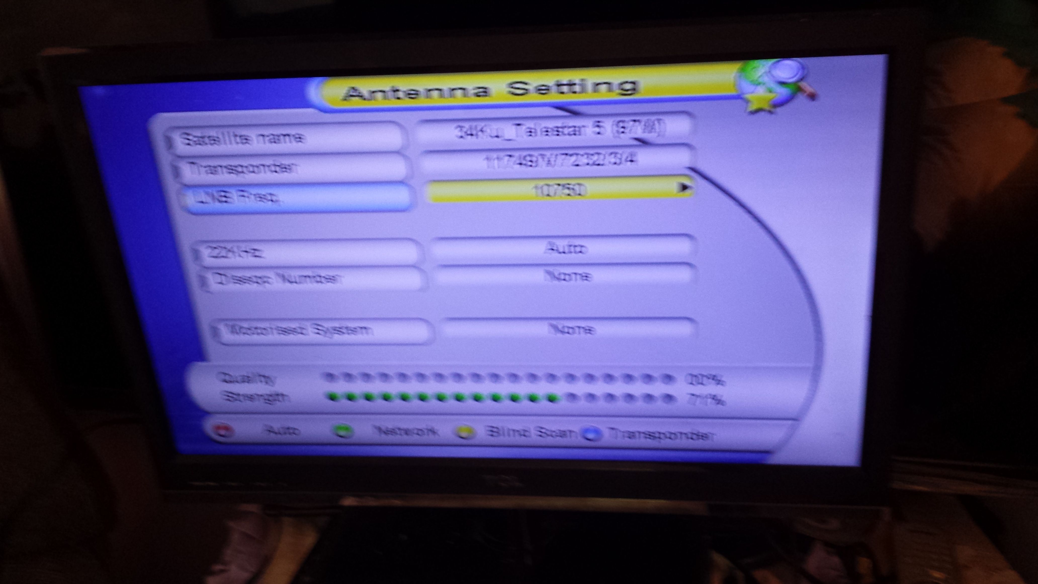

Can you post the specs of the LNBF and also the settings in the antenna setup in the CW700?

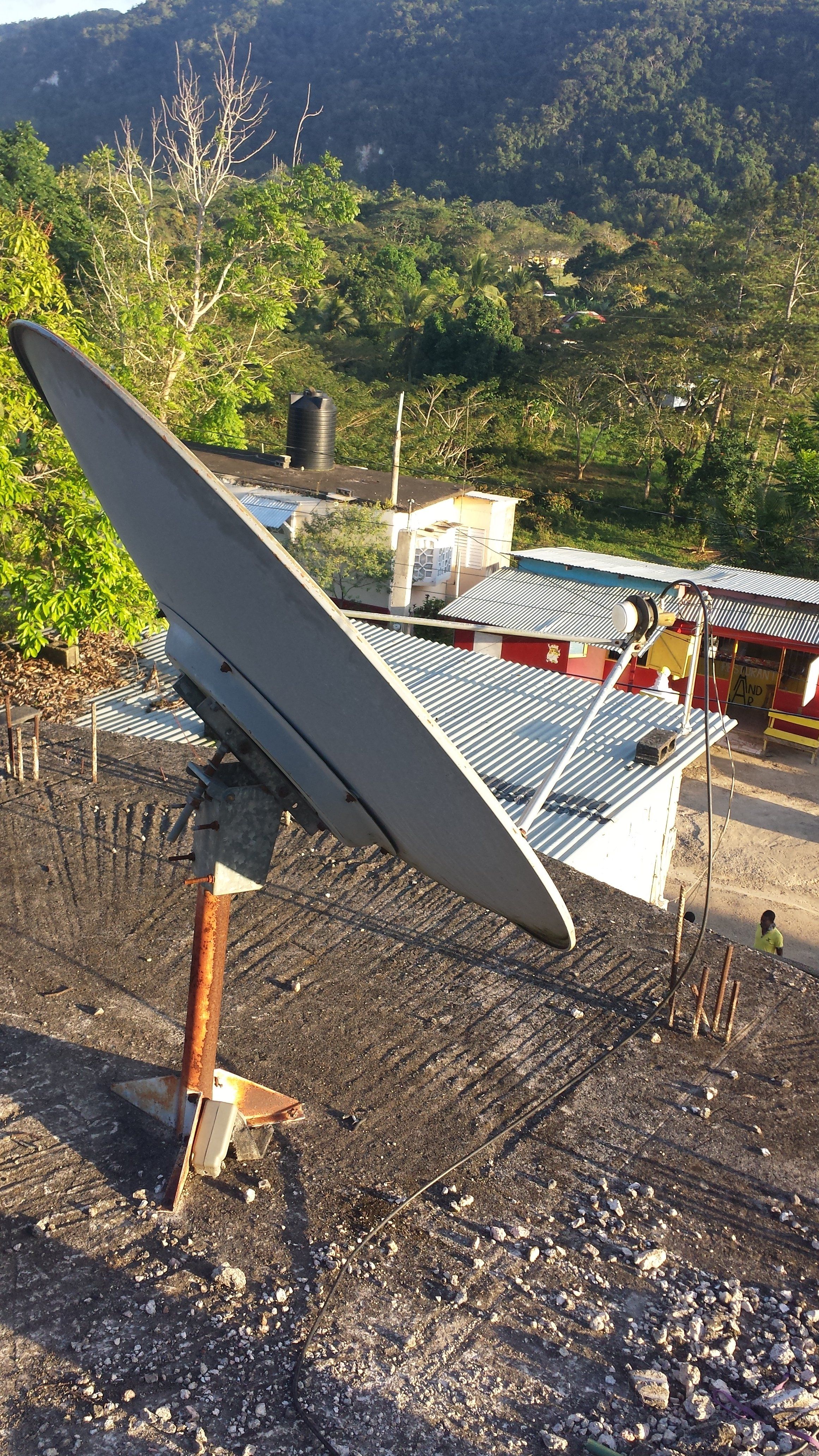

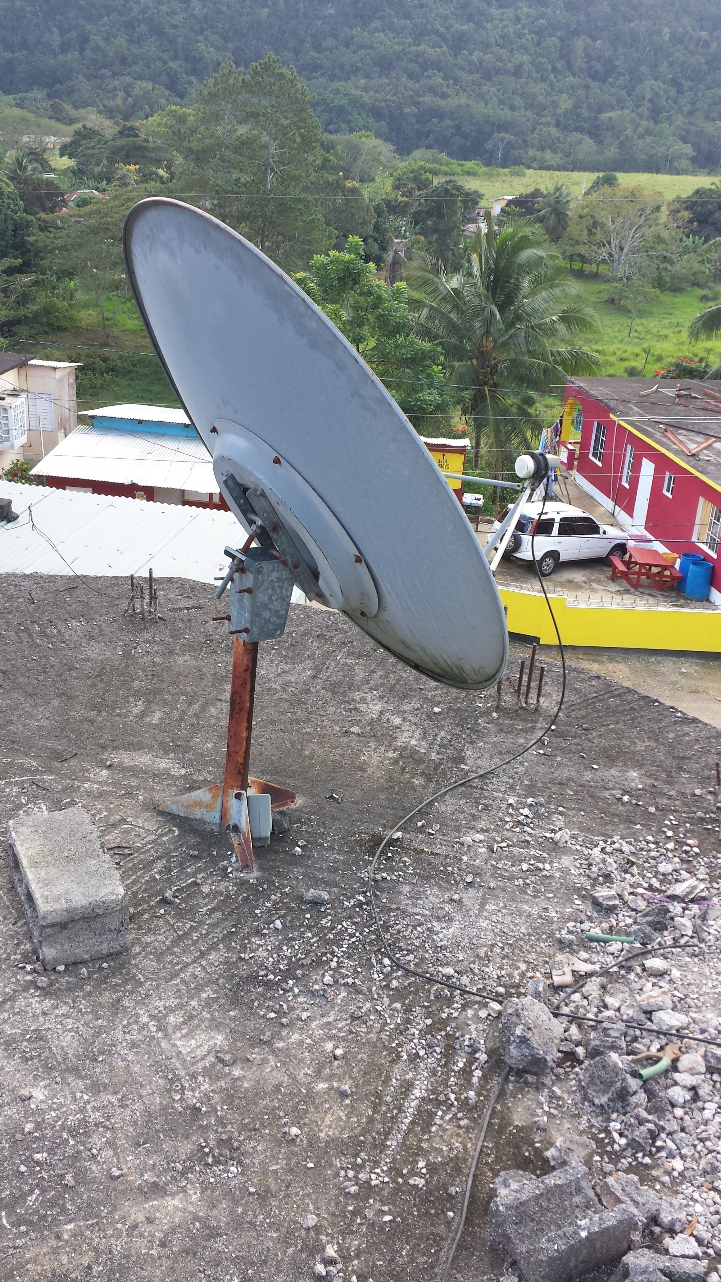

You got no Quality showing, which means you're not locked on anything. Signal only means that the LNB is working and not necessarily locked on anything. Is that TP you're trying to lock a "known" strong TP for that satellite?

Signal is showing 71% so receiver is seeing the connected LNB. Did you get your dish aimed per the dishpointer? If so, try to get Quality using transponder 12152 H 20000 3/4. Rotate dish on pole left, then right to about 20° from your starting point moving the dish slowly to allow time for a signal lock. If you try both ways and don't get signal, return to the starting point and raise or lower your elevation a degree. Repeat this until you lock a signal.
Your profile shows your location in Jamaica. If so, the LNBF skew is not set correctly. The photo shows the LNBF skew set at 0 degrees.
The approximate skew rotation for Jamaica on 97W would be approximately +45 degrees counter clockwise as viewed while standing in front of the dish looking at the back of the LNBF. If the skew (rotation) is not set close to this angle, you will not receive any signals even if the dish is tracking the arc and all other settings are correct.
