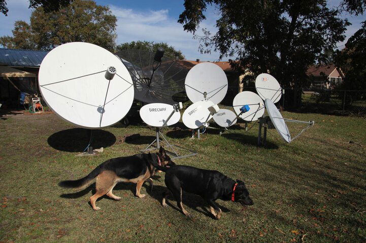

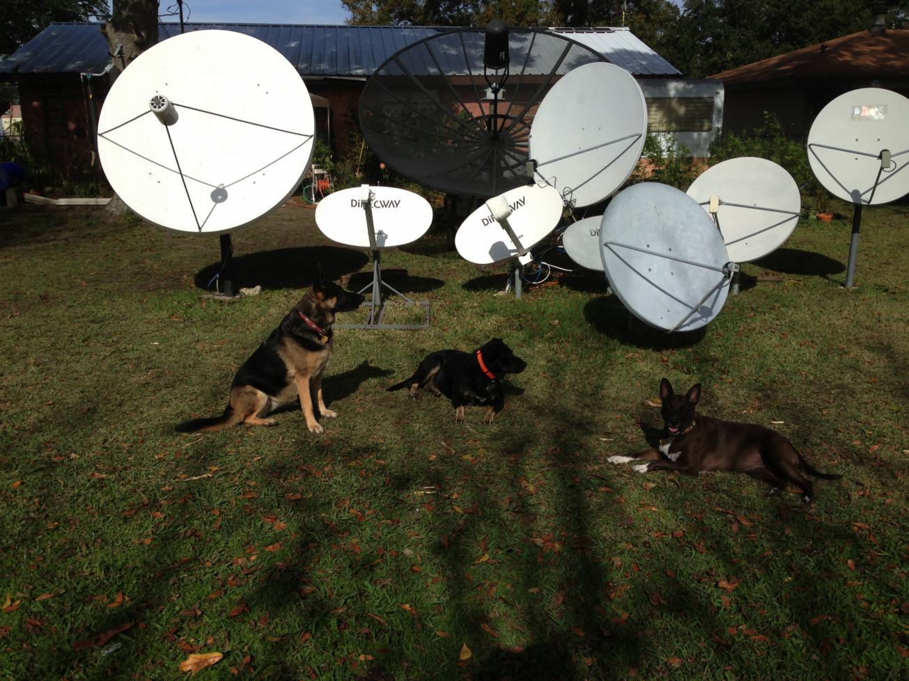

I did my own self install for Dish. I bought a used receiver from a third party and 100% self installed using very much non standard, non approved dishes and methods.
I didn't take the contract or special offers, I pay cash month to month and can terminate any time I wish without penalty.
If you can make it work right they don't seem to care.

They surely won't provide technical support for a dish other than their own. However, sometimes it pays to be one's own technical support ;) ...
