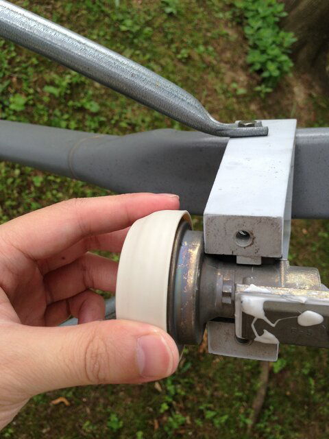

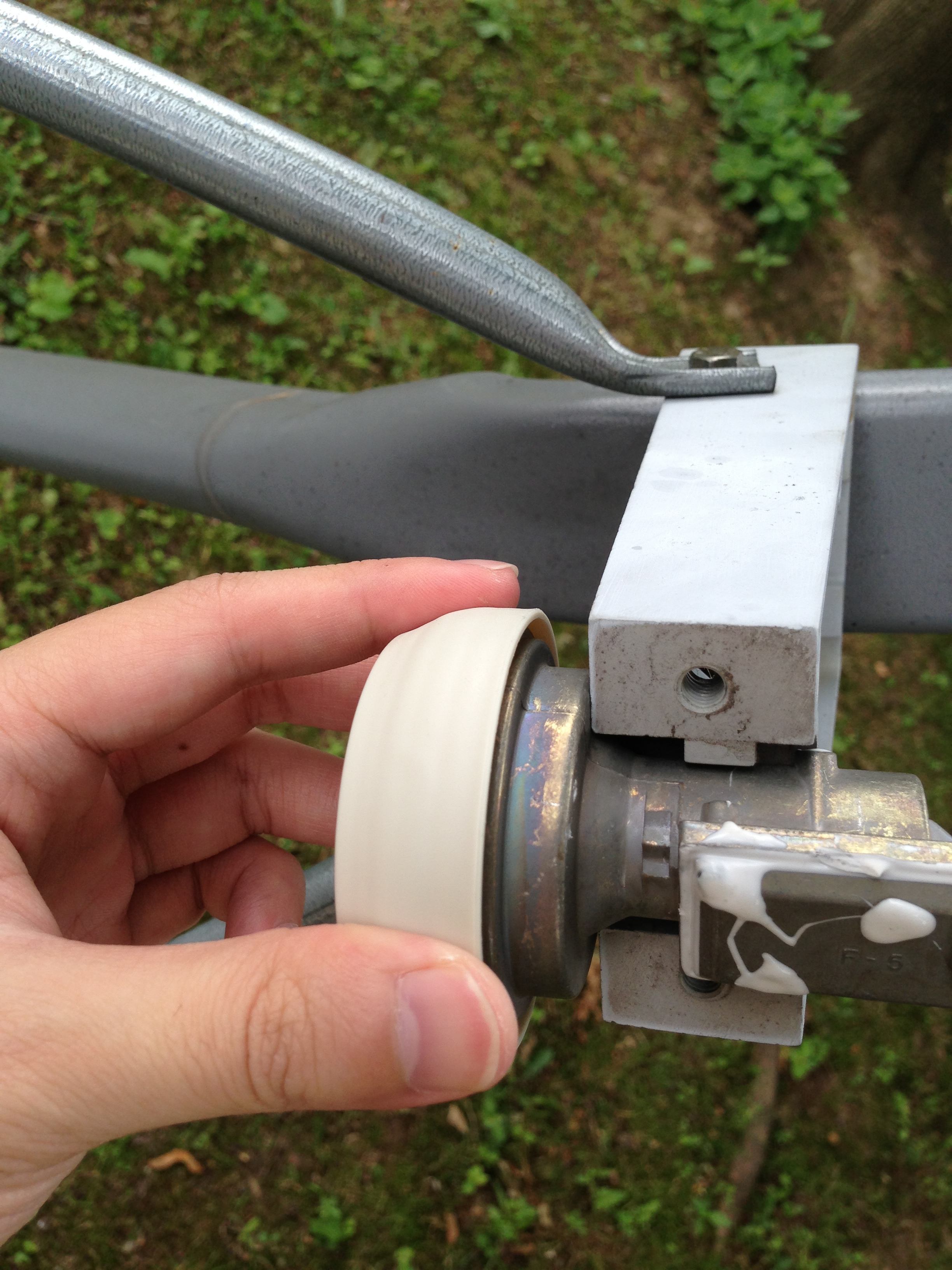

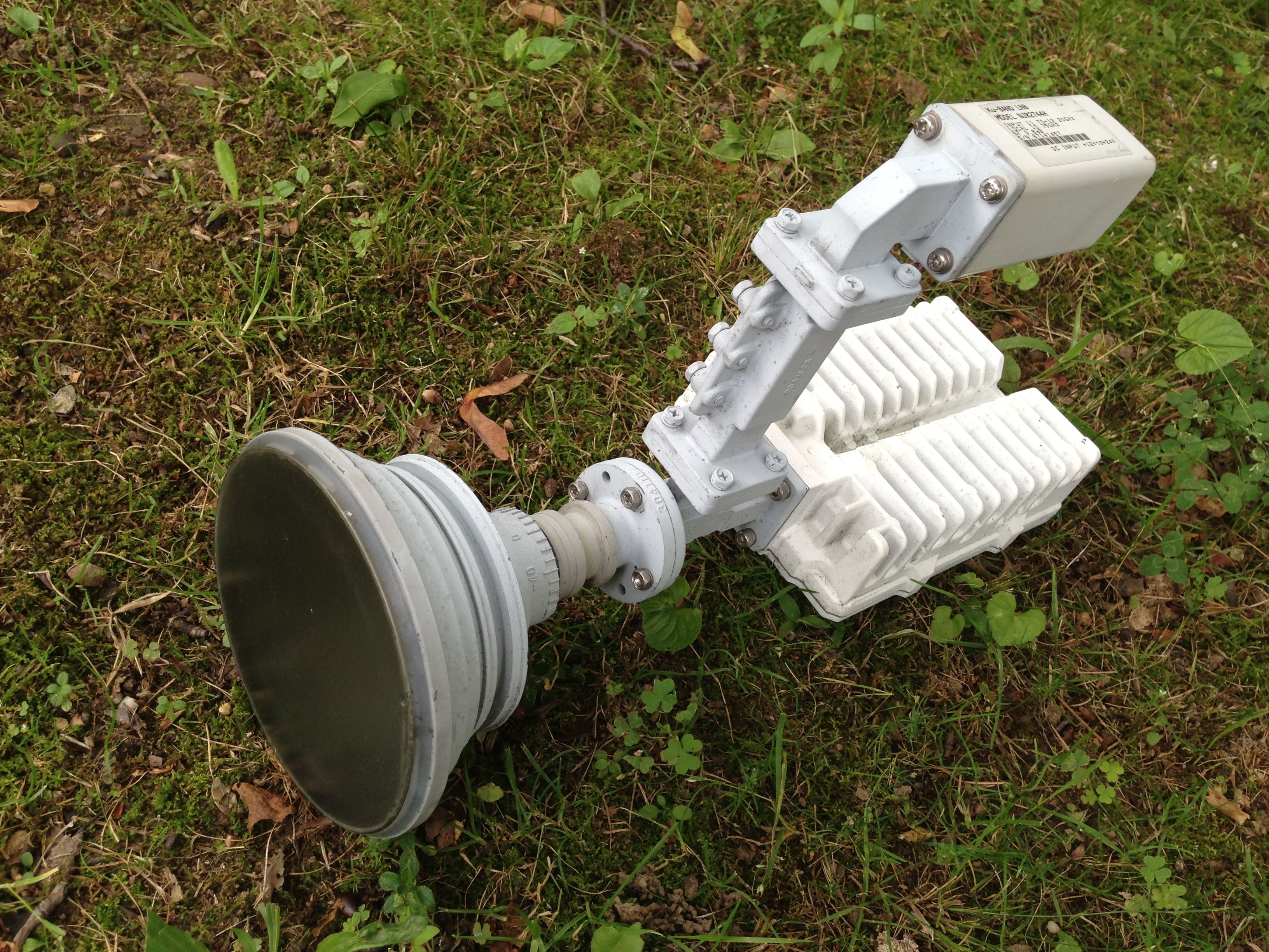

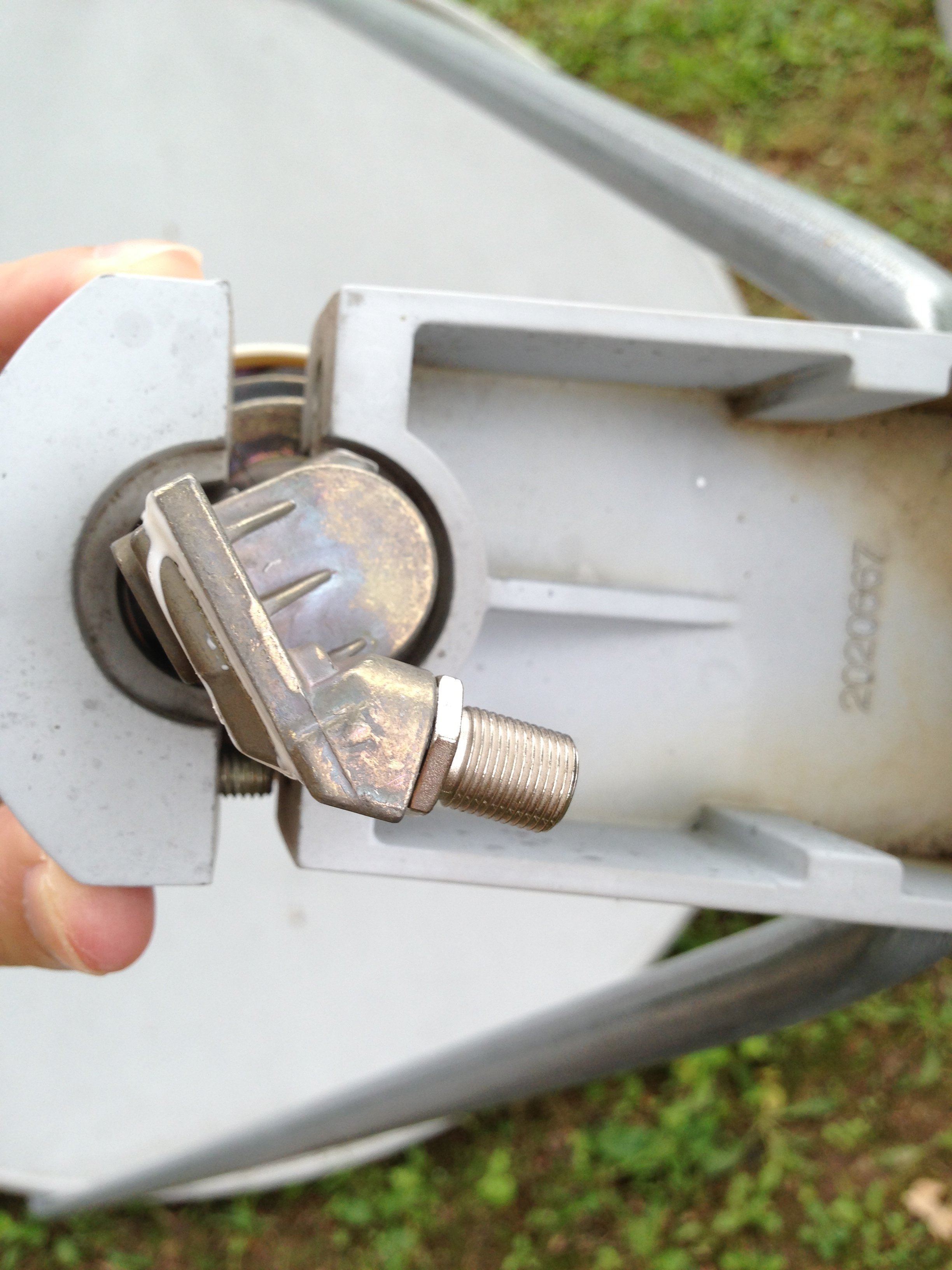

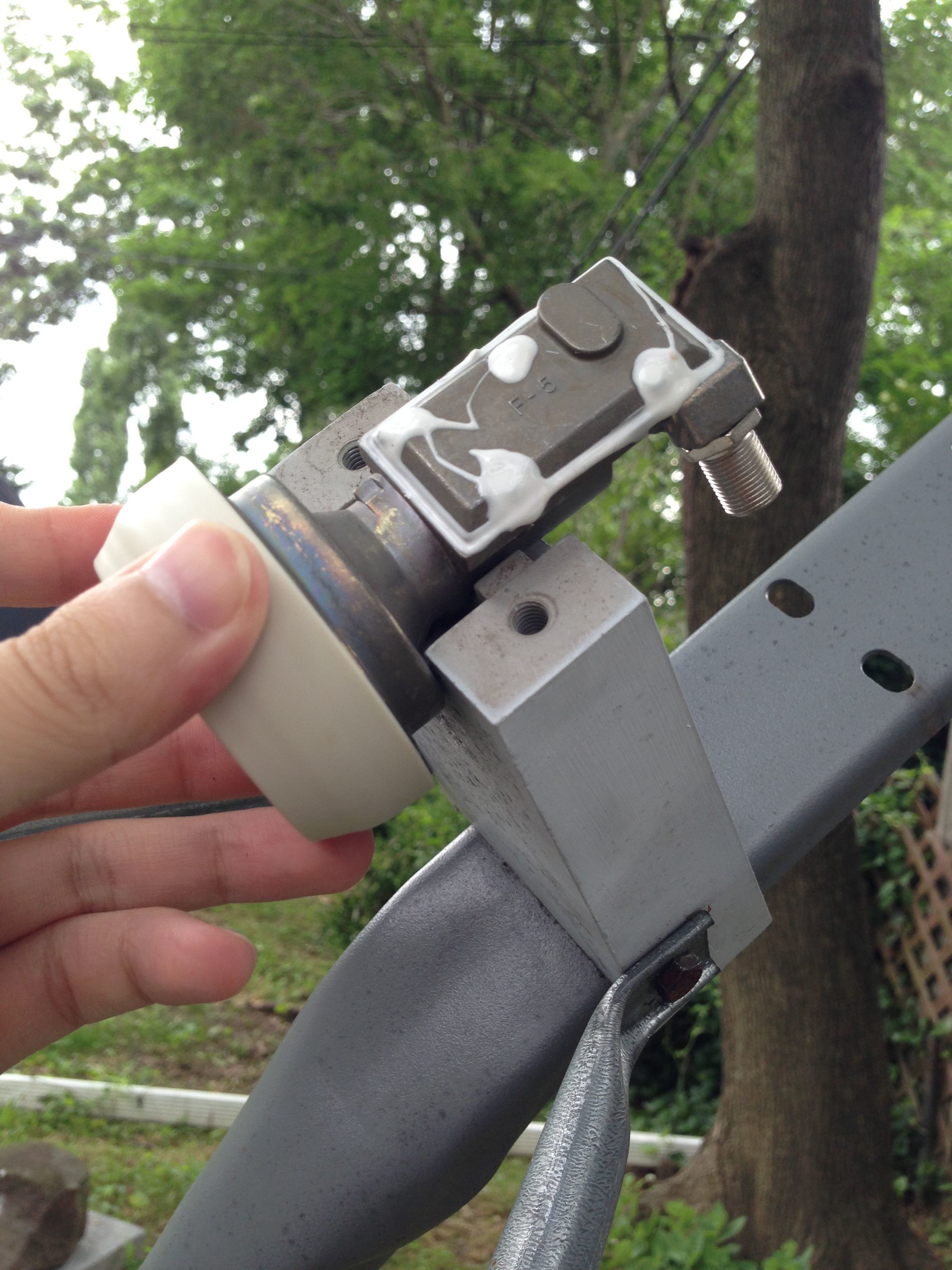

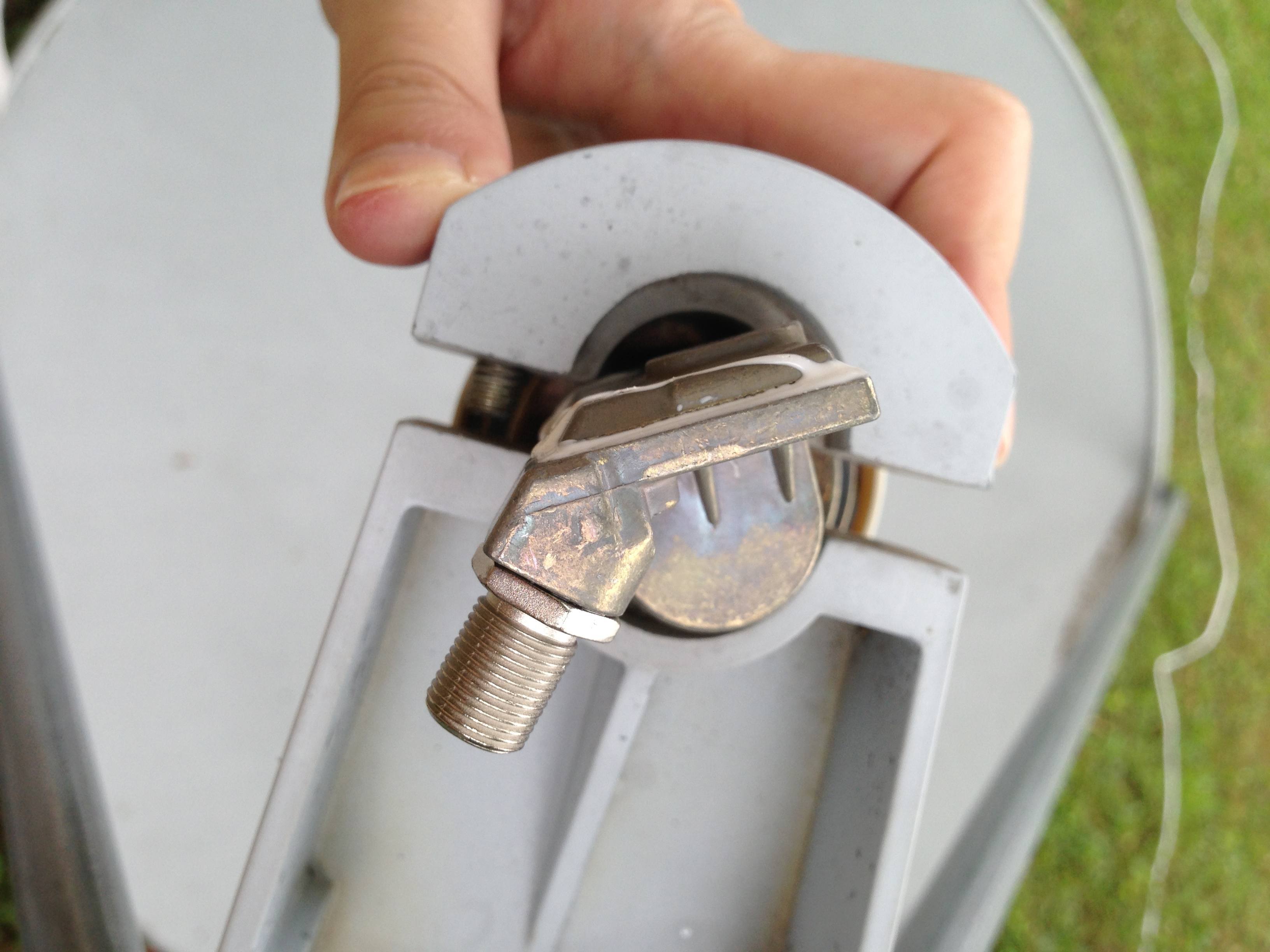

I got some updates on my dish.

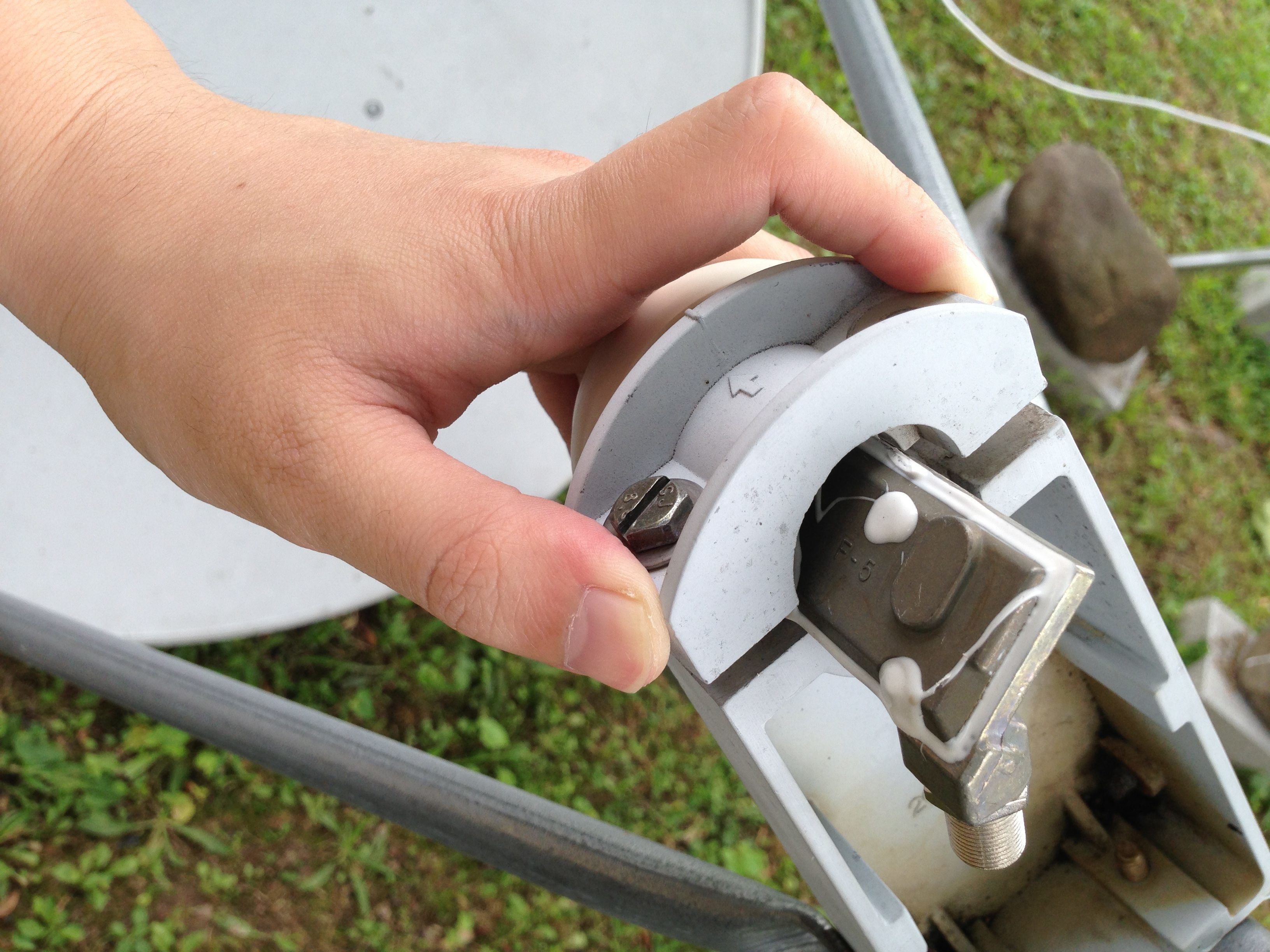

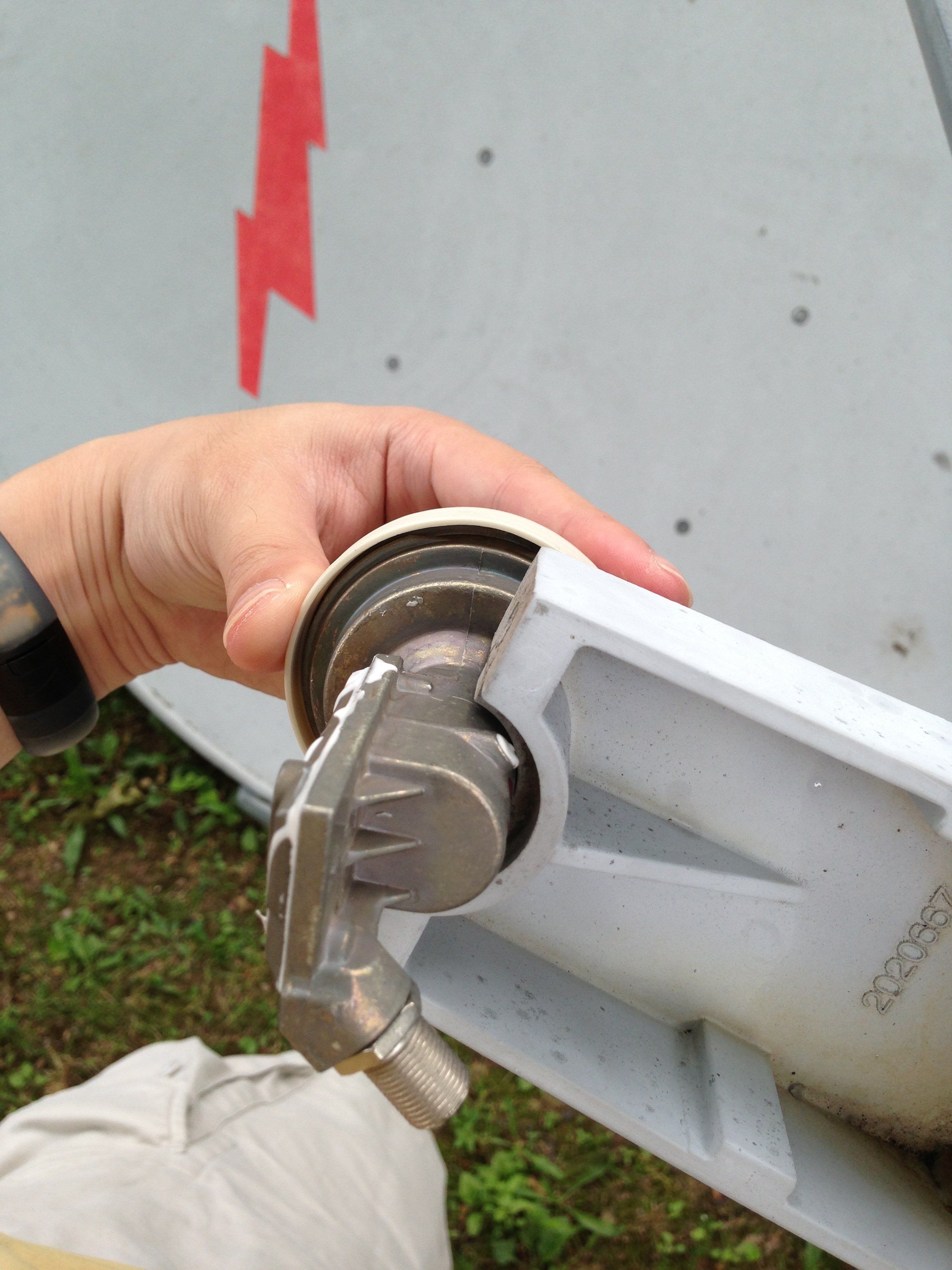

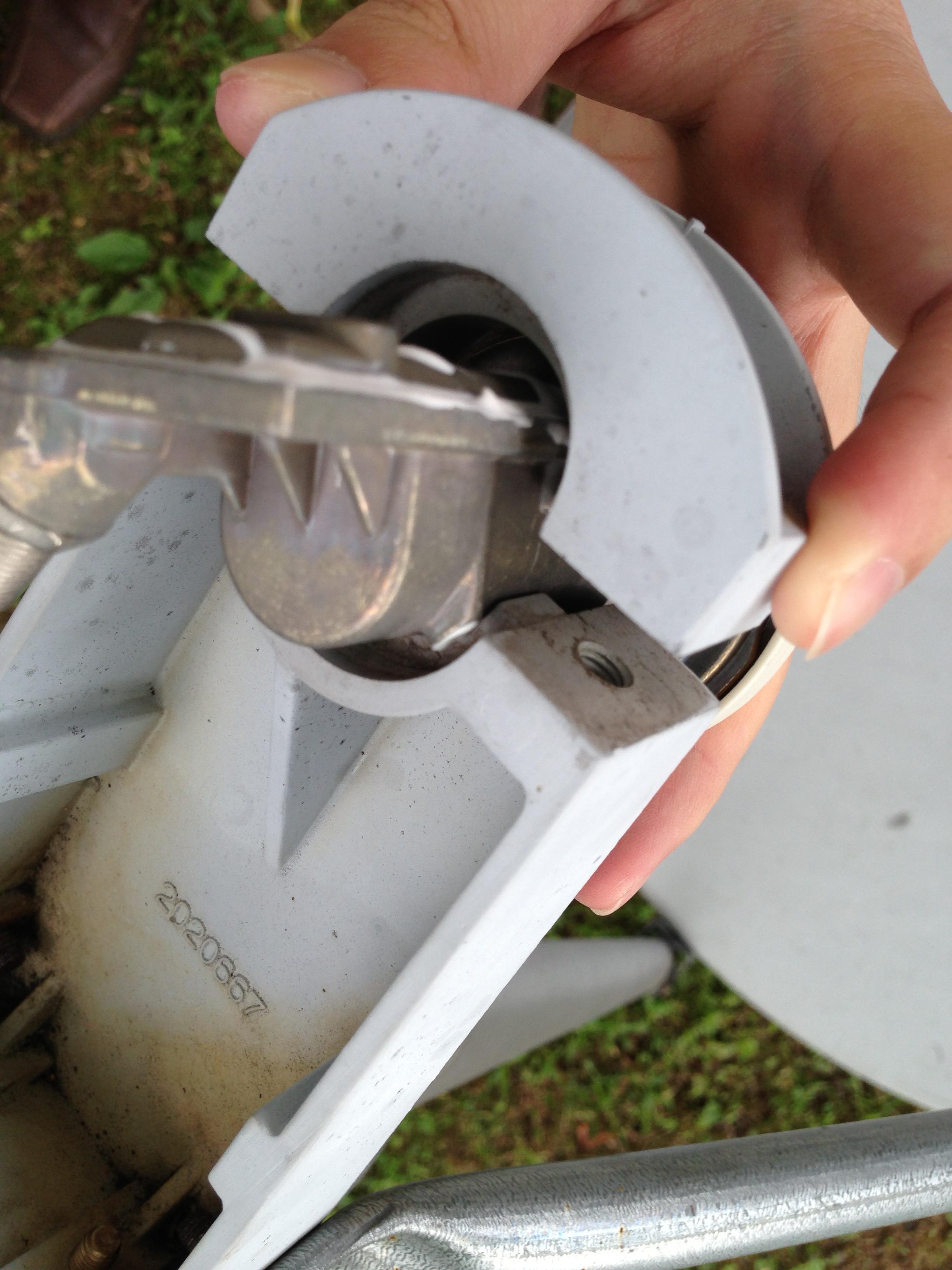

I ordered a second geosat pll lnb and took it apart. Removed the the plastic casing around it and tried to see if it could fit in the neck of the current OMT.
Perfect fit. I was surprised. Below are some pictures.
My question now is I won't have any issues with angle right? and what about distance? Also, since the plastic is off now what can I do to prevent corrosion or rust. There is this new product called Never Wet from rustoleum which is superhydrophobic. Will it work if i spray it?

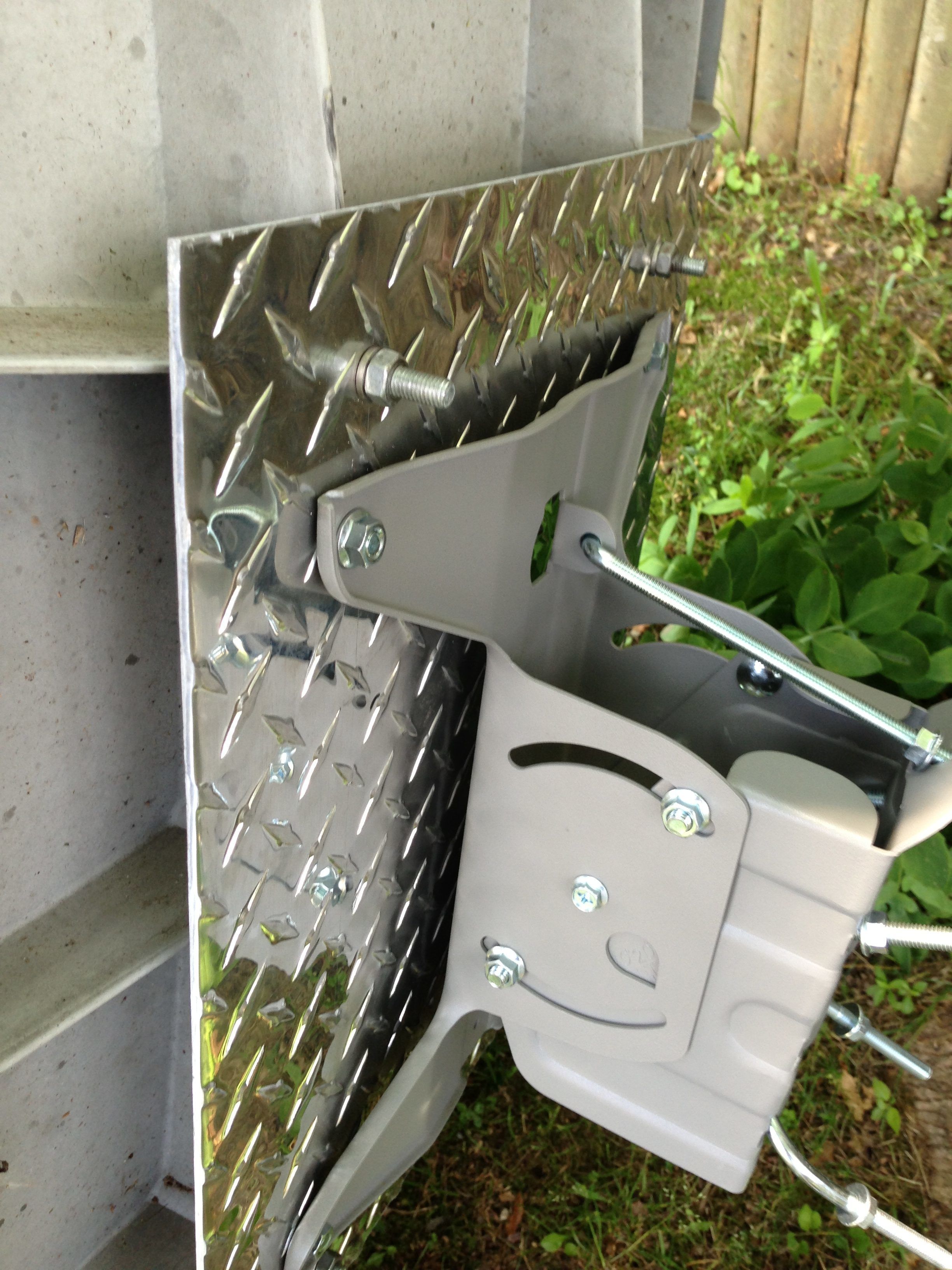

Getting my other parts Friday and i'll make a trip to the hardware store for a aluminum panel for the back plate.

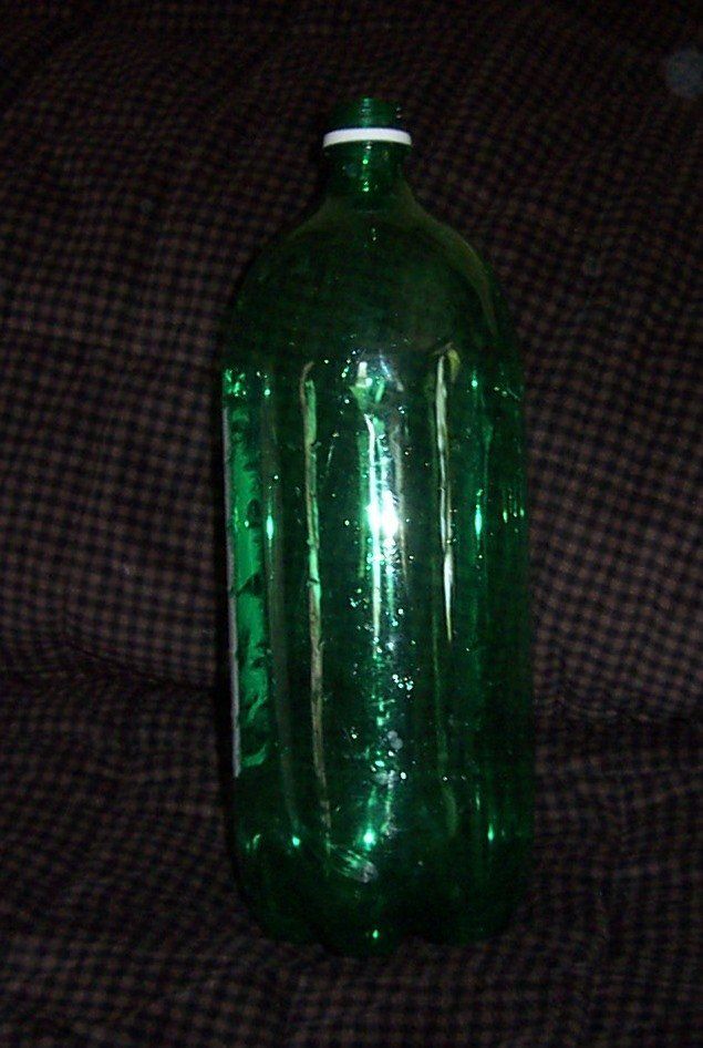

Don't know about the Neverwet but I would suppose it wouldn't hurt. Needs reapplication occasionally so maybe WD40 would work as well(?) That's what I've used for that purpose.(BUD's actuator arm) Could also put a 'roof' over the LNBF made out of a 1 or 2 liter soda bottle?
As far as focal point adjustment, going to have to get it on a satellite and see if moving it makes a positive difference. I just have a feelin' that's it's going to be just a little too far from the dish.
WD40 is basically Kerosene, so I really would NOT spray the lnb with that!
It may be good for many things, but I don't know where people get the idea that WD40 makes a good waterproofer for electronics....
No need to worry, corrosion and rust will not occur. I would shade the case from direct sun or paint it white to avoid heat build-up in the case mass.
I agree, that the feedhorn will be too far away from the reflector and will be out of the sweet spot. Probably will need to move it forward so the scalar is in a similar position as the original.
Maybe use a polarity switching LNB such as an original Prime Star dual polarity "pop can" or Invacom SNF-031 / QPF-031 LNBs and attach to the OEM scalar/feedhorn. I am confident that these LNB solutions would provide much better performance.

per your suggestion with a two liter bottle shade; that is a great low tech solution.

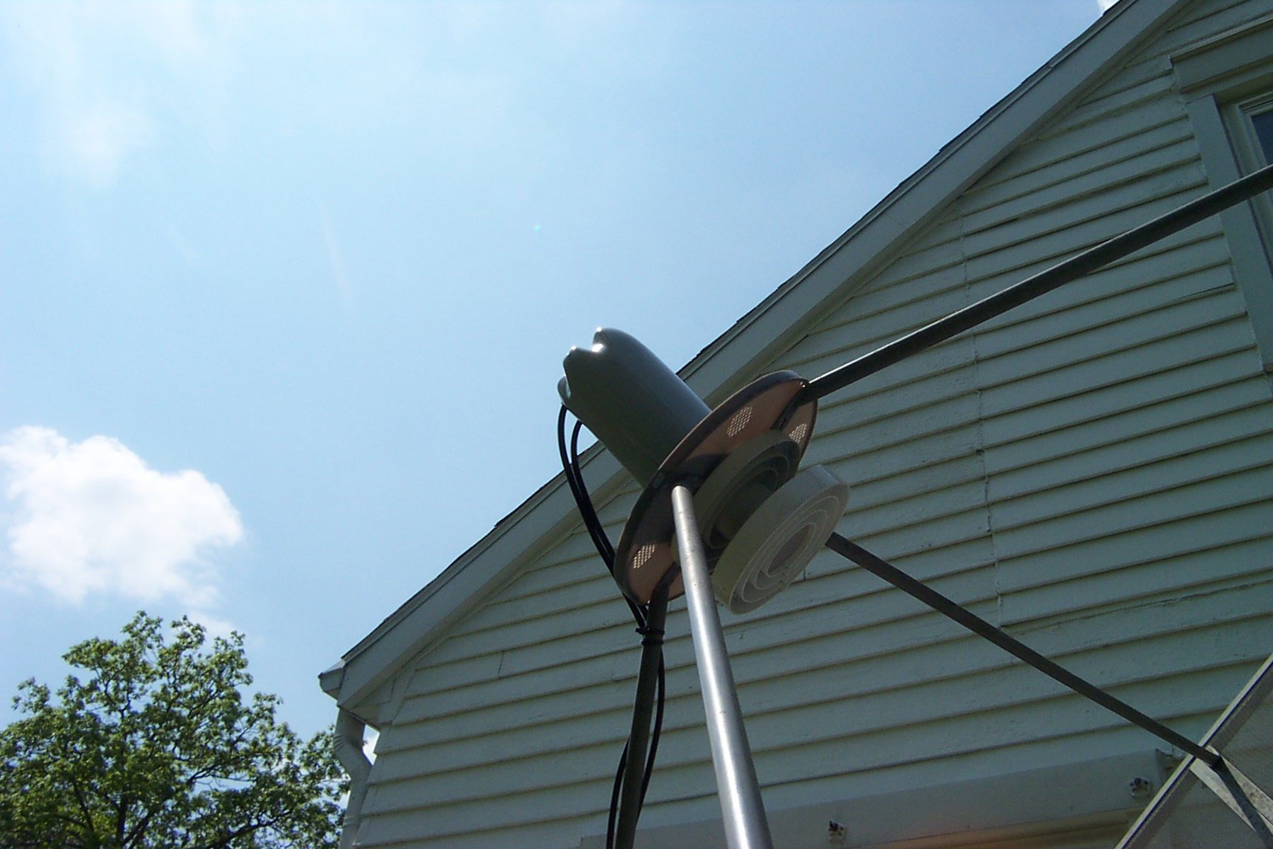

Just modified a bracket to accept the Invacom SNH-031, it places the LNBF to the face of the dish as close to the original LNB setup...Still don't know if the small PLL LNB can be use for FTA....Took some picture and will post them later on.
Using the non-roof penetrating frame, and intend to locate the 30W satellite. Had to set the dish Elevation to 17.5° so had to put the frame on top of two tier of cement blocks, to keep the dish from being so close to the ground, will play with the setup tomorrow, and still have my doubts on viewing the 30W Satellite from my backyard location.
Took some measurement of the non-penetrating frame, it is a perfect square of 5'3", the mounting tube is 2 13/16" OD.
The yard is not quite level so will have to use something to make the frame as level as possible.

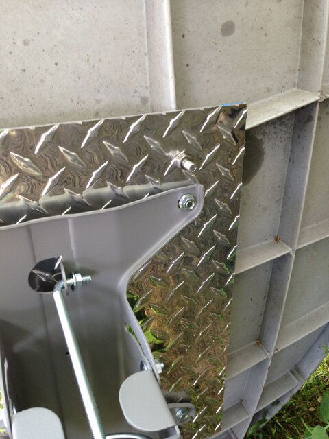

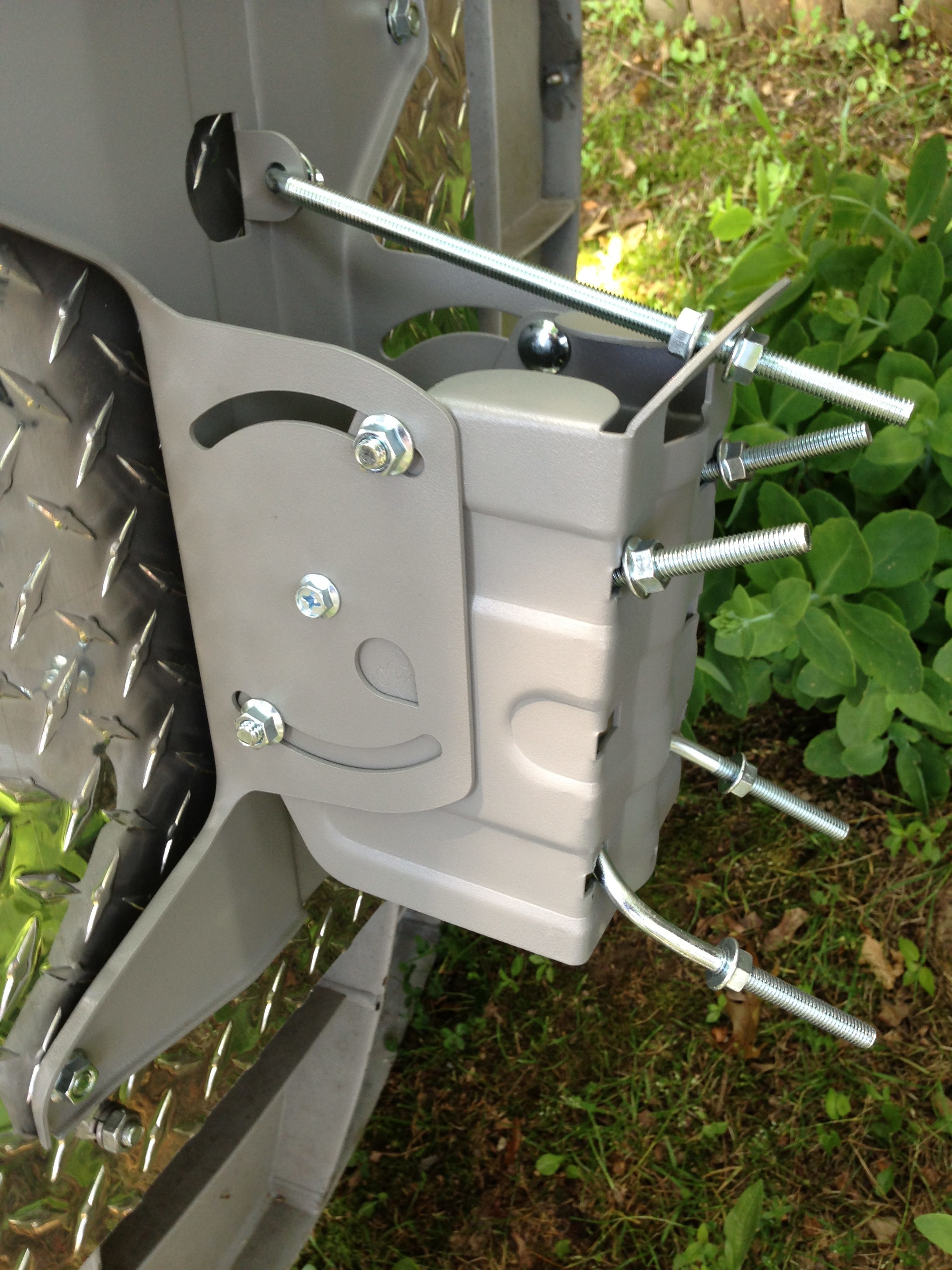

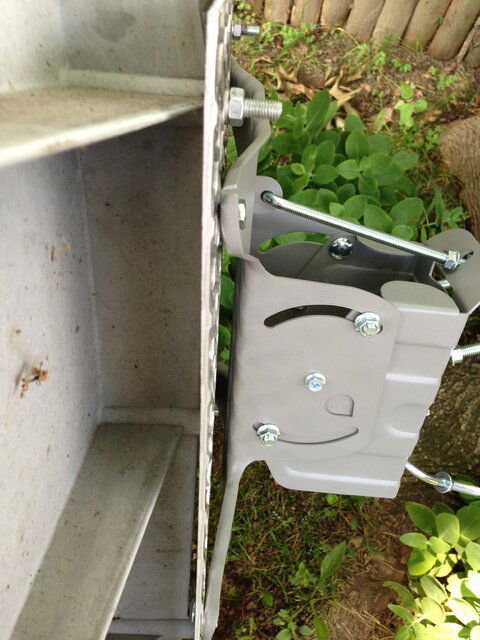

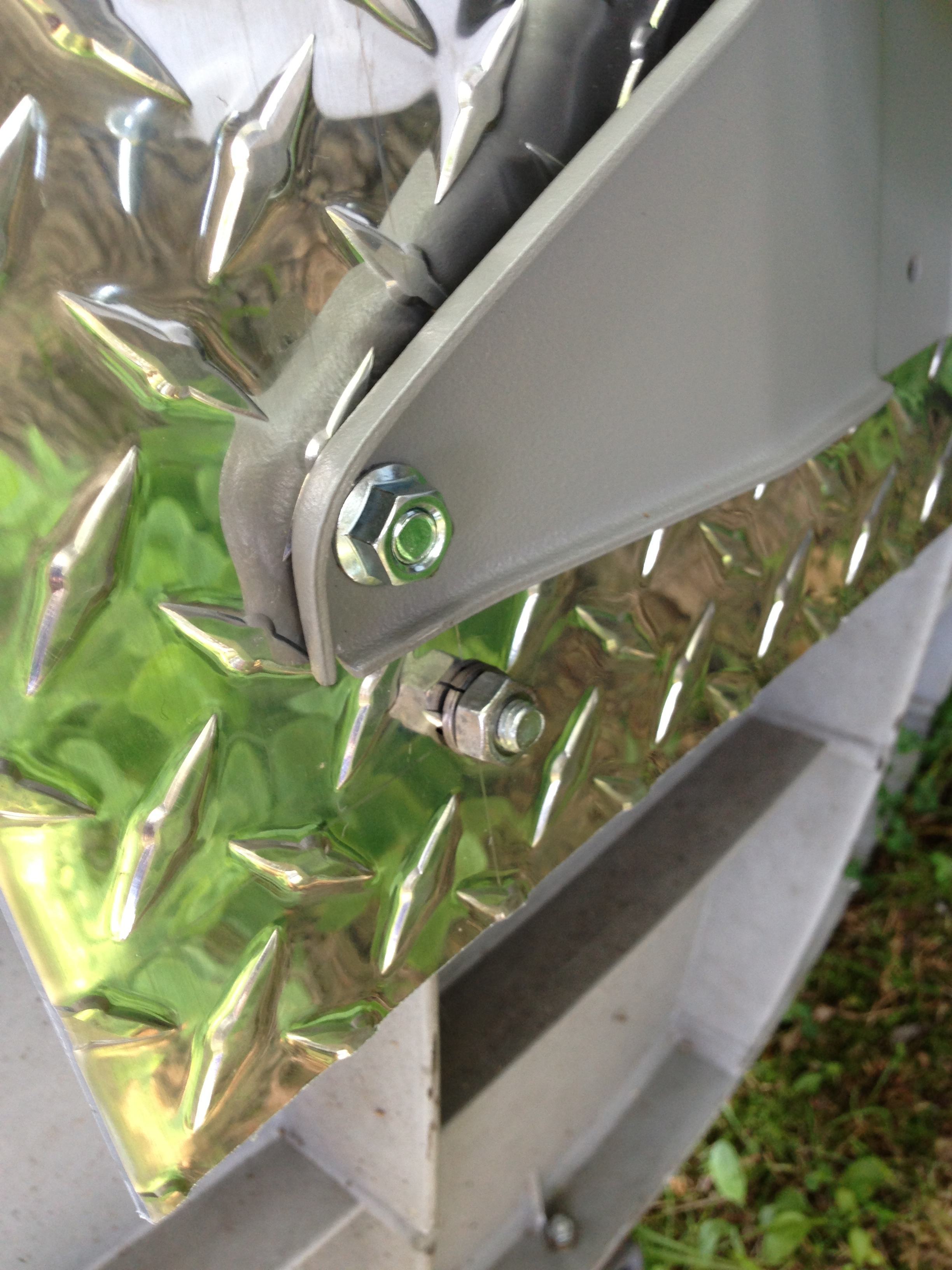

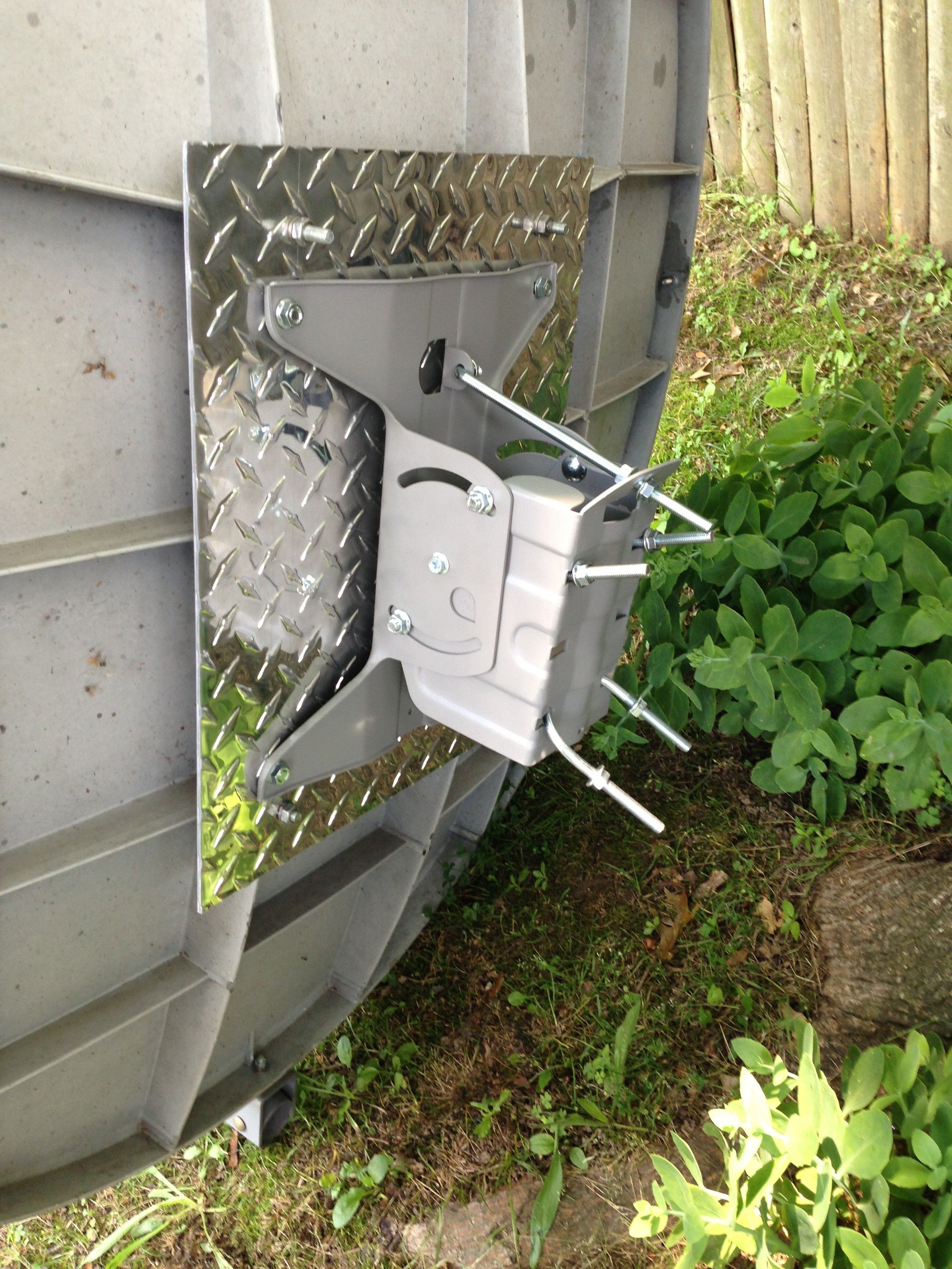

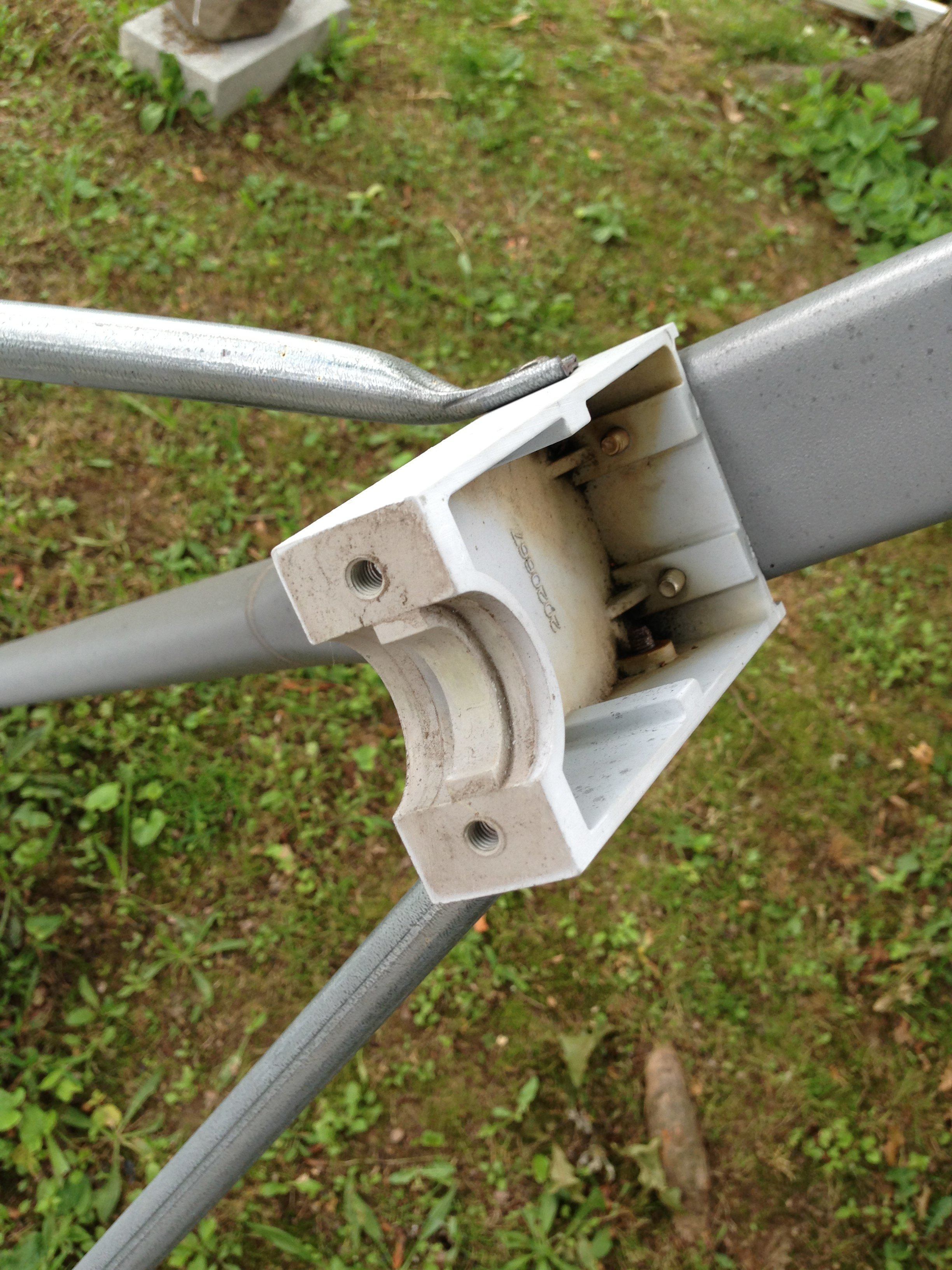

I got to work on dish today. I had to go my local hardware store to pickup some parts and also an aluminum panel. See photos below.
It shaved off a lot of weight but the dish is still heavier than most 1.2m. I tried putting on the HH120 and i didn't get a signal. I don't know what to tweak since the dish moves a lot since it's so heavy.
I'm in New York City, so my latitude is 41 degrees and for the HH120 dish elevation is 24 degrees. So far so good? I did a little adjust for the lnb and made it as far possible to replicate the original feedhorn.
Nothing, even on the strongest satellites. Next thing I'm going to do it just make it point it at one satellite on a stationary mount (no rotor/motor). See if i can get a signal.
Moving up to a 1.2m made it so that I have more stuff blocking it. The 90cm could get a signal because the surface area was smaller. Now my dish is being blocked by my tree and other crap in the backyard.
