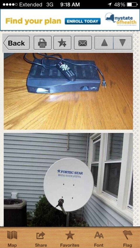

Is this a good setup for 97 west?
It's a fortec star dish and receiver ImageUploadedBySatelliteGuys1382966440.991482.jpg
Posted Via The SatelliteGuys Reader App!
I'm not sure what kind of receiver that is actually but it looks like it has a card inside I think it's fta any ideas?
If the dish is 31" or 33" it will work fine. That's what I am using here. The receiver is probably not S2 (HD) but should be OK for 97W since its mostly SD, 480i.
The guy told me that it's a dish network box and he used it with that dish and he used to get horse racing with it. Would it work on 97?
Can you get the make and model of the receiver? If its a DN box then it will not work for FTA.
If it was an FTA box modified to receiver DN then it may be able to get FTA.
That is an old DN box. That is no use to you.

I need a cheap receiver. Is the dish worth 25 dollars?
Yep. I paid $50 for a "setup" that had a broken motor, but the dish and lnbf were fine. It was a Fortec "80cm" (76 cm across, 81 or something up and down). $25 is a good bargain if the dish looks as good as it seems in the photo. Just verify the size as 31 inches or more. Certainly looks similar to the one I bought for my brother.

Re the LNB, in the pictures you posted, it almost looks like a linear FTA LNB on the end of the dish arm.
