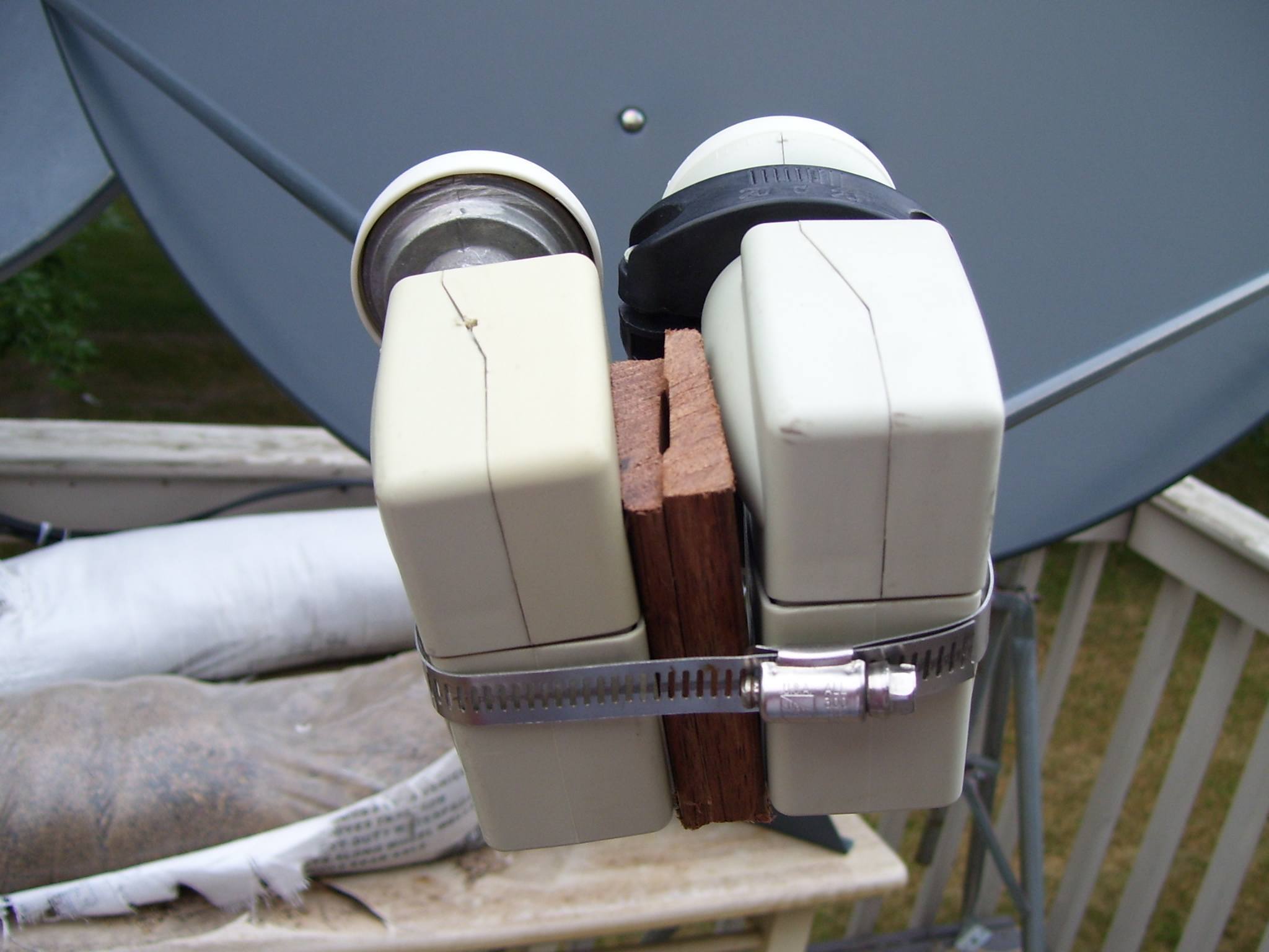

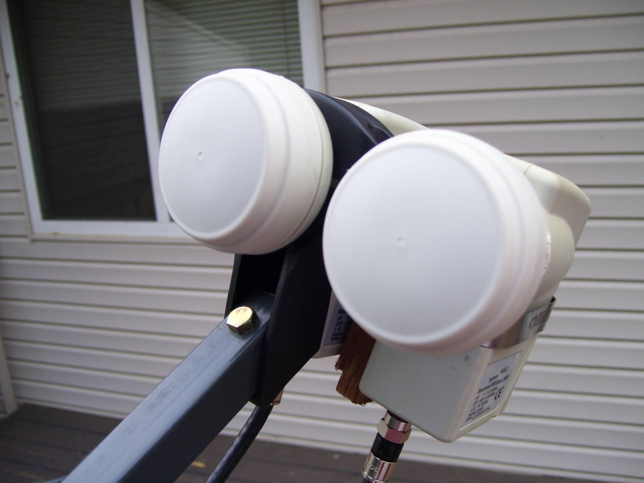

Another option would be a 30" dish and fabricating something for the 2 LNB's to be attached. I used some hose clamps and a piece of wood as a spacer

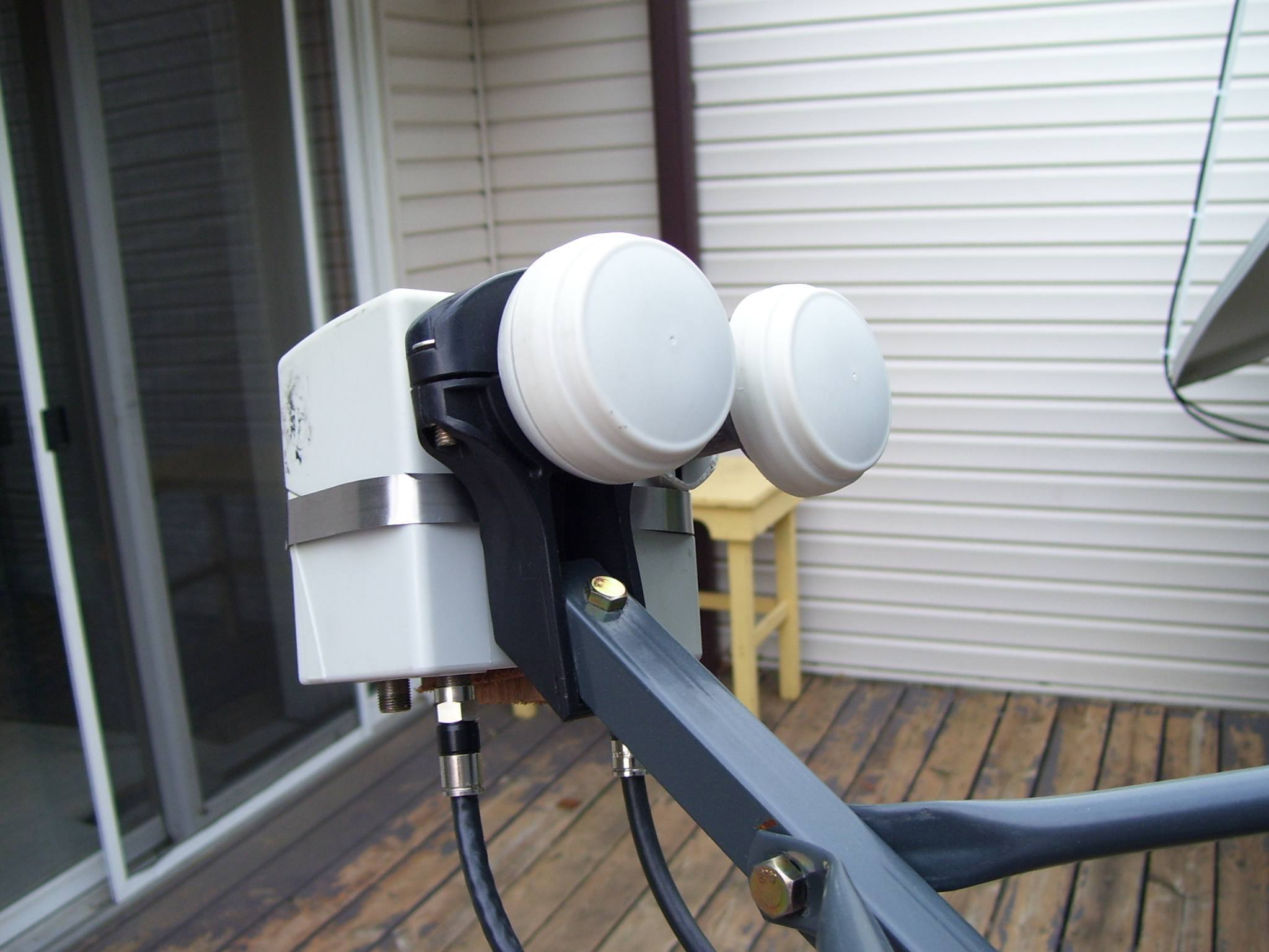

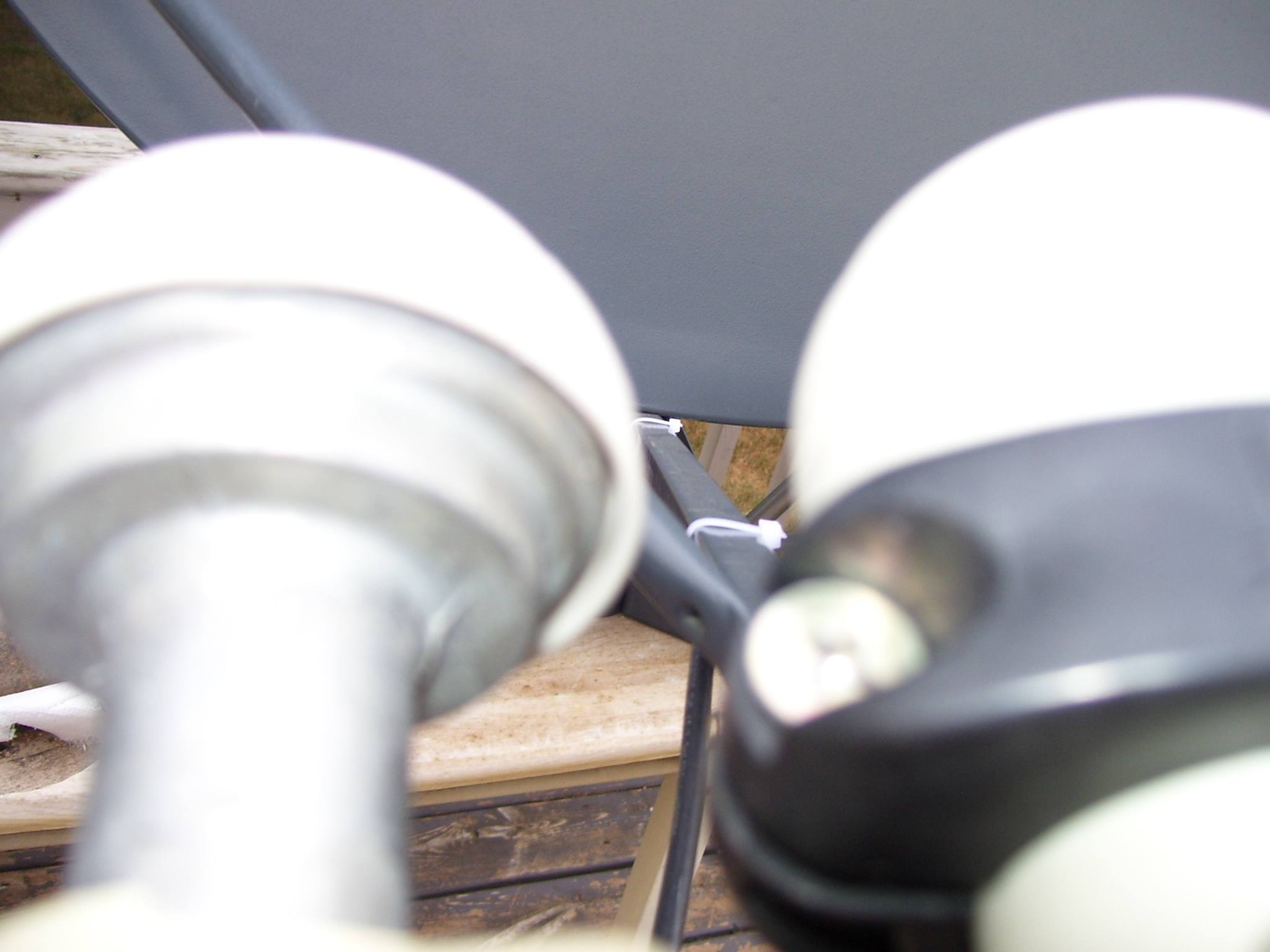

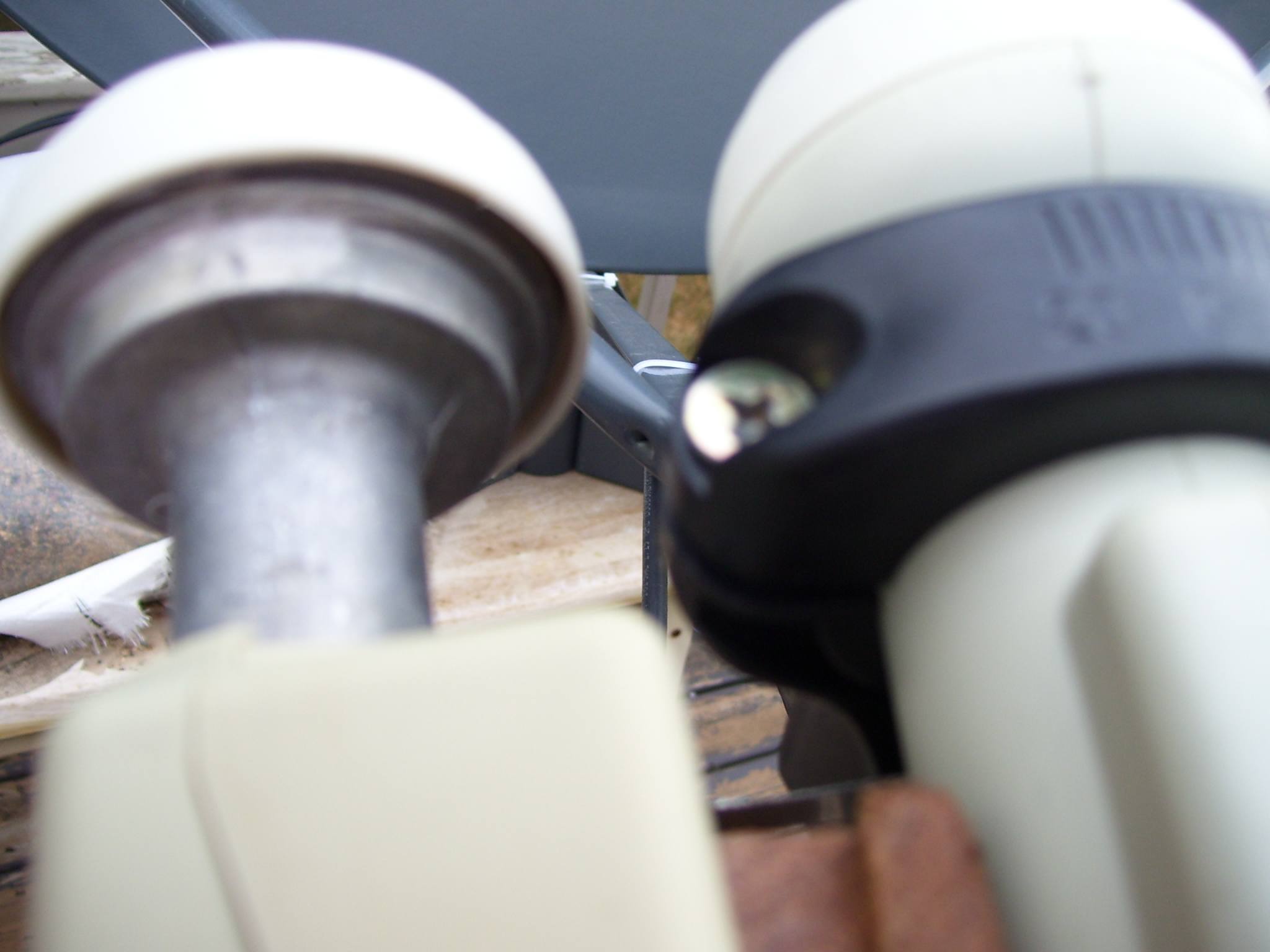

most larger dishes dont have skew. When working with those the spacing between 91 & 82 is greater than a 20" dish so you have to fabricate something

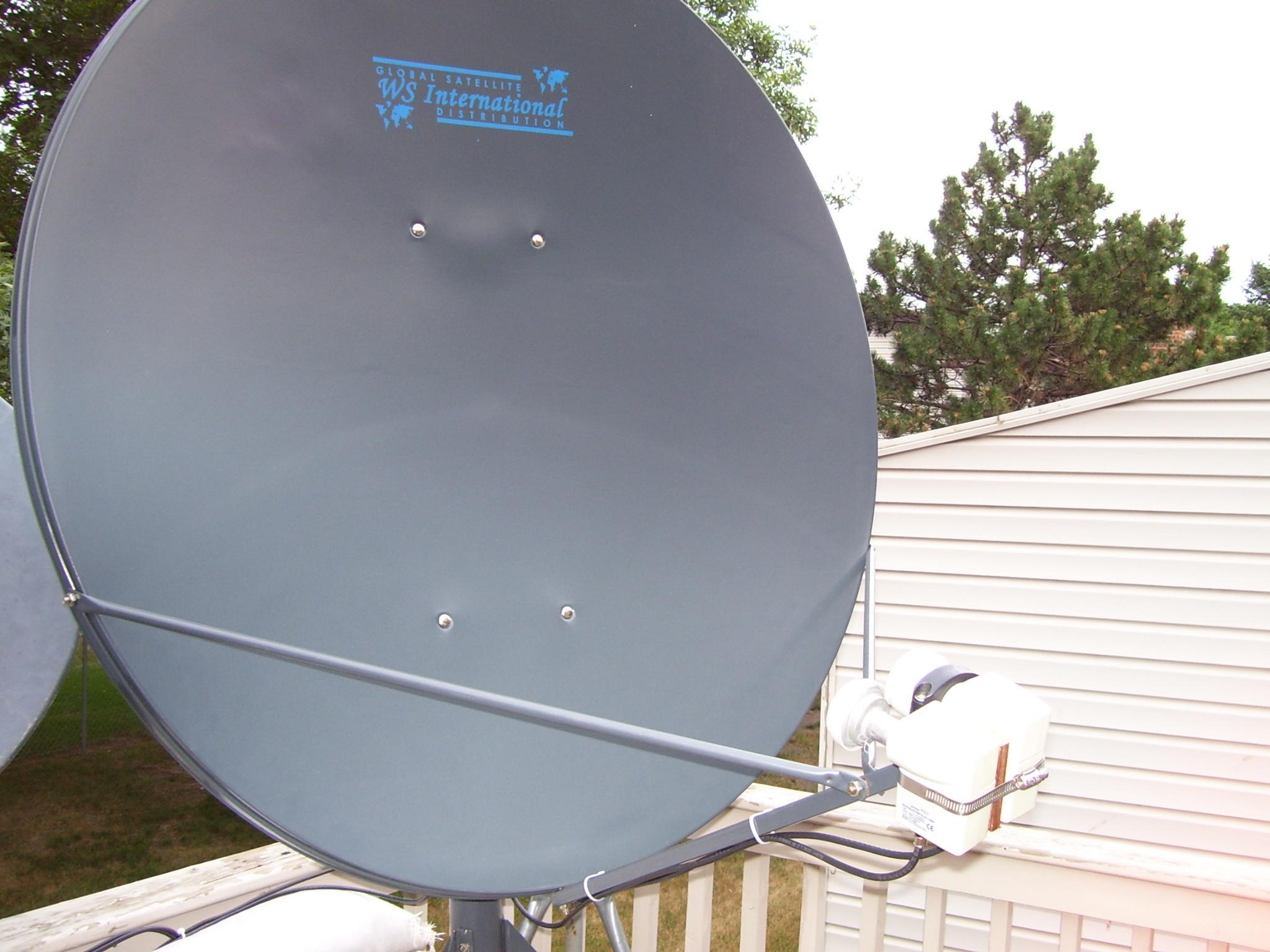

Here is my 1.2m dish (yes 4 feet) for Shaw when I had them set up (for 111.1 & 107.3). If you notice the LNB's are spaced apart than what the stock LNB is (the stock LNB they are actually "squished" together.
You could get a larger dish and put 82 at boresight (down the middle) and add 91 off to the side.
