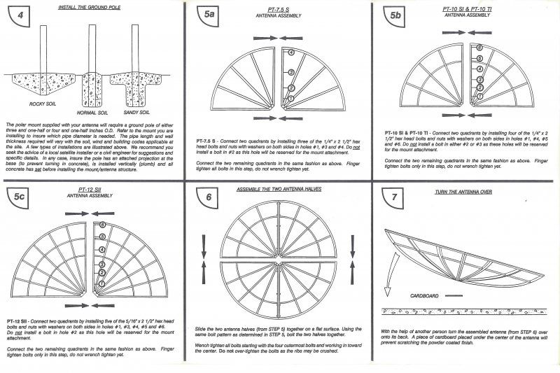

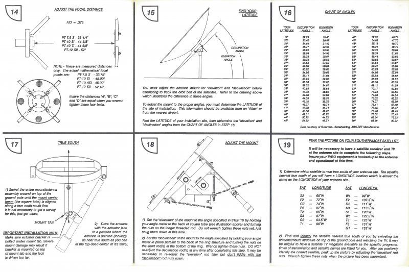

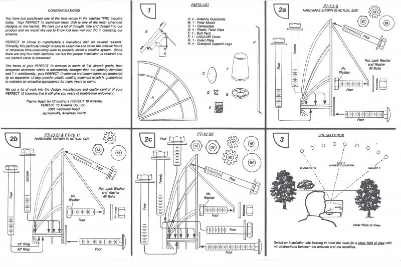

I believe LASER was made by Perfect 10. Here is the manual Perfect10 Sat dish assembly manual - page 1.jpg Perfect10 Sat dish assembly manual - page 2.jpg Perfect10 Sat dish assembly manual - page 3.jpg Perfect10 Sat dish assembly manual - page 4.jpg Perfect10 Sat dish assembly manual - page 5.jpg Perfect10 Sat dish assembly manual - page 6.jpg In Detail 9 it refers to a few Laser models

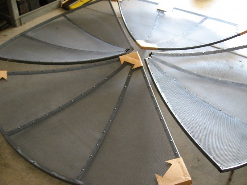

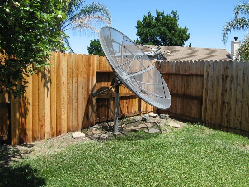

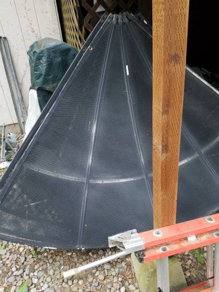

Glad to help. Believe it or not I have a never assembled 7.5 Laser still in it's shipping carton that I picked up from a very nice gentleman near Napa, CA. Before I could put it up a friend who lives about 2 miles from me gave me a 7 1/2 foot Wineguard. I put it up instead. Good luck with your dish. IMG_1281.JPG IMG_1290.JPG IMG_1255.JPG IMG_1254.JPG
