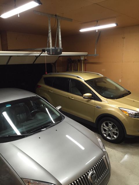

Edit: Well, I found something better than the Utilitech Pro fixture I put in 18 months ago. The same company has a hanging shop fixture with the same specs as the fixed luminaire I installed, but these hang on chains and plug in to the outlets the old hanging T12 fluorescent shop lights used. The best part is the BBS dropped the price so these were only $39.99 each, almost half of the price of the $70 fixed luminaire.
Here is the finished product:
BTW, the store I was in had the Sylvania LED T8 replacement bulbs at $24, but the sales associate said that they needed an Electronic ballast and wouldn't work with the older ballasts. Plus, the T12 bulbs wouldn't be in for 2-3 weeks. So, $48 for two bulbs and $30 for the e-ballast, and the $70 fixed LED looks very attractive in comparison. In my garage it was even harder to justify the extra cost.

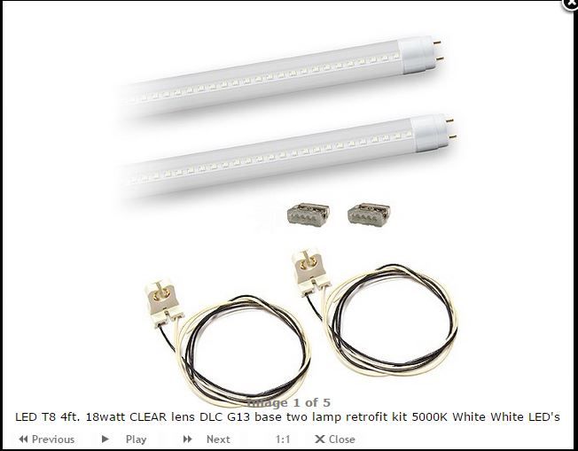

I've retrofitted at least a dozen standard 4' florescent fixtures with t12 bulbs. Bought my supplies from this site...http://www.totalbulklighting.com/led-lamps/t8-led-lamps.html
They have both kinds. I prefer the direct wired t8's bypassing the ballast, it's very easy to do. This company has been very good to work with and they take great care when packaging the bulbs. Never had anything damaged during transit.

How do I know if the ballasts in my present kitchen fixtures are capable of working with the "Direct Replacement" tubes? It sounds like those ballasts have to be a particular OR special type, that just any ballast might not work?
That's a good question and the very reason I prefer the direct wired t8 bulbs bypassing all that. The tombstones which are basically the lamp holders have to change out. Look at some of the retrofit kits they have. It's no different than wiring up a standard light fixture mounted to the ceiling.
Check out this screen shot I attached. With this you bypass everything. The line in wires up to the prewired tombstones. The bulbs are labeled showing which end is the power. The other end goes into your existing tombstone and is nothing more than a lamp holder.

You wouldn't believe how easy and quick it actually is. All your doing is removing the old bulbs, taking the "line in" loose from the ballast, swapping out the tombstones on 1 end, wiring them into the "line in" and installing the new bulbs. That's it. I did 8 of them in recessed fixtures after work 1 evening in a mom and pop store in about 1 1/2 hrs.
As far as changing out the fixture. I would go that route if it were a standard type hanging shop light. It's about the same cost as a retrofit. The biggest advantage of a retrofit is recessed fixtures, that 1 of kind fixture that your not going to find anymore and the decorative types. Just way easier to retrofit those.
Another thing I don't like about the direct replacement bulbs using the ballasts. Those things are nothing but big energy consuming transformers with little savings in energy. As far as a retrofit goes the direct powered bulbs is the way to go without a doubt.

Amazon has a cheaper price on the led tubes that require bypassing the ballast. The only thing they don't include is the wire connectors or wire for the tombstones. The wire however can be easily be salvaged from the ballasts.
