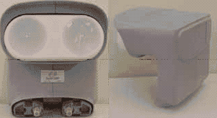

I've attached pictures of both, the first one is a Legacy Dual and the second one is a Twin Legacy. Tell us what you have.
I have the dual which is already connected to a sw21.
Then these are your options:
Get another Legacy Dual lnb and another SW21 and run two cables to the 322. You use the SW21 to combine 119 and 110.
Get a Dish Pro Plus Twin lnb and run a single cable to the 322. You can use the DP Separator.
Get a DP Twin lnb and run two cables to the 322 receiver.
Thanks Alot - I believe I will purchase a DP Plus Twin to avoid the 2 cables.
