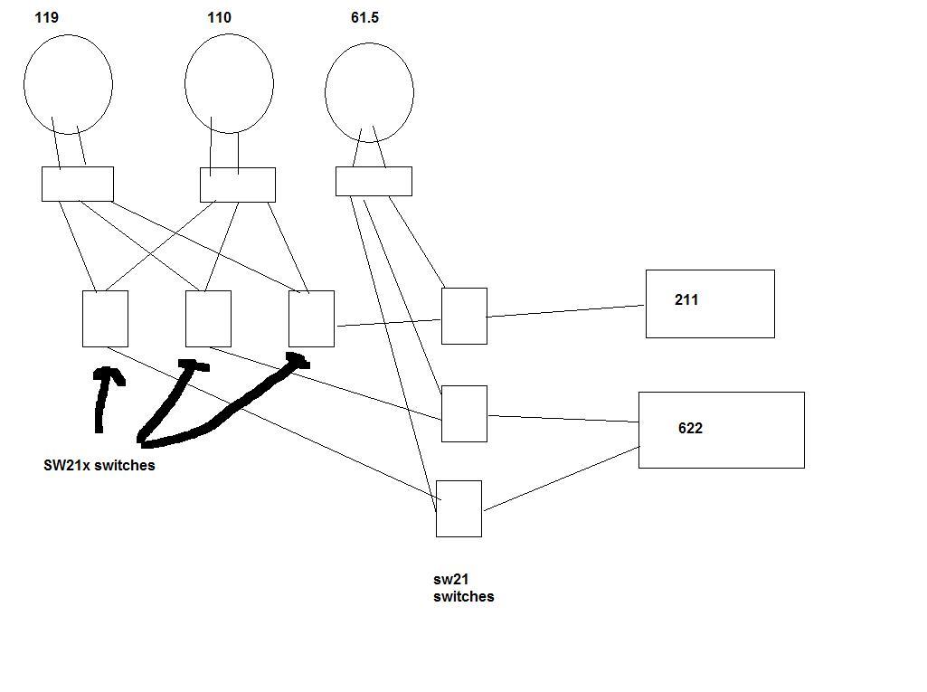

119 dish....both lines from LNB to a 3x4 multisiwtch
110 dish....both lines from LNB to a 3x4 multisiwtch
61.5 dish....both lines from LNB to a 3x4 multisiwtch
take the output from the 119 switch and put a SW21x on it.
take the output from the 110 switch and put it on the other port on the SW21x
take the output from the 61.5 switch into one side of a SW21
take the output from that SW21x above and put it in the other port on the SW21
SW21 to receiver
issue is you have to do this 3 times

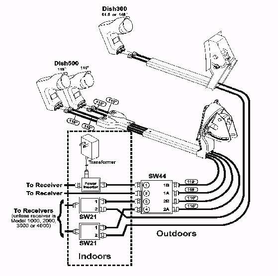

I was thinking he meant SW44 SW21 as the diagram from Dish shows:

you need 3 total (one from each LNB) and 3 SW21X (note the X....this is critical). You cannot link 2 SW21's in order. The fist one (closest to the LNB's) has to be a SW21X or that SW31 I linked above in post 13 which would replace the 6 switxches
I guess I will go with buying the 3 sw-21x and 1 3x4 if is tested to work. I will not test to see if the sw-31 works.
Thanks for all the help.
Hey Iceburg,
Today I installed everything and its working perfectly, thank you for your help. If I would have know this a year ago I would not have bought the 2 sw-64 that failed on me. Thank you again.
